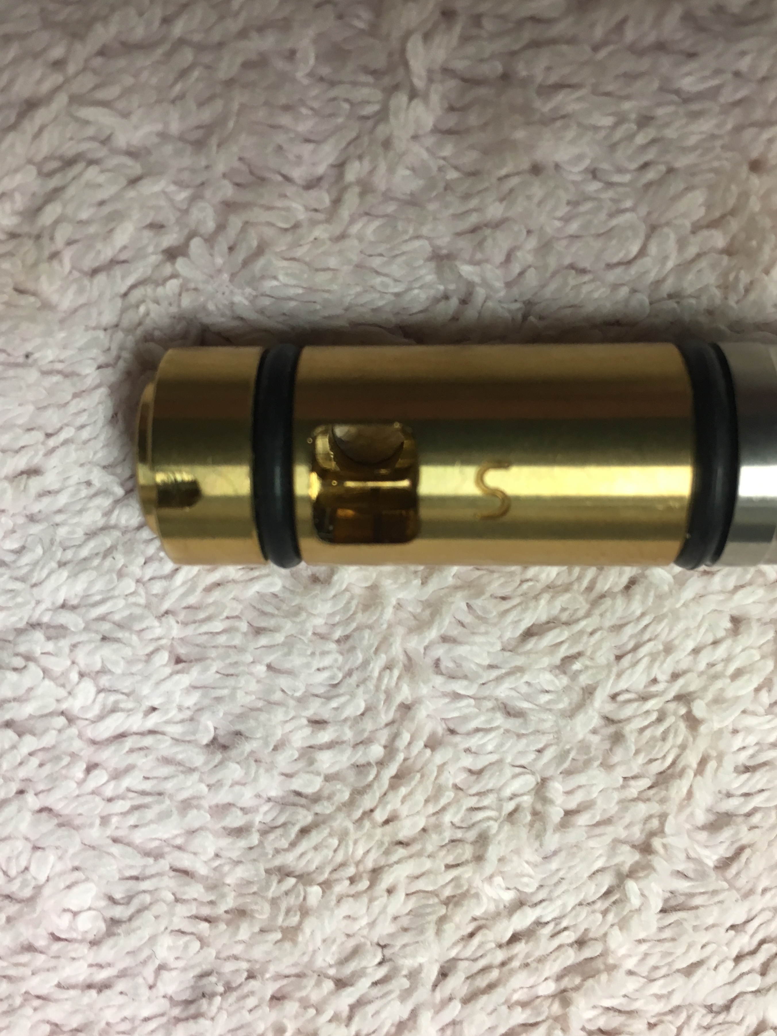

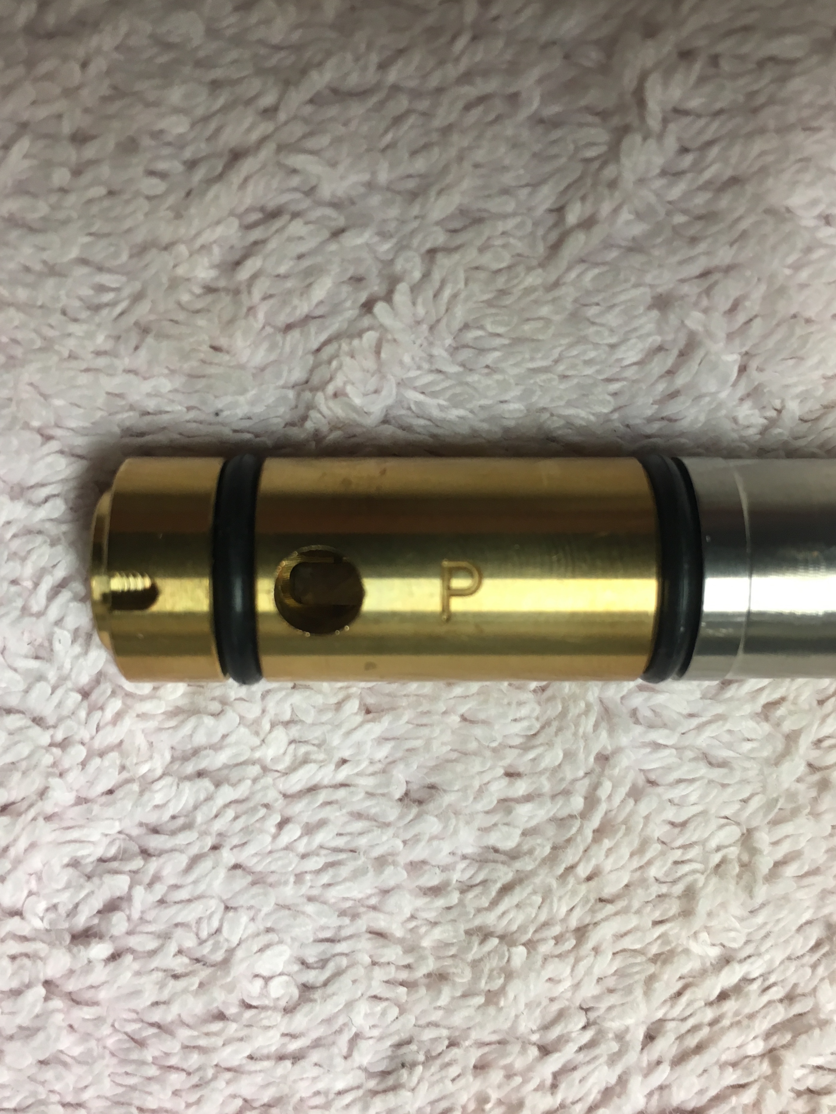

I have bought the FX crown continum MK2 last year, with 380mm and 700mm barrels, but on the end of barrel from the pellet probe side there is ( one hole on up side mark with P and and on down side 2 holes mark with S), what does it means
Plz guide me
The “S” stands for slug and the “P” stands for pellet. You orient the P or S depending on what you are shooting.
