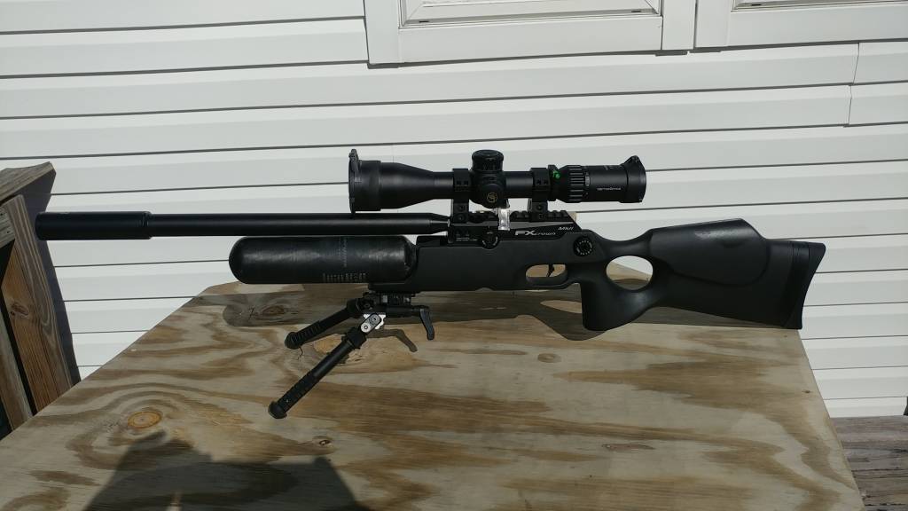

FX Crown MK2 w/ 380mm Superior STX in synthetic stock shooting .218 H&N 21g slugs @ 895 fps:
