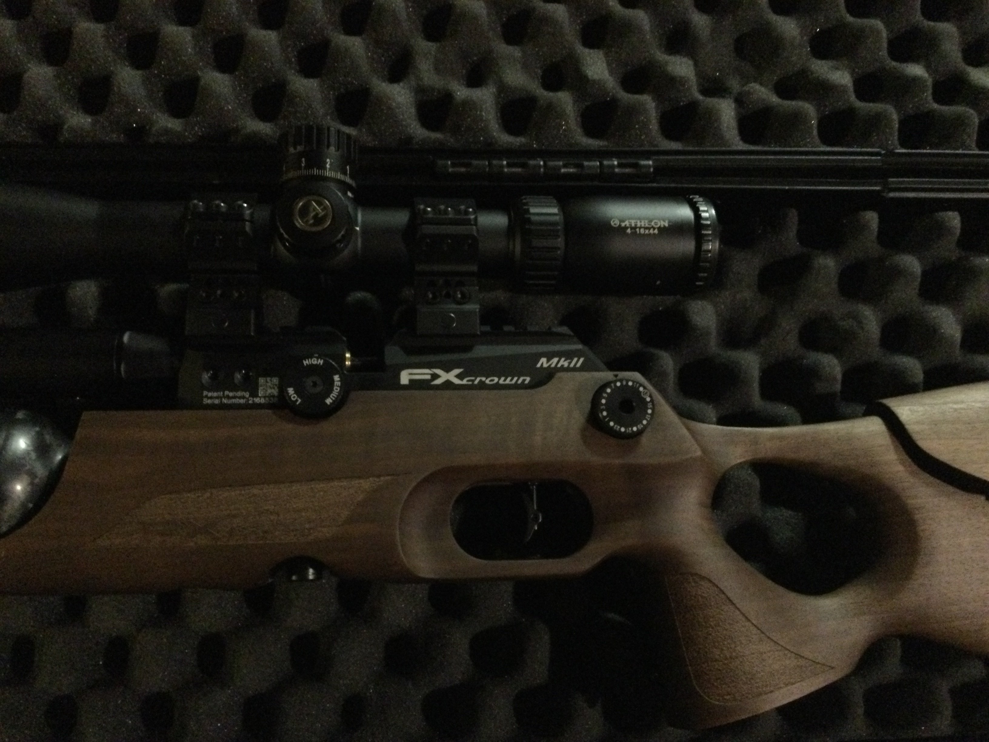

I am looking at buying a very good condition FX Crown Mk2. .22 The advert says Mk2 but I am a bit suspicious.
The engraving on the body does not say MK2. I believe it may be a "compact" version.
It has the black gauges and the later barrel removal screws on the side as opposed to the top and the picatinny rails.

crap photo, but a true mk2 will have it engraved on the action.

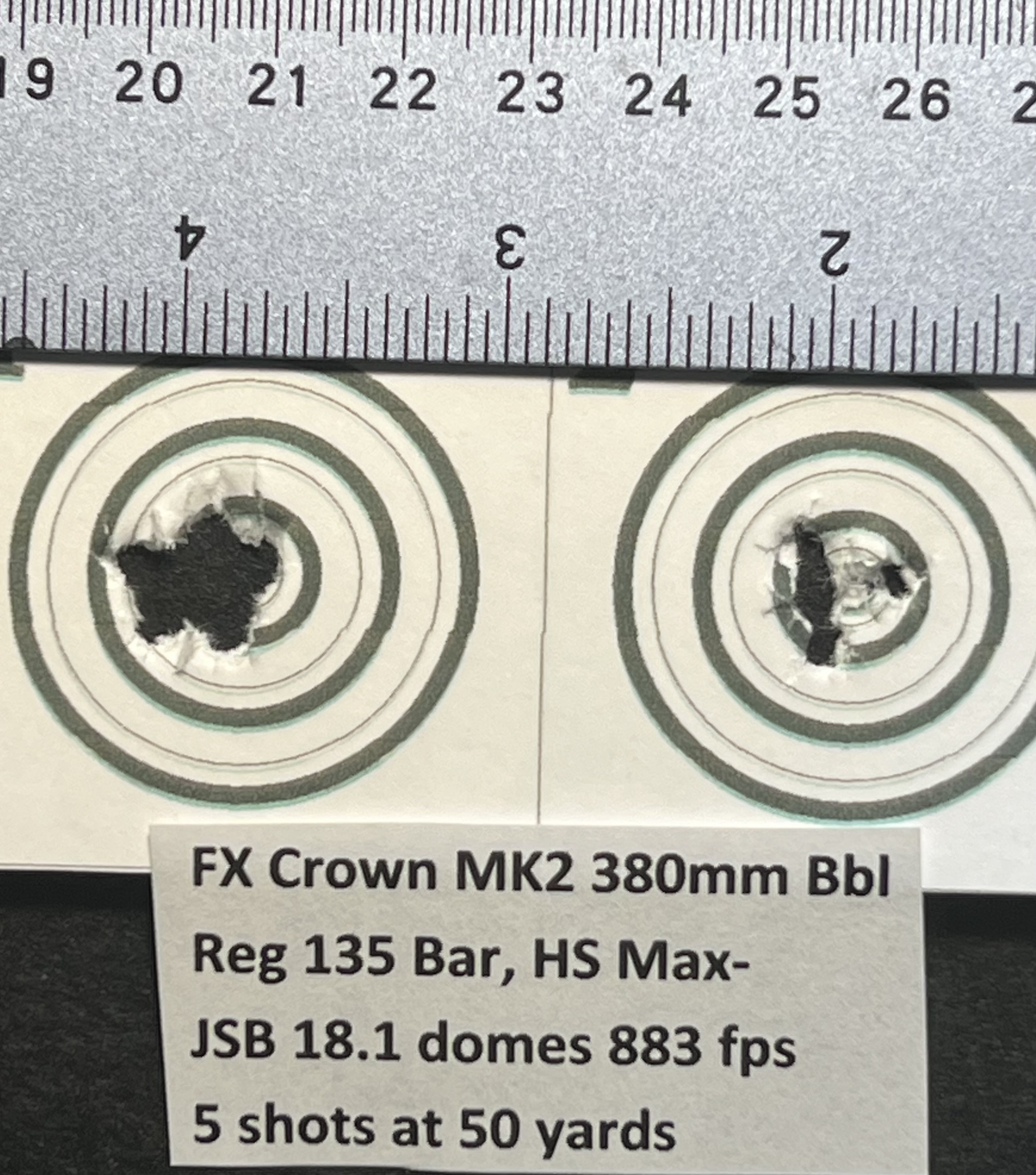

Mine came with a 600 mm barrel. I hated it because the gun was so long, so I bought and installed a 380 mm barrel. At one point, it was shooting 980 fps, so I tuned it down to improve the shot count and accuracy. It now shoots between 883 and 905 fps with JSB 18.1 gr pellets depending on the HS setting. This thing is a joy to shoot.
I've never seen a mk2 that didn't say mk2 on it. I have a gen 3 mk1 (as I understand it). For .22 cal, you really dont need much more. In fact I actually prefer the mk1 for .22 cal. .25 and up, mk2 is where it's at.
