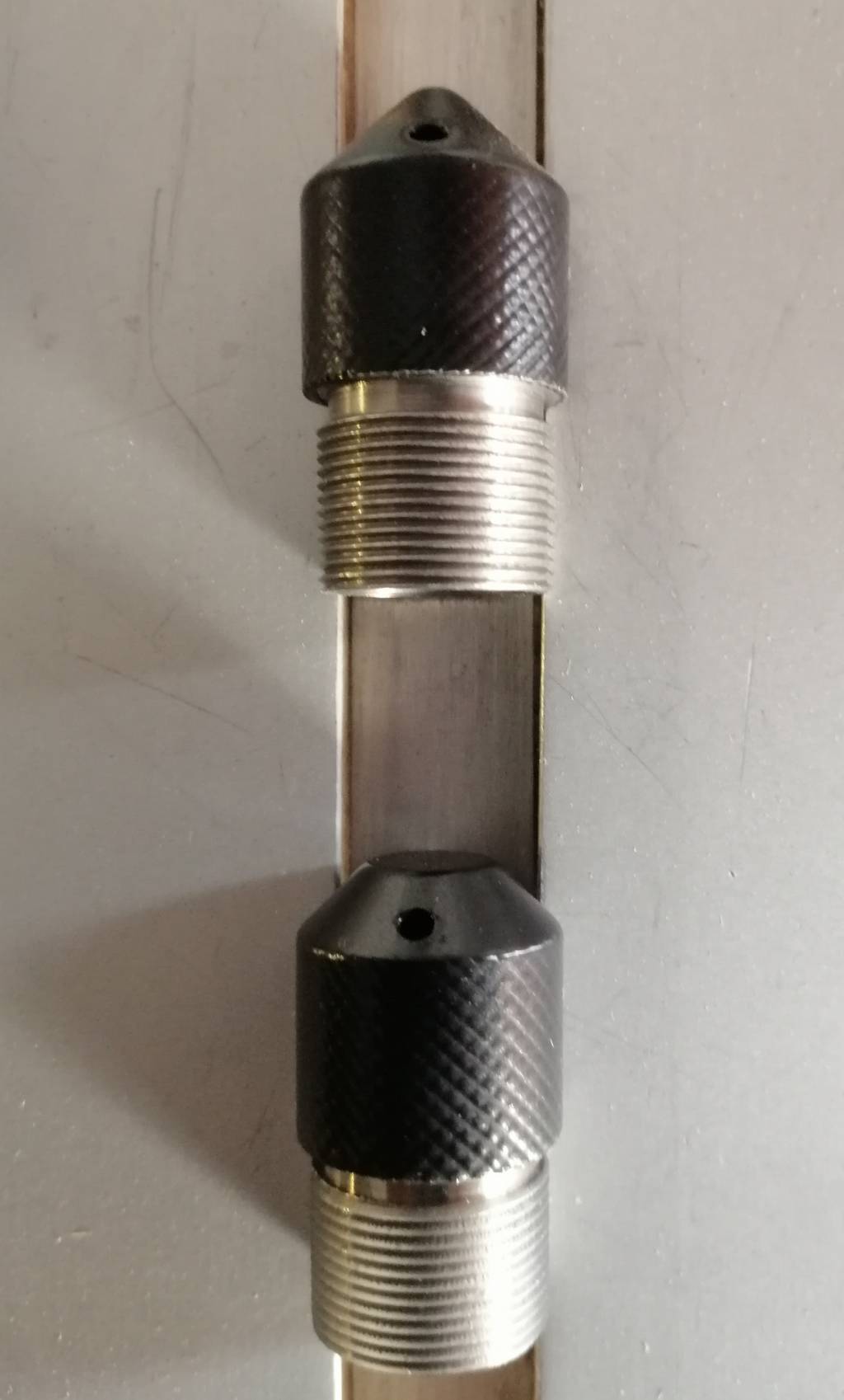

Rogvi lives on a small island in Denmark, you in Australia ..... I think the shipping would cost you a lot. I had 2 stainless steel plenums made by a turner, inspired by Rogvi's micro plenum, one with a slightly larger capacity (1 cubic centimeter) as it is 0.5 cm longer. On my crown, in. 25, the advantage was 3 / 4J, which added to all the changes you have already made, have brought me, with JSB from 2.2 grams, to about 75J. If you want to make a qualitative leap, you have to make larger plenums, like what a user from Croatia did .... A plenum of over 20 cc that is mounted in the needle / valve housing. Obviously, an extension for the tank must also be made. The work is not easy, but, if it succeeds, it gives excellent results.
Here are my 2 micro plenums. Any good turner is capable of doing this job.
