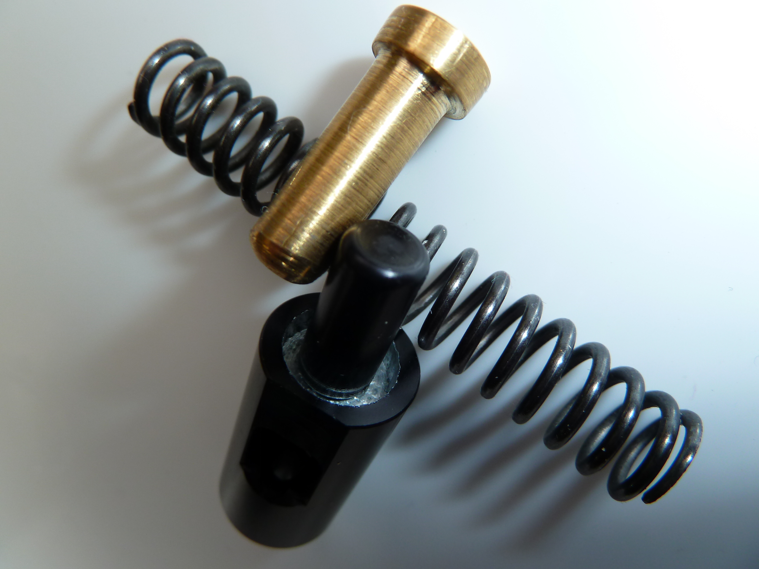

Assembled my own slug kit for Crown some time ago.
  • Homemade hammer weight
  • Customized hammer guide body, still containing a hammer spring stem guide while slightly milled in -providing 2,75mm depth for the spring to sit in-
  • Huma power hammer spring
  • Huma pin probe
The short brass hammer weight adds 6 grams. Together with a Huma spring (of a slight tiny bit higher power curve) that proves enough for me. I prefer a slighty more powerful spring on a long enough hammer travel. Never been a fan of clamping a factory hammer spring up to its maximum preload. When as such releasing their energy, such hammer springs are -in many situatons- more likely to behave a bit 'wilder' than is preferable. Not too keen on that.
Adding extra weight to the factory hammer, at the same time compressing the factory spring to max. preload while on top of that reducing travel length by a few millimeters (because of the head of the added hammer weigth), is about the best guarantee for a widening ES.

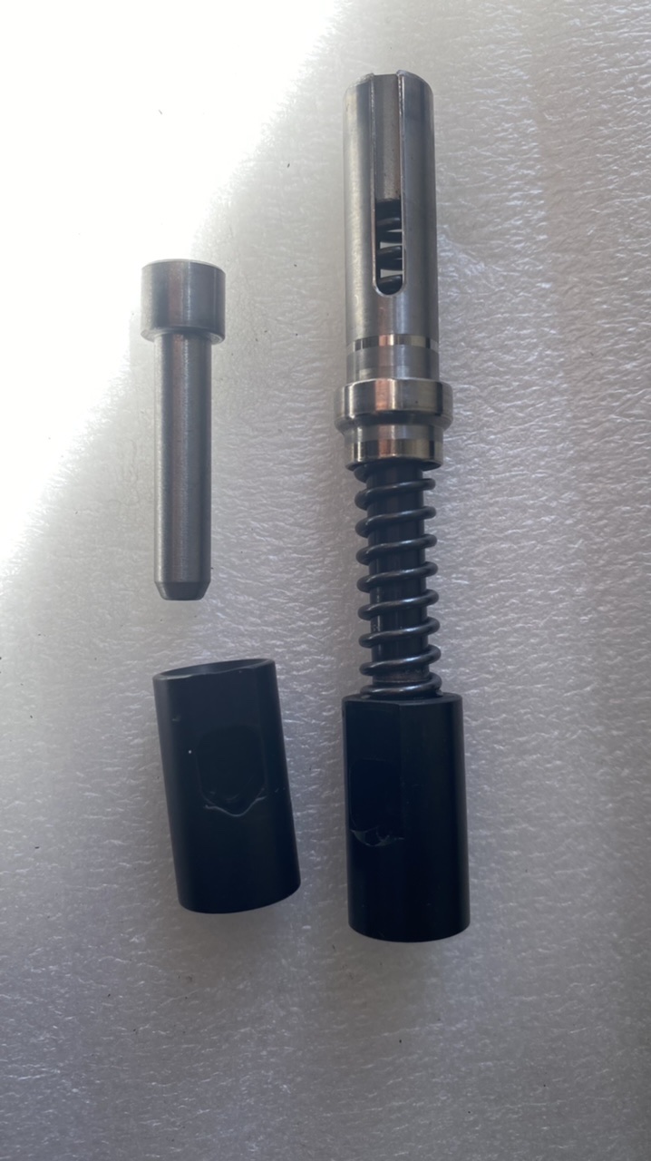

So I just installed mine and think maybe I did something wrong as the hammer has taken some damage.
Here’s what I’ve got:
So that’s on the surface that the sear engages.
On install I was concerned like qball about adding this much weight. So when even with the hammer adj screw backed all the way back except a couple threads and the adjuster on (1) I couldn’t get it dialed where I wanted in the low end I pulled it back out to maybe start trimming the weight off a little bit at a time to find the sweet spot I’m looking for and that when I found the damage on the hammer.
So as far as I can tell at least in my case is with the extra weight it’s maybe overdriving the valve and smashing into this guy on the cocking rod(?)
Anyone have any thoughts?
FYI, this is the FX kit weight @ .45oz (silver) vs the Huma tuning weights @ .45&.50oz (brass), the hammer is .55oz.
These are HIGHLY scientific measurements taken on my cheap kitchen scale.
My reg is just a hair below 150. I was considering chopping the small shouldered brass one down 1/4” or so at a time but now I’m not sure.
Really what I was hoping to accomplish is a lighter cocking action with same smack on valve, also a tune that would run the JSB 18s at around 875 on low PA/Med TP setting and 25s around 900 on high PA/TP with a 500mm barrel but that may be asking too much.
