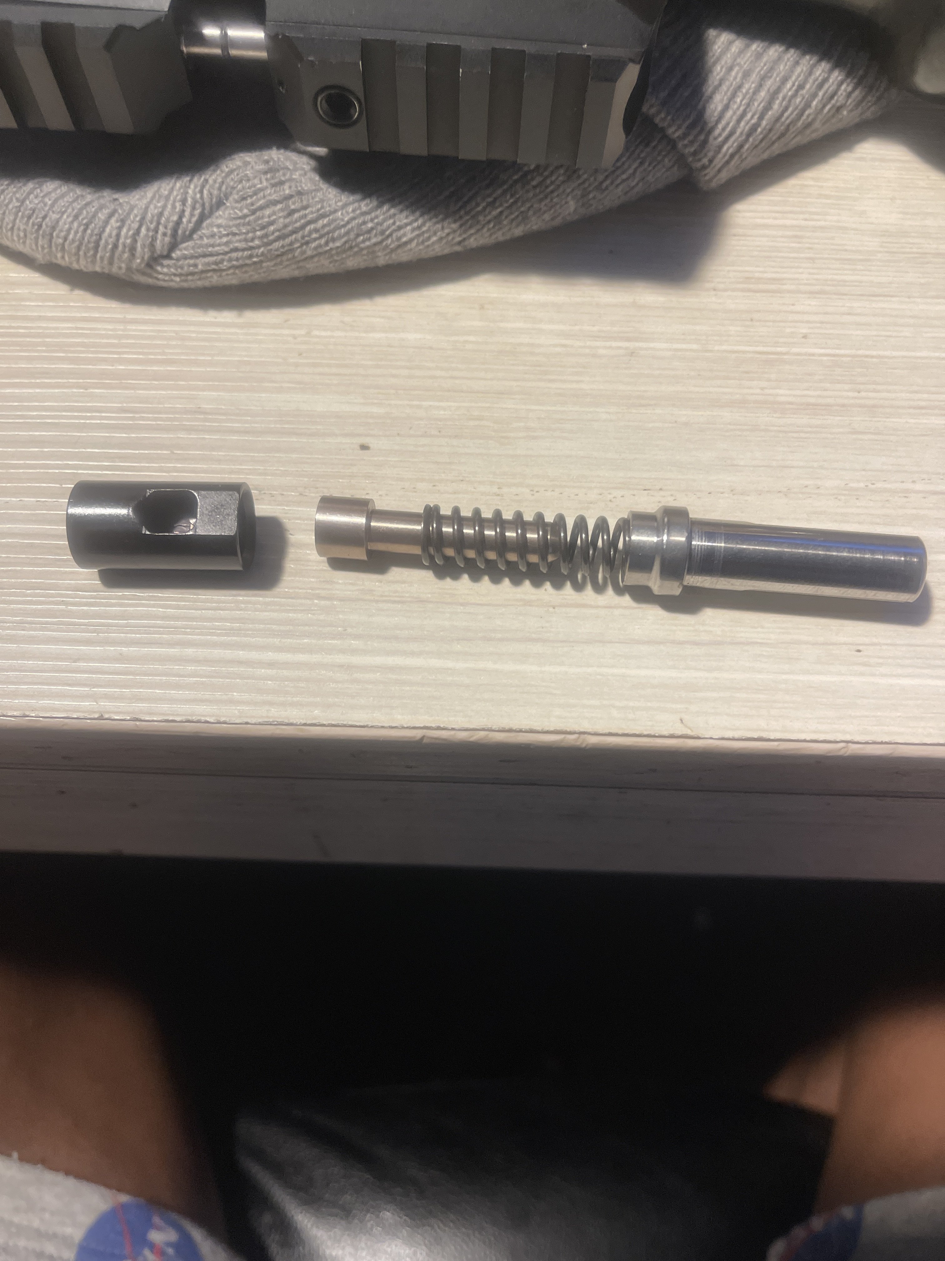

Is this the correct way that the additional hammer weight slides onto the factory hammer?Guess no one installed one? I could not even find a video of this kit so guess I’m one of the first???
Anyhow the installation is quite simple by following Ernest’s Crown disassembly/assembly videos. The ADDITIONAL hammer weight slides into the factory hammer and replace the rear spring guide/seat with the new one that does not have the spring guide but recessed spring seat. Replace the factory probe with pin probe and done!

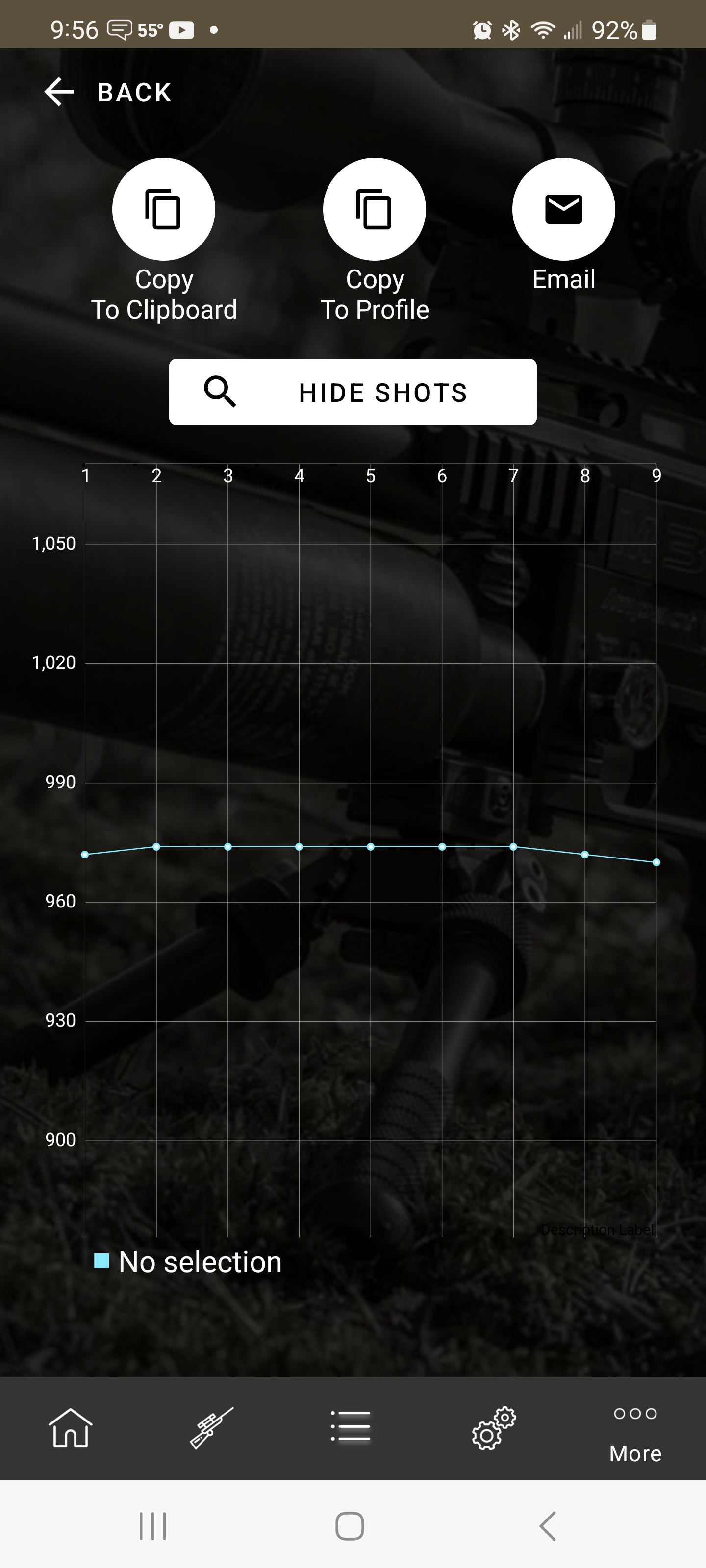

Tuned it and shot it yesterday, because of hammer weight almost doubled even with preload reduced by 3 revolutions the HS setting was only half way before the slug topped out on speed of 950fps and very soon after that over powering the valve and speed dropped. My worry of long dwell times didn’t really show up as I was able to easily find a setting to shoot 27.5 grain slugs at 940fps very consistently and accuracy. No issue reaching out to 200 yard gong and hit the 5 inch center reactive gong repeatedly. It’s actually bit faster than I would normally shoot out of a 600mm barrel but it’s shooting great so I left it.

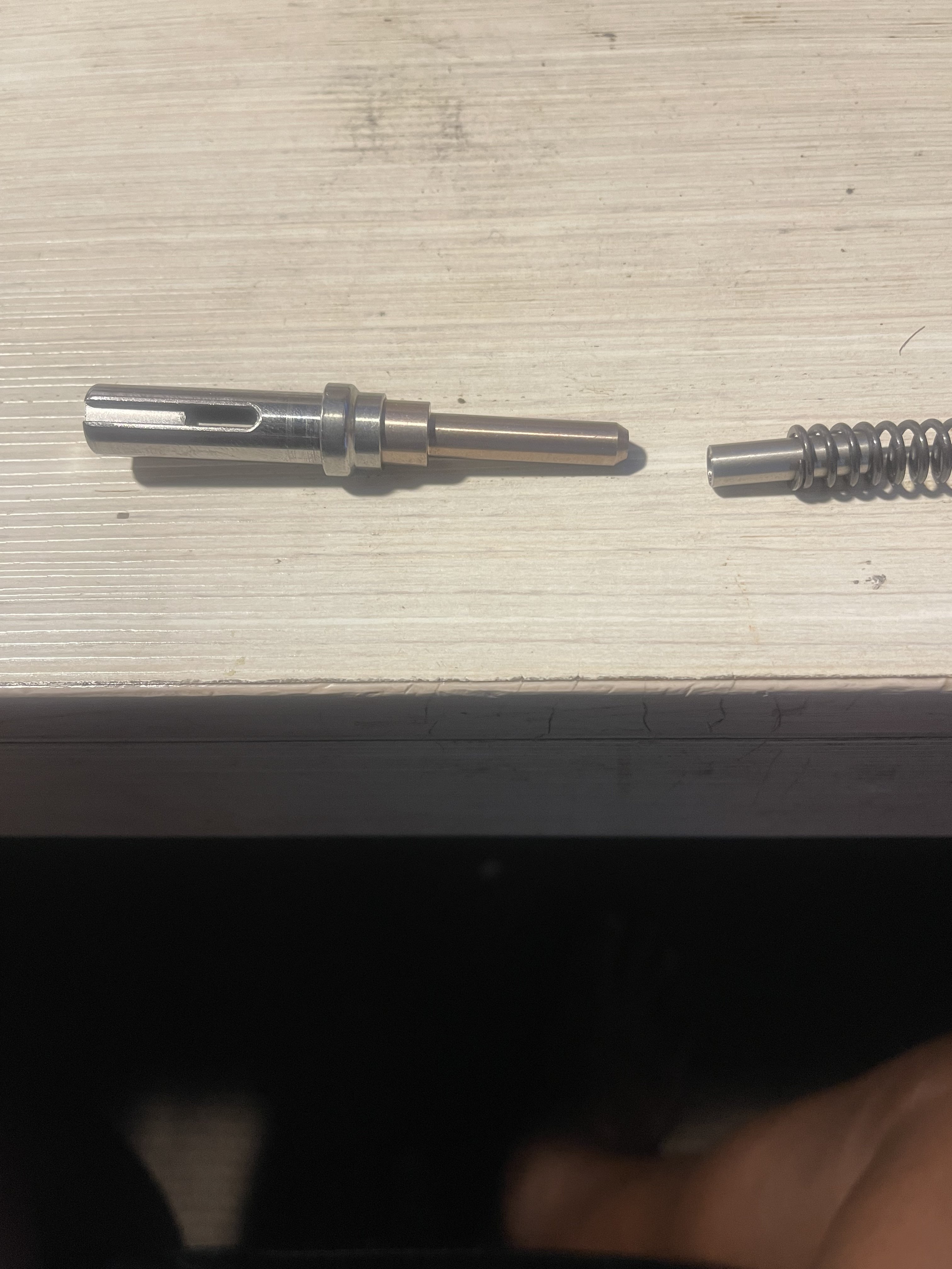

With the hammer weight attached like this it is very hard tension to push the spring back to install the hammer adjuster on. Should it be this much tension or am I placing the hammer weight wrong ?Is this the correct way that the additional hammer weight slides onto the factory hammer?
Or is this the correct way to attach the hammer weight?With the hammer weight attached like this it is very hard tension to push the spring back to install the hammer adjuster on. Should it be this much tension or am I placing the hammer weight wrong ?
Bringing this back up as I just got the FX slug power kit along with a .25 cal 380mm barrel for my Crown. The Hammer weight wouldn’t fit in the hammer so the spring was out a lot further like was happening above, spring should be floating when you install the end cap. Seems like the hammer weight was just a little to tight so I chucked on my drill and ran it while holding 220 grit sandpaper on it until it would slide in then polished with 2000, worked fine after that.With the hammer weight attached like this it is very hard tension to push the spring back to install the hammer adjuster on. Should it be this much tension or am I placing the hammer weight wrong ?

Maybe the Hammer gets compressed after lots of shots? Seemed like it was maybe thousands of an inch to tight. Not sure why it wouldn’t fit but this is on a MK1 Crown, hopefully this will help someone else searching for info.

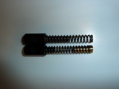

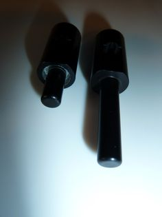

In recent 2 years have been extensively testing (in my .22 Crown II) 4 different hammer springs combined with some 8 homemade hammer weights varying from 4,5 grams up to 11,75 grams, some in RVS, some in brass; with varying lenghts of the hammer weight bodies as well as varying head hights of the respective weights. Also that latter aspect is a more important factor than one might suspect, at the moment one goes 'breaking into' the Crown's subtle factory balance and the purpose it was intended and designed for : great HP accuracy on a limited plenum, at the same time each shot with high air efficiency .
Today here using a mere 6 gram hammer weight added to the 16 gram factory hammer. The spring used to ‘drive’ this total of 22 gr hammer weight has about a good 10% higher powercurve than the FX 11500 factory spring. This somewhat stiffer spring releases its preloaded energy a fraction of a second faster than the FX 11500 spring, subsequently also returning to ‘resting position’ a tiny bit faster.
This so called 'power spring' is 'sitting' in a 2,75 mm deep seat, milled out in one of the modified spare hammer spring guides I had bought to experiment on. (see earlier post). I have tried several modified models of FX factory hammer spring guides, both with (shortened) hammer spring stem and without stem. Those spring guide blocks with entirely cut of stems always came out of the tests with poorer results, both in terms of shots per fil, as to ES numbers over larger shot strings, hence also in accuracy (over longer strings).
Here ’s why I ‘m today surprised at reading that .22 Crown shooters are apparently using the rather ‘brutal' power kit with a massive 13gr extra hammer weight on top of a 11500 factory spring, sitting on a hammer spring guide body with its stem completely cut of, while at the same time eating away some of the hammer’s travel length due to the large head hight of the used hammer weight :
From the testing I ve done, this sort of configuration proves itself more of a disadvantage than anything else, when shooting .22 in up to 30 grains.

View attachment 387152 View attachment 387153
Now THIS is the post I’ve been looking for since the end of last year!!!!!
FANTASTIC information, thank you. This para “Even at a mere 130 bar regulator” is exactly what I’ve been trying to do. I will have to go through it a few more times in order to, hopefully, work out exactly what I will have to get to make this a reality.
From what I can understand, the pic with the brass hammer are the things you changed, correct?

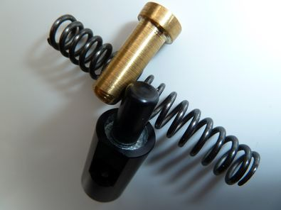

This next one is a tune I ‘stumbled upon’ when receiving my MK2 straight from the factory :
• As said, regulator set at a mere 95 bar;
• 600 mm superlight (with a standard superior);
• No extra hammer weight (just plain factory hammer);
• Non-customized, standard factory spring guide;
• Factory hammer spring (no 11500);
• Shuttle screw only 1,9 mm turned out;
• And an added FX spacer ring no 20136 under the hammer spring; (yes indeed, straight from the factory)
This is the spacer i m talking about :
When the dealer handed over my MKII , I opened the case to inspect the gun (right there and then in the shop), and found a small FX note inside reading “HP” followed by some other scribbling I couldn’t decipher, and neither could the dealer. When subsequently looking at the reg mano I was immensely surprised at seeing it displaying but 95 bar. I went like “what’s this then? HP on just 95 bar?” Couldn’t make much of it so the first thing I did when reaching home, was loading up a magazine with 18 gr JSB’s.
The chrony values at that point really surprised me. With the power wheel fully open, the 18 grains went to 293-295 m/s (that's about 960-965 fps).
However, that snappy bark coming out of it at that point, was just a bit too shrill. Valve not closing fast enough. After turning down the power wheel, velocity settled at some 282-283 m/s (that ‘s about 925-930 fps), delivering great bullseye accuracy at 70 m target distance (that’s about 75 yards).
