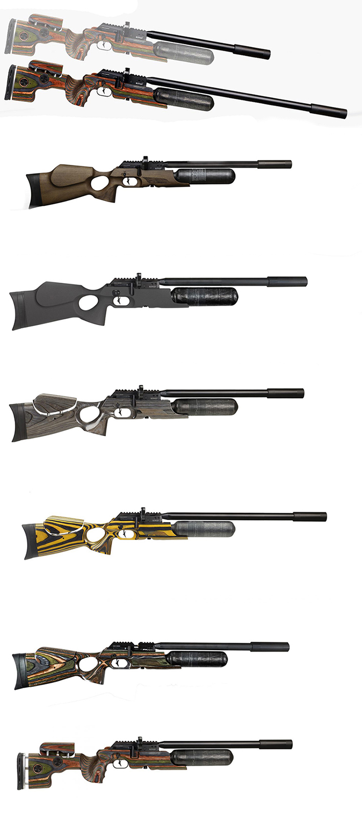

Top: 500mm, 700mm GRS I believe, Yellow jacket stock ( 5th down) will be discontinued soon, I agree with others, that the crown in walnut are getting more bland in wood grain

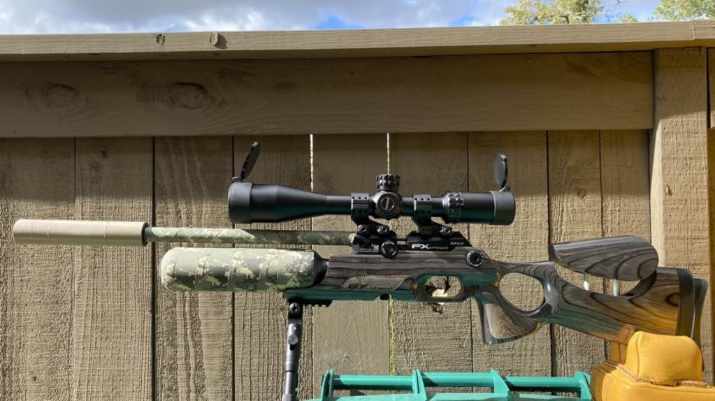

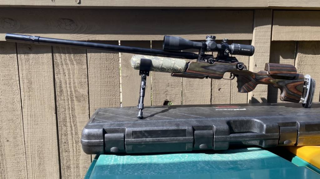

I have one in GRS stock and one in Pepper Laminate. I have 300/380, 500 and 600 barrels for them, I stopped at 700 though LOL! For walking in the woods/my backyard the 380 is phenomenal! 500mm is ok for walking around with it but I do feel the length and 600mm is really for the bench, the 700mm is.......unfair advantage because you are practically at point blank range. Handy if you fix a bayonet to the moderator so you can just stable whatever you are shooting at if you happen to miss at point blank range.
Obviously the barrel length dictates max speed and power, for pellets the 380 is plenty IMHO, 380mm .25 barrel shoots pellets right at 800 fps and with JSB heavy can definitely get MOA at 100 yards on a good day, I've done it on a dreamline compact. The interesting part is you can get 300mm .22 superior barrel to shoot 20-23 grain NSA slugs at 760fps and it's damn good at 100 yards. Never tried slugs in the new superior and heavy liner in .25 380mm barrel, slinging .25 slugs at 800fps could be amazing!
Feel wise the GRS beats the Laminate by a little, it's better because adjustable length of pull and the 6 degree offset grip feels awesome. The laminate is fantastic in it's own right, love the thumb hole setup and one of the best ambidextrous stock I've tried on airgun or PB. The Synthetic stock is quite a bit lighter and obviously more durable so if you out hunt a lot and rough on your guns then it's a great choice. The laminate stocks have a distinct advantage of extra weight in rear of the stock which makes off hand shooting feel easier thanks to the awesome balance especially with the superlite barrel, the balance is simply outstanding! GRS comes in close second in the balance department but the offset grip and adjustable LOP balance it out over all, hard to decide which one I like better. For the bench the GRS to me is the best out of the bunch hands down. I wish they add some weight to rear of the synthetic stock to make it feel the same across the board, it also lacks adjustable comb or cheek piece which is quit necessary unless you have really tall cheek bone. Never had a walnut stock.

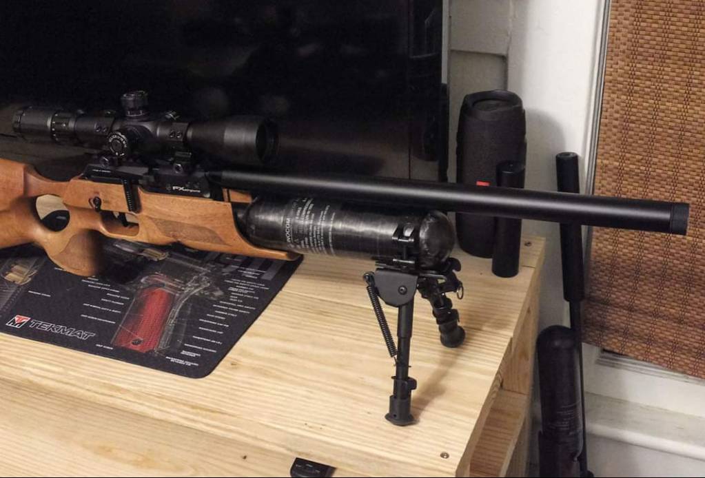

Hardest part for me is where to mount a bipod rail. Don’t like idea of drilling into the laminate stock but don’t like idea of mounting far out on the bottle either.
One of the many reasons I like the Saber chassis. I personally don’t think the clamps on the bottle hurt. I had one on a Red Wolf and never had issues. Many other people use them too, with very few complaints. It helps a lot getting that bipod out front more.
