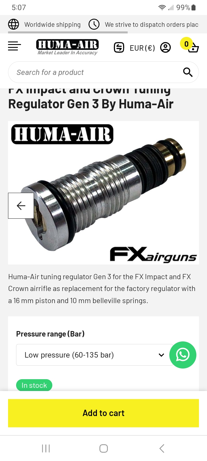

Hey, if everything else isn't enough, Huma has a low pressure range regulator. I don't know which one would fit your specific Crown (gen 2 or gen 3 most likely).
From my experience, you have to remove the current regulator and measure it to know.
This the link for the Gen 3
Reactions: dgeesaman
