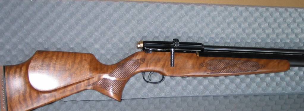

Great gun of the classic design with free floating barrel that never changes POI, you can ad a barrel support between air tube and barrel, have tried that but it do not ad to accuracy at all
All made with Walther choked Match barrels, very accurate, trigger brake like glass, one of the very first made with side lever action, very fast reload, 3 step power selector
Downsides: tiny parts, kind of delicate to work on but at least not a problem for me
Love it!

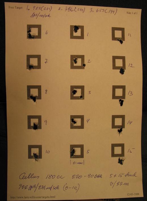

Here's a target shot with the Cutlas, I own both, exactly the same action as the Cyclone
I fill 220 down to 80 bar, power setting 1, 2 and 3, 5 shot in each group total 75 shot, distance 22m/24.5 yards

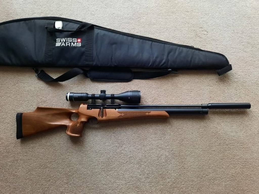

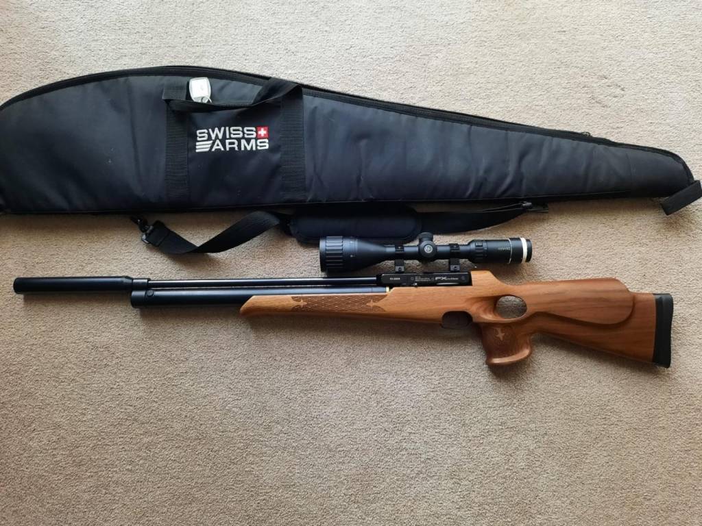

Hi, FX Cyclone in .22 calibre thumbhole stock, beautiful wood and chequering, thinking of fitting a Lane regulator for consistant shot accuracy.
That's a beautiful Cyclone! - Altaros also sell a reg. for the Cyclone/Cutlas
https://www.altaros.cz/en/fx-airguns/65-5644-fx-cyclone-airgun-regulator.html#/62-awpdetails-
...but personally I enjoy and trust the first shot precision of a non regulated PCP

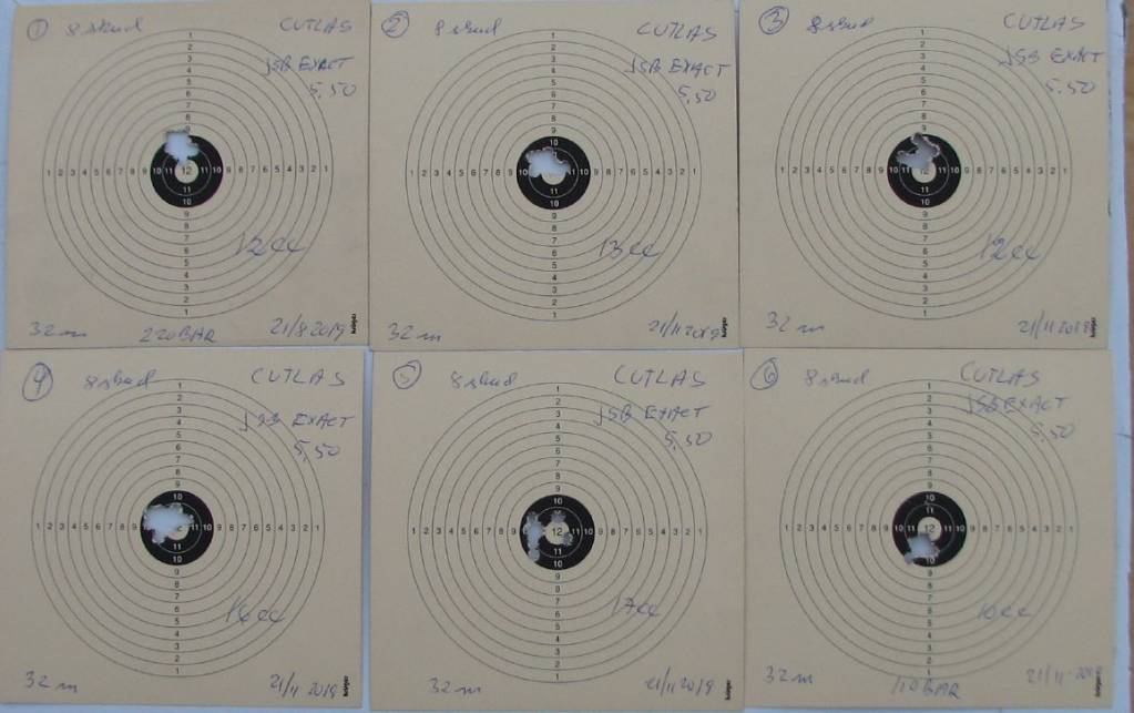

Here's so targets shot with my Cutlas, same action as the cyclone
Fx Cutlas (Cyclone) 48 shots, 1 mag = 8 shot each target, 32m-35y, 220 to 110 bar:

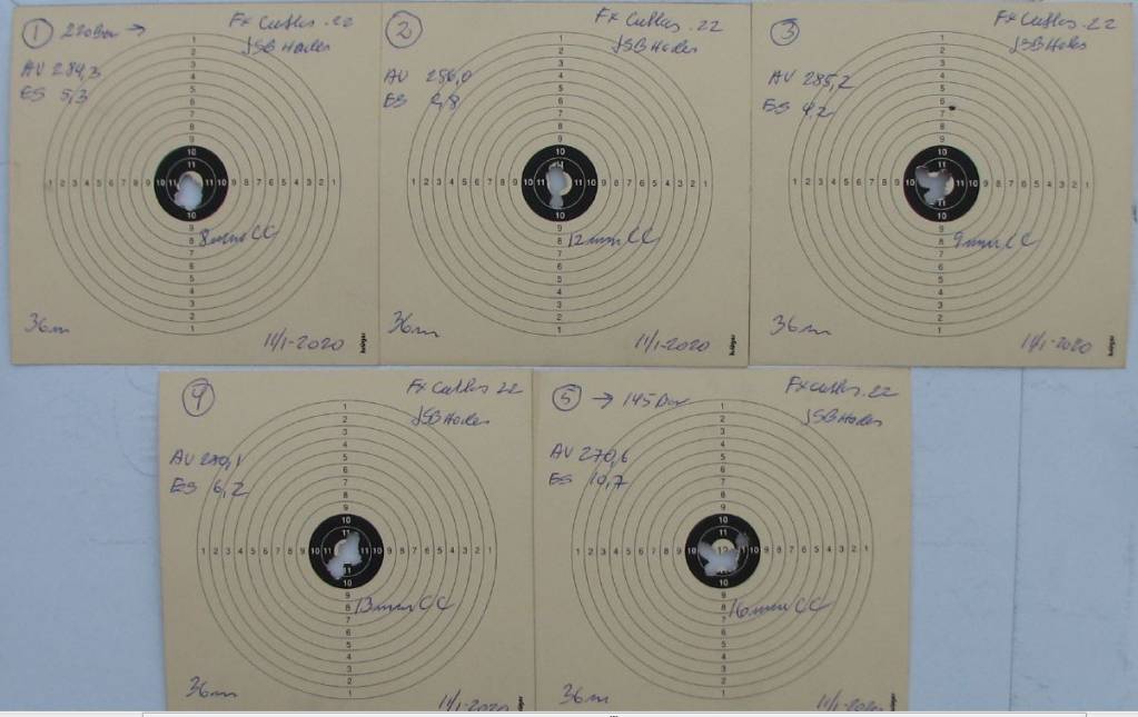

Fx Cutlas (Cyclone) 40 shots, 1 mag = 8 shot each target, 36m-39y, 220 to 145 bar:

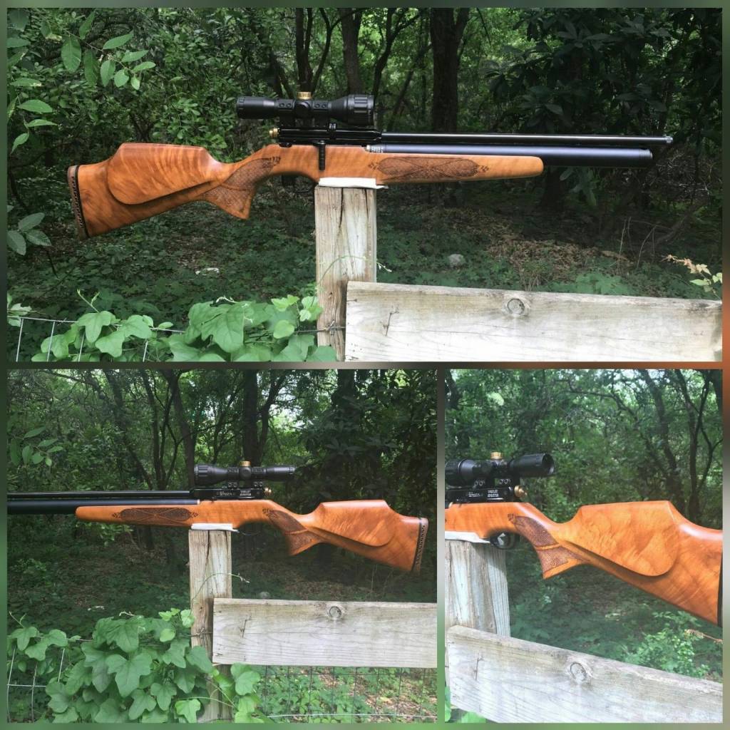

Great guns and the easiest of the FX2000 based action actions to work on IMO because you can remove the cylinder. Ive got the Webley branded version the Spectre. It's well balanced and easy to carry. The points other posters made are all spot on. I don't play much with the power adjustor because I had to replace once, I just leave it on one setting.
