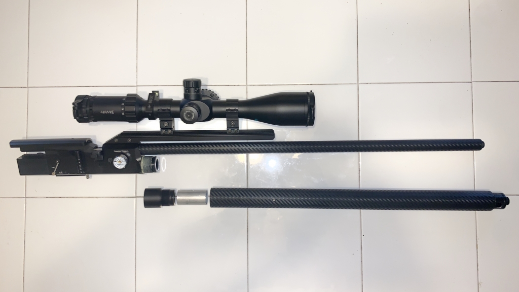

My dreamline .25 with the human reg and the original Huma plen extension ( not the fx one or the xl huma one) spits the 34gr jsb at 860fps at 130bar on the regulator. If I shim the hammer spring another 1mm I can get 890fps, but the string starts to vary widely at that point, swinging by up to 60fps (yes, some 820 shots in there...) But at 1mm shim, I get 7fps spread and a SD of less than 2. Raising the regulator didn't do much for the fps.
I do have the fx plenum extension on the way too. Hoping to get a stable string at 900fps with it.
