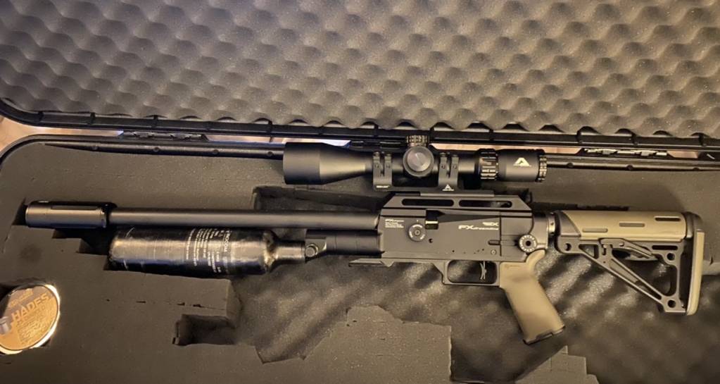

Hey guys, I traded for an FX Dream Tac compact .25 recently, that has had a lot of upgrades to it. It’s got a power plenum added, along with a 480 bottle.
I was told that it was tuned to shoot kings @750 FPS, but it’s only shooting about 640. The crazy thing is that the reg looks to be set at about 160 bar. I know these short barrels aren’t as efficient, but I was thinking that it should be making more power with the reg turned up that high? It’s got wika gauges on it, but wondering if the gauge might be off? Anything else I need to look for that might be reducing power? It has the standard probe and transfer port. What’s the Max to run the stock reg up to? I was kind of thinking about ordering a huma reg for it anyway, but was hoping to figure it out first.
Thanks for any advice.

Based on your last pic, it looks like you're shooting 26.4gr Hades. What velocities are you trying to achieve? My stock Dream-Tac compact in .25 shoots the Hades at a consistent 833 fps. Which port are you using on the barrel? Have you checked the barrel o-ring? I don't think those power plenums are doing anything for you, see what you get after you take them off.

To answer the last set of questions there, I was shooting it in .25 caliber with jsb 25.4 kings. It was shooting about 760 FPS. As I said earlier, I get higher fps with the transfer port set to medium than on high with the .25 barrel in. It has the normal transfer port on the barrel and not a high flow.
