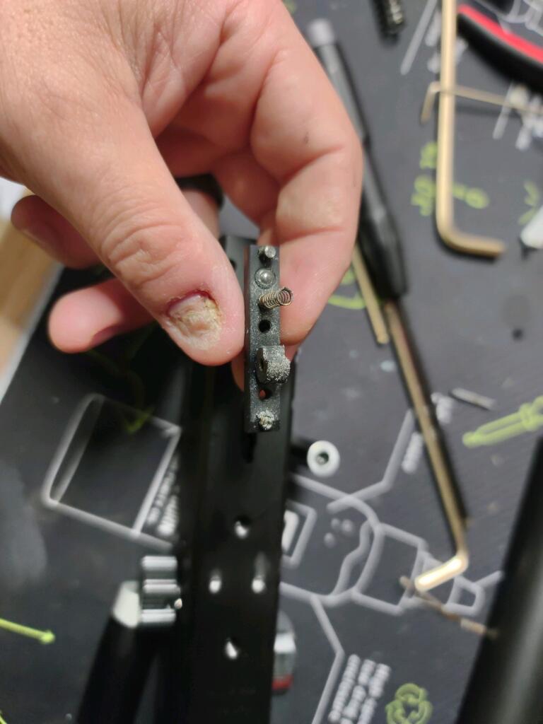

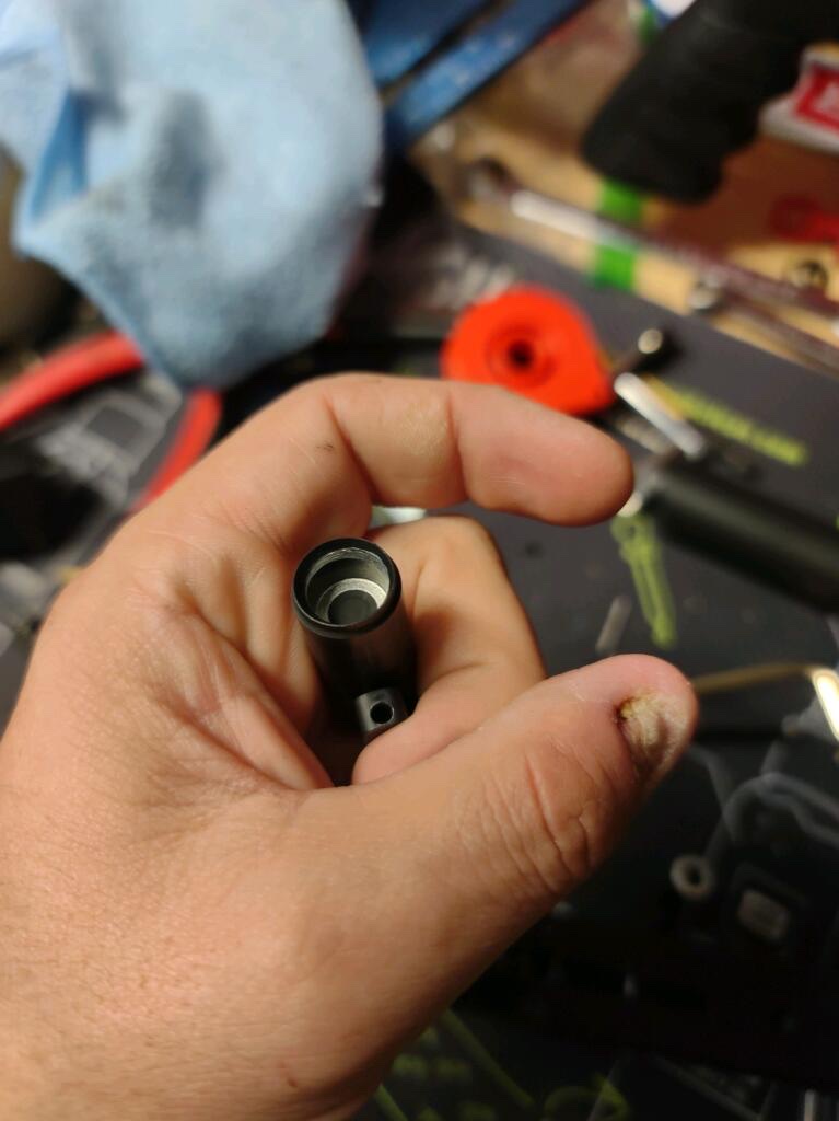

Ok, so just an update on my Dream-Tac. I stopped by Izzy’s house the other night and dropped it off for him to take a look. I couldn’t get the hammer to make any real changes when I was trying to adjust it.
The problem ended up being that the hammer spring was eating away at the inside of the tube it’s in and not maintaining any kind of proper tension. If you look at the pics you can see the metal shavings it was making inside.
It is now shimmed and the spring was replaced with a slightly heavier spring. Velocity is holding right around 900 fps with .25 kings and the 380mm barrel, with the reg set at 140 bar.
I’m calling this one fixed, since I can at least start tuning it and see some different results. I haven’t tried it with the .30 caliber barrel yet but I plan to later this week. I just picked it back up tonight.
So, just some thoughts I’m having at the moment and some info in case someone else is searching to solve a problem they develop:
Has anyone else had this happen to their Dreamline? I have trouble thinking it hasn’t. Anyone else seen it before? Steel washers went in to shim it and stop it from eating any more of the aluminum. I was wondering if it was tinkered with before and maybe wasn’t put back together properly? I guess I could take my other Dream-Tac apart and compare them. (Yeah, I bought another Dream-Tac last week from one of the Central Florida Airgunner Club members.)
There was a mess of metal shavings inside from the spring eating at the aluminum. One end of the spring was kind of sharp, but I’m not sure if that was enough to cause the problem? I had barely shot it after trading for it, so did someone shoot this thing a million times or what? I’m at least the 3rd owner, so really no reliable info on it to go by.
I asked Izzy to weigh the hammer for me and it was 11.53 grams. I read in another thread that the .177 and .22 Dreamlines can come with a light hammer weighing 7 grams and I was wondering if maybe mine had that one installed. Obviously it was the spring causing the problem and not the hammer. There is a 13 gram hammer available as well. Izzy put a little stiffer spring in mine and you can feel the slight difference in it when you draw the cocking handle back.
