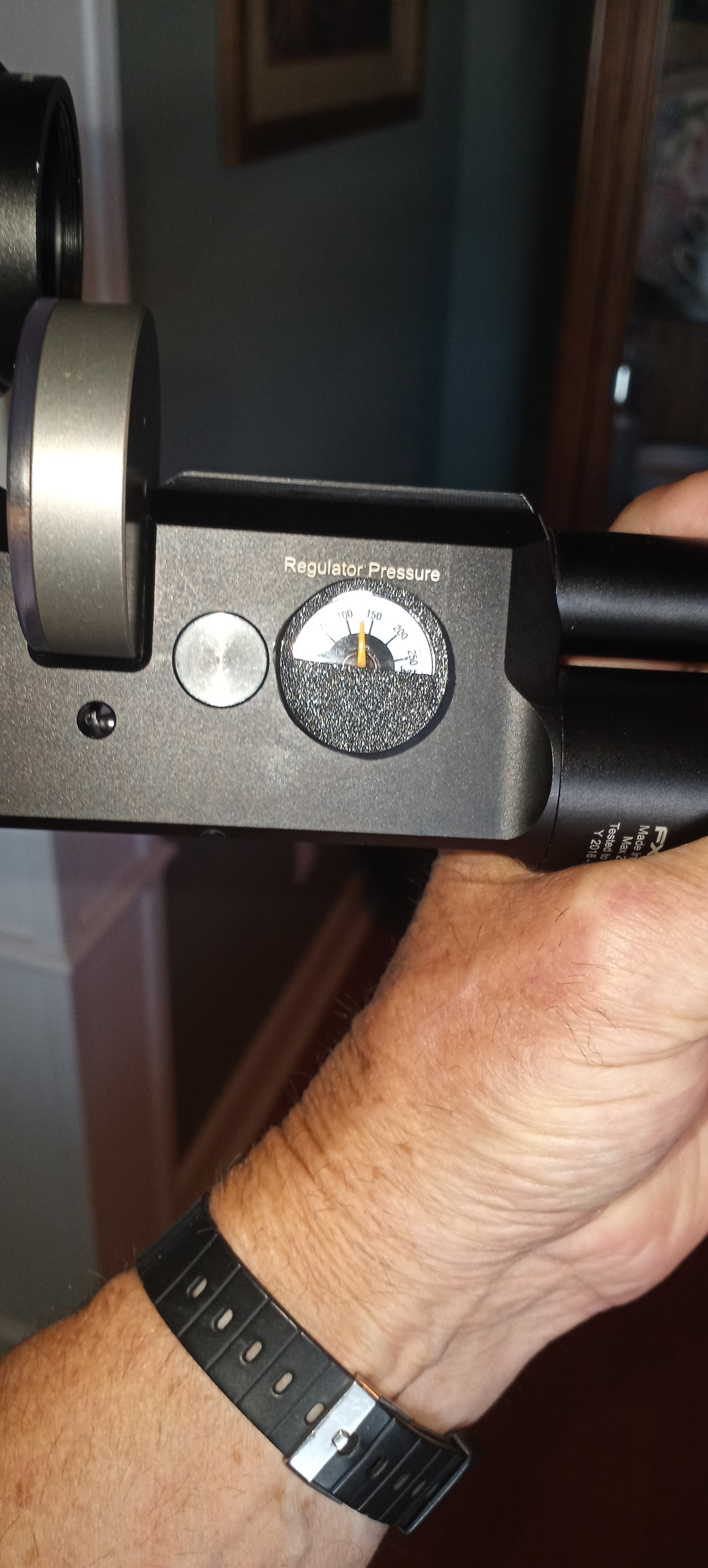

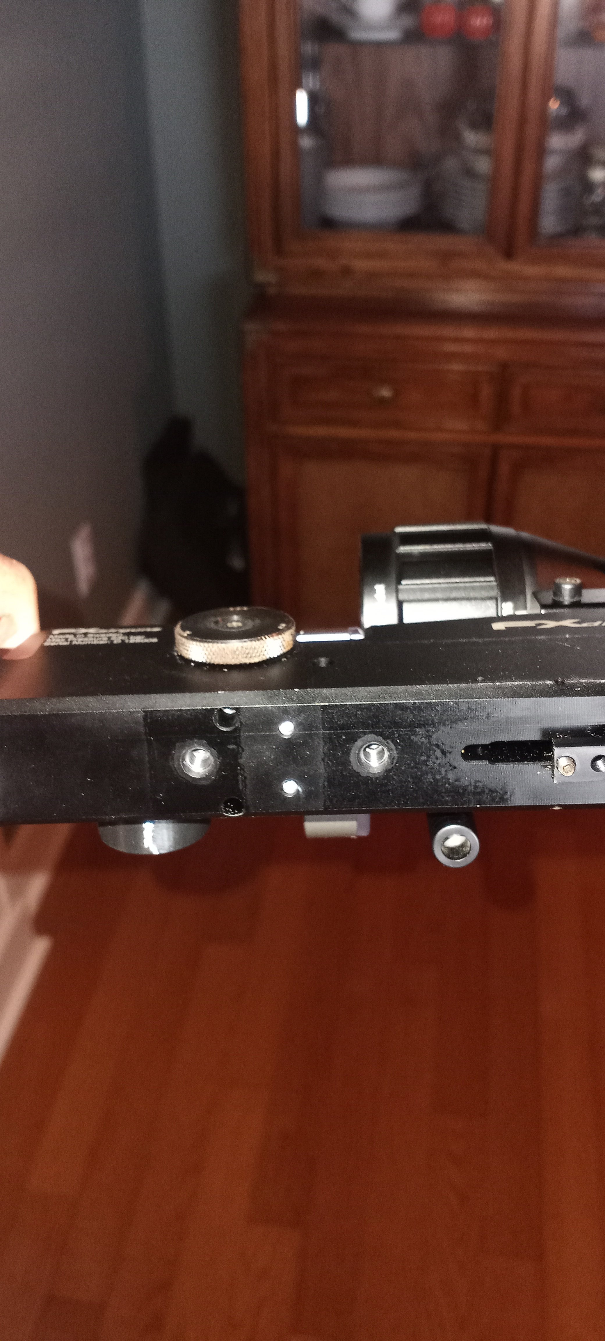

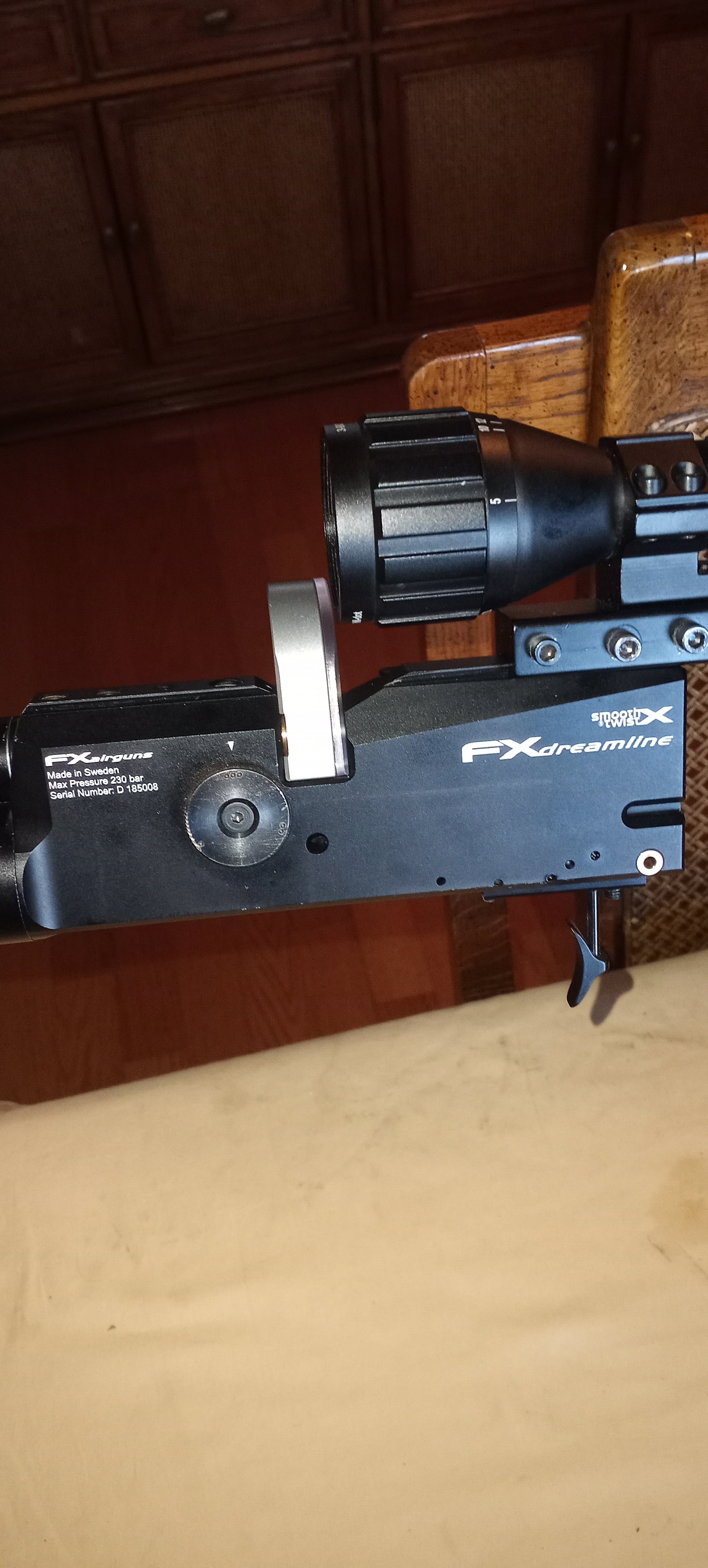

hi Trucker3573; is your transfer port similar to the dreamline. My transfer port is different from the new dreamline transfer port. I will try to send you some pics. Maybe you can see better than me to understand how to remove the transfer port wheel.
