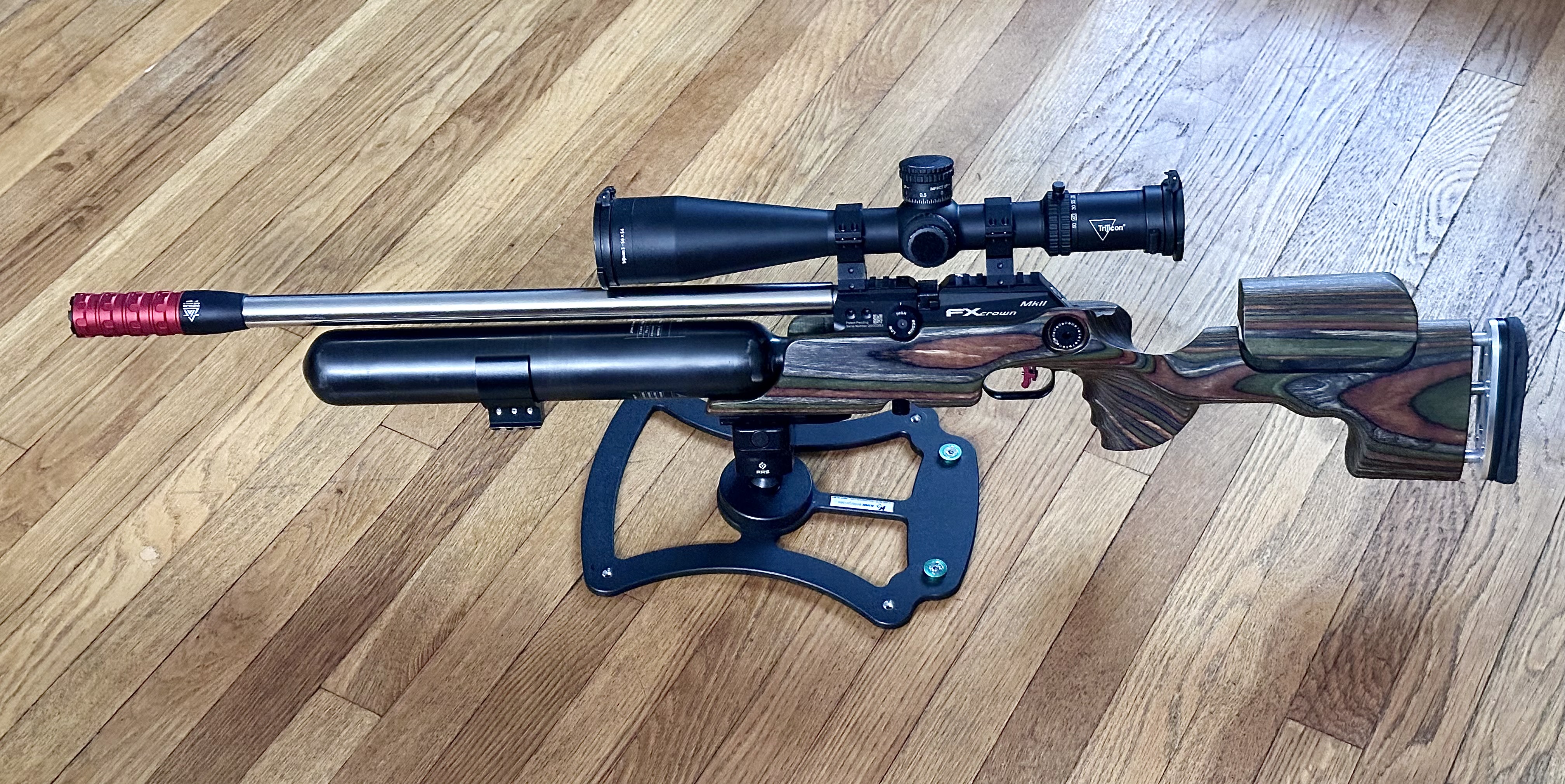

I have a Dreamtac, .177 cal, 500mm that I bought a little over 2 and a half years ago. I had a few flier issues when I first got it so I got a CF sleeve for the liner. I didn't bother bonding it to the liner. Now it's pretty much MOA out to my max of 50 yards or so with JSB Heavies or Monsters. I've played with slugs, but nothing outshoots a pellet inside of 50 yards, so I don't bother with them in this gun. I've run DFL Tatsu and Tanto moderators and have no noticeable drop (I do not have to adjust my scope) in POI. I do not use a barrel band.
I cannot comment on it being better or worse than the "old model", as I never had an old one. But I can do this more often than not at 45 yards:
img_9474-jpg.390252
