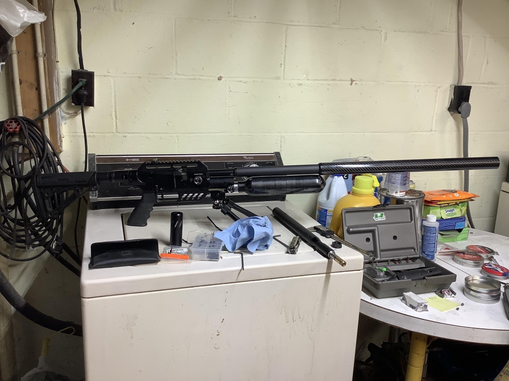

Building the worlds biggest airgun mod right now.
That moderator is as long as the rifle! LOL! I bet it's quiet!

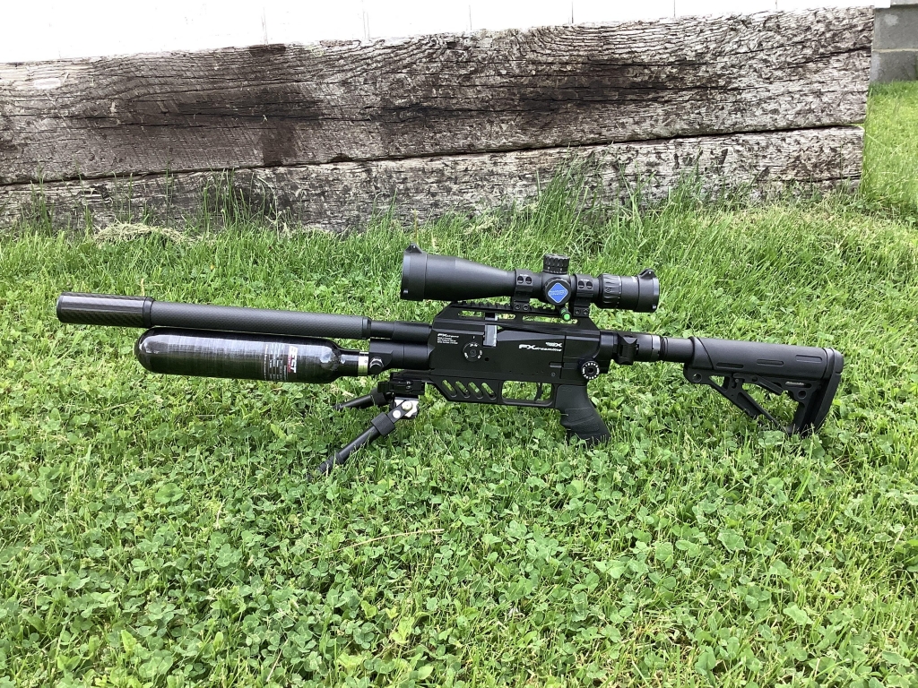

I spoke to UA last week and the Superior liner barrel kits are coming out for the 480mm Dreamtac. When who knows. I raised my regulator pressure from 150 bar to 170 bar and shooting the hybrids at average 860 fps (I hear the hybrids like 900+ FPS-but they sure like 860) with a deviation of 4 fps. I did though have to change my moderator to .30 as they were clipping. Without a moderator, no issues, but as you know this gun barks. FYI, I measured the Decibel readings on the .25 and .30 moderator (Donny FL Ronin-Nice can) and negligible difference.

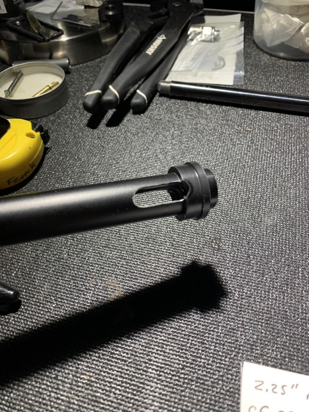

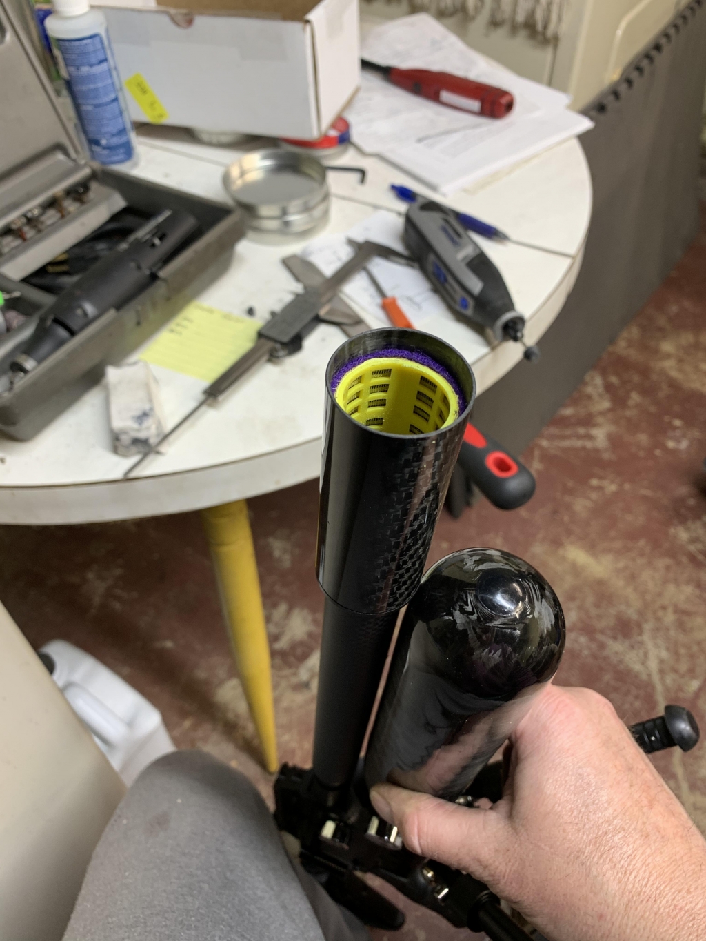

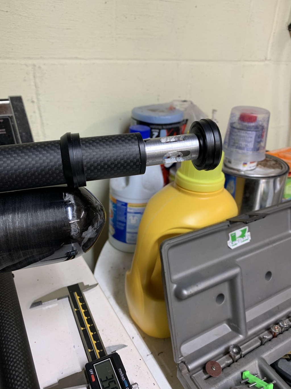

I just got done making my shortened Dreamline barrel quiet. I use this barrel for heavy pellets. It’s a triple shroud setup. I opened up the end of the stock skinny Dreamline shroud and it feeds into the larger CF shroud. Then I made a muzzle brake that screws onto the 1/2unf threads. I encapsulated that in the small shiny CF shroud. I only added 1.75” to the length of the gun. Tired of brainstorming and fabricating. Think I will just enjoy the gun for a while.
