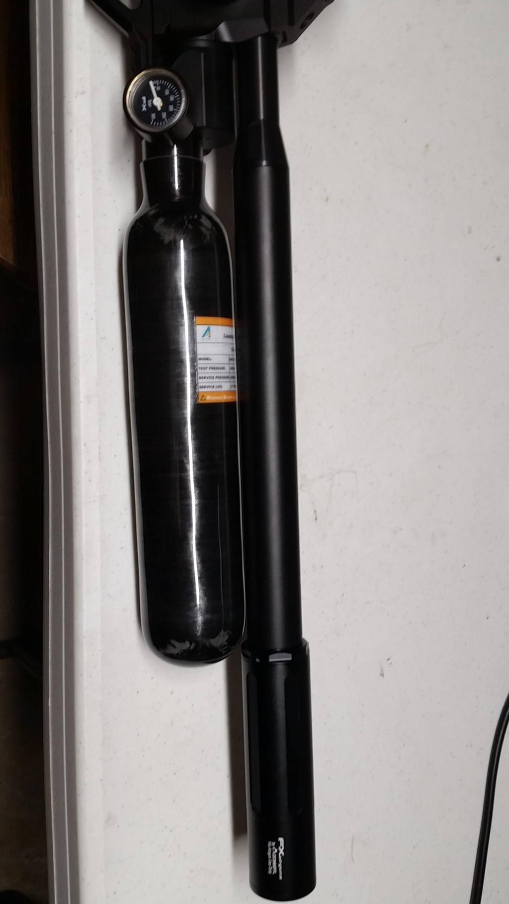

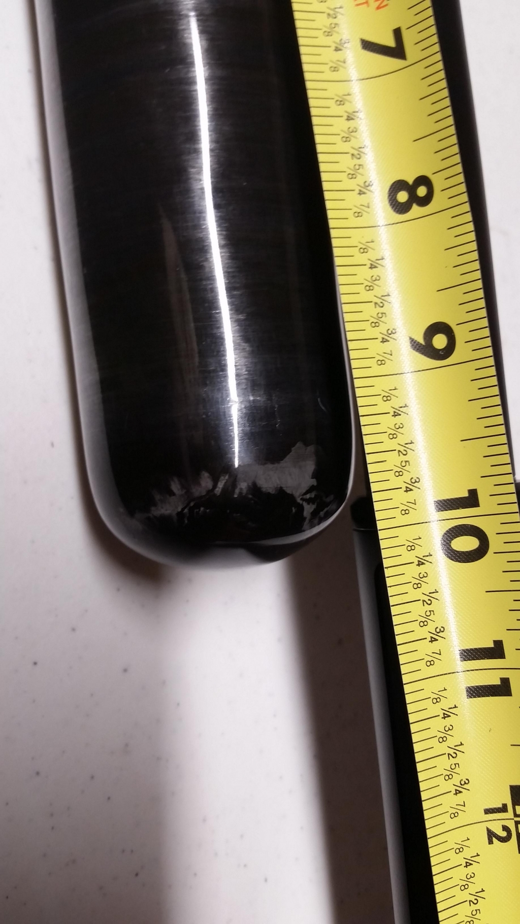

Just wanted to say thanks for the info in the Ebay .3L bottle.
I was on the fence about the .22L bottle and when I saw your pics I decided to go with the .3 bottle and the FX valve from Ohio A.
I think if it was 1mm longer it wouldn't fit. For reference I am measuring from the bottle adapter face to the beginning of the moderator and it is 9 3/4" so 247mm, and that is right where the bottle starts to taper. Whew close. So like the Ebay pics show 260mm for the bottle plus 10mm for the FX valve and that's 270mm but that is to the tip. Thanks again.

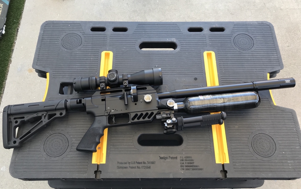

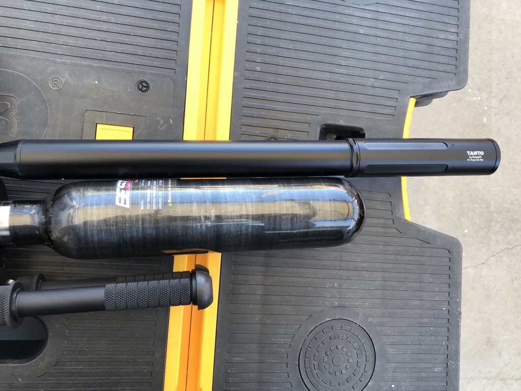

If you look at the best fittings website, the image of the bottle w/ valve is not what I got. The valve on mine looks to be twice as thick. I’m referring to the visible part of the valve, the ring at the end of the bottle.
As a result, I was not able to use the tatsu mod. The bottle stuck out just a little bit too much. I had to get a tanto. Not a big deal to me. The tanto is just as effective plus I think it looks better.
Here’s are some pics I previously posted

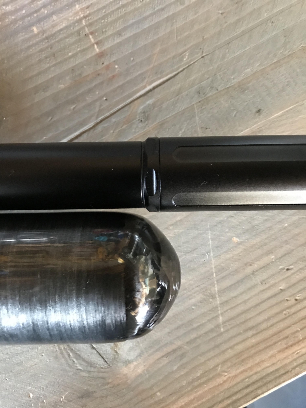

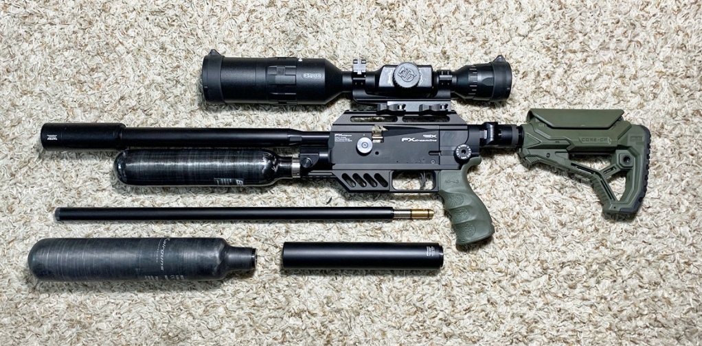

😗 Now...that is interesting. FLgunner just confirmed (one post above yours) that he's using "the Best Fittings 300cc tank with their valve and a Tatsu LDC" on his ".22 with the short 320mm barrel". I also double checked the picture he posted earlier and found both the bottle & valve on his gun look just like yours.

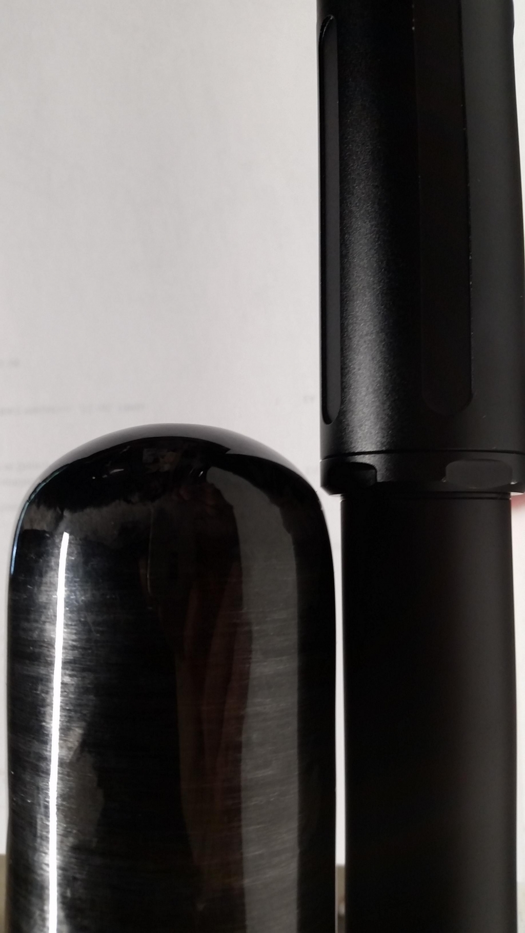

I’ll take a couple close up pictures of the valve and the clearance between the tank and the Tatsu when I get back home. The LDC doesn’t touch the tank.
Thank you in advance, FLgunner. A few pictures of the valve and the space between the tank and LDC will be helpful.

Thank you, Gabe. I communicated with Best Fittings and was told that they began to fit a spacer with the valve to increase the thickness of the valve because some customers reported a problem about clearance on some of the guns. That's why your valve is thicker than what shown in the picture on their website. They also mentioned that the spacer can be removed if you have a proper tool (however, I don't know if that will affect its function/performance or not.)
