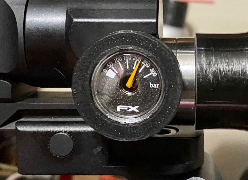

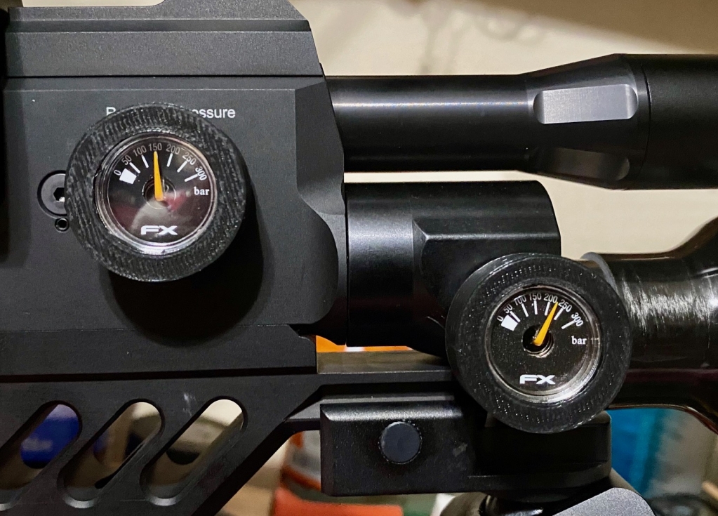

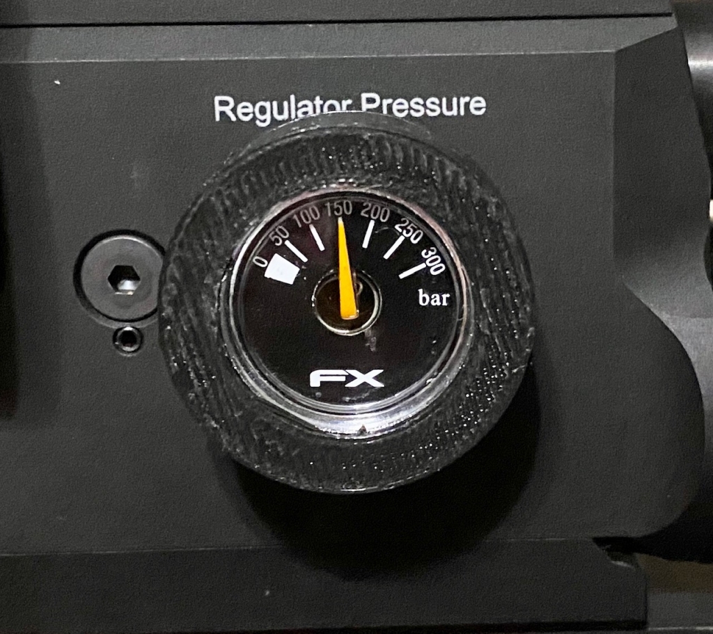

I 3D printed some gauge protectors for the DCT today. All that chrome bling was detracting from the tactical look!

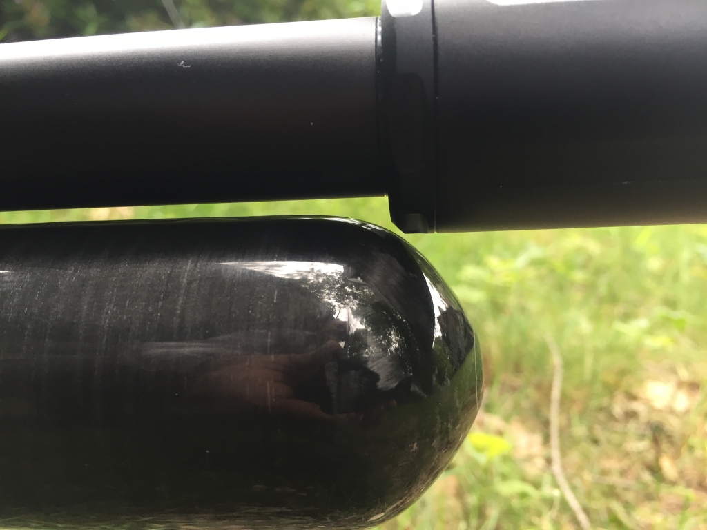

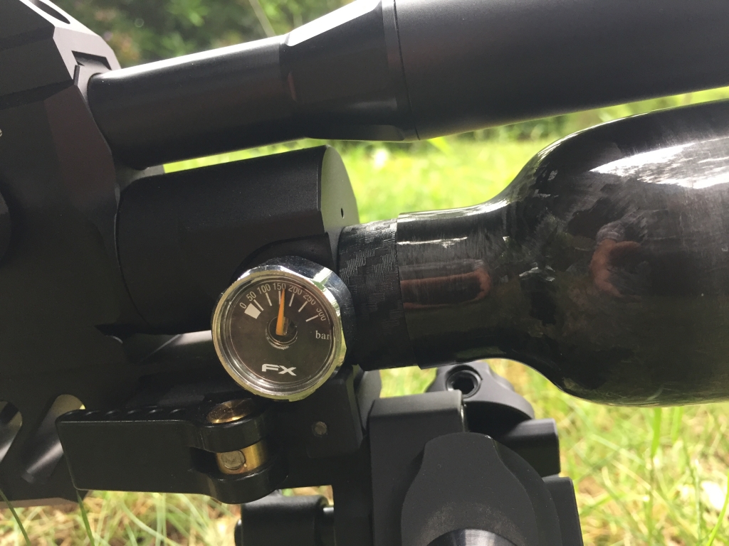

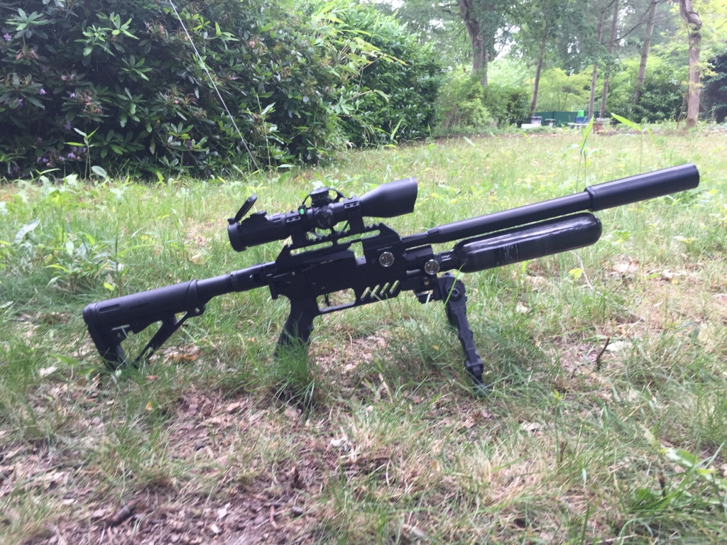

Ok, 300cc bottle arrived today. Installed it and fits like a glove! Did not even had to remove the spacer. the Sumo seems to be no problem! at all
Shot count is now around 50.
Only drawback is you loose most of the pressure if you screw/unscrew a pressurized bottle, but I can live with that.
Fixed the spacer with some carbon wrapping so it does not stick out so much..... happy with the result!

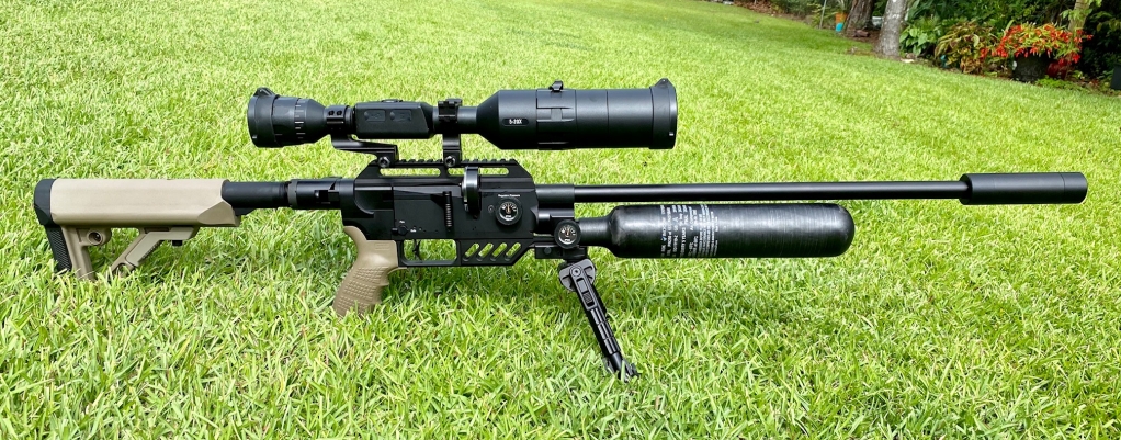

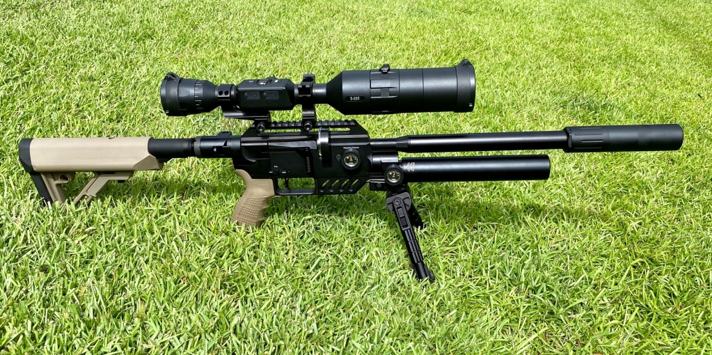

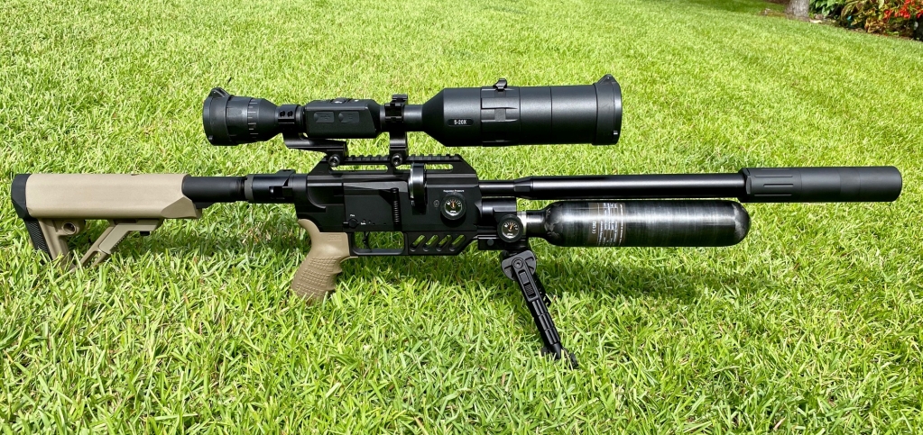

Here is my Dream-Tac in its current 3 different configurations:
Standard Dream-Tac Compact
Dream-Tac Compact with Best Fittings 300cc CF Tank
Dream-Tac Magnum, with 500mm barrel and 580cc CF Tank
I have a .25 bolt probe coming so I can also use the 600mm .25 barrel from my Dreamline Classic and the 380mm .25 barrel from my Crown Continuum. The Dream-Tac is definitely a versatile platform.
