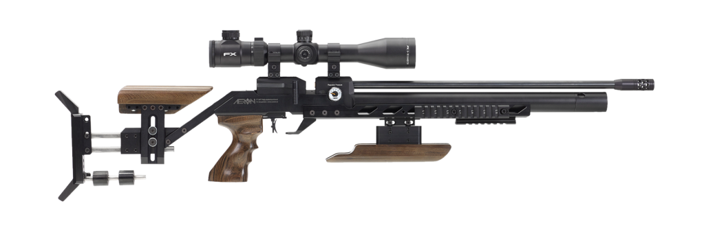

https://fxairguns.com/rifles/dreamline-field-target/
Apparently FX is using the Aeron FT stock with the FX Dreamline action and barrel. Utah Airguns lists them. https://utahairguns.com/fx-aeroncz-dream-ft-airgun/
I found a British review of an independent shop matching of the Aeron stock and FX Streamline action and barrel. https://sureshot-airguns.co.uk/wp-content/uploads/2018/07/ACZ-Streamline-Review-1.pdf
It seems like the British 12 fpe version of the FX Streamline is/was accurate. An option would be to buy a used Streamline or Dreamline and buy the Aeron stock.
