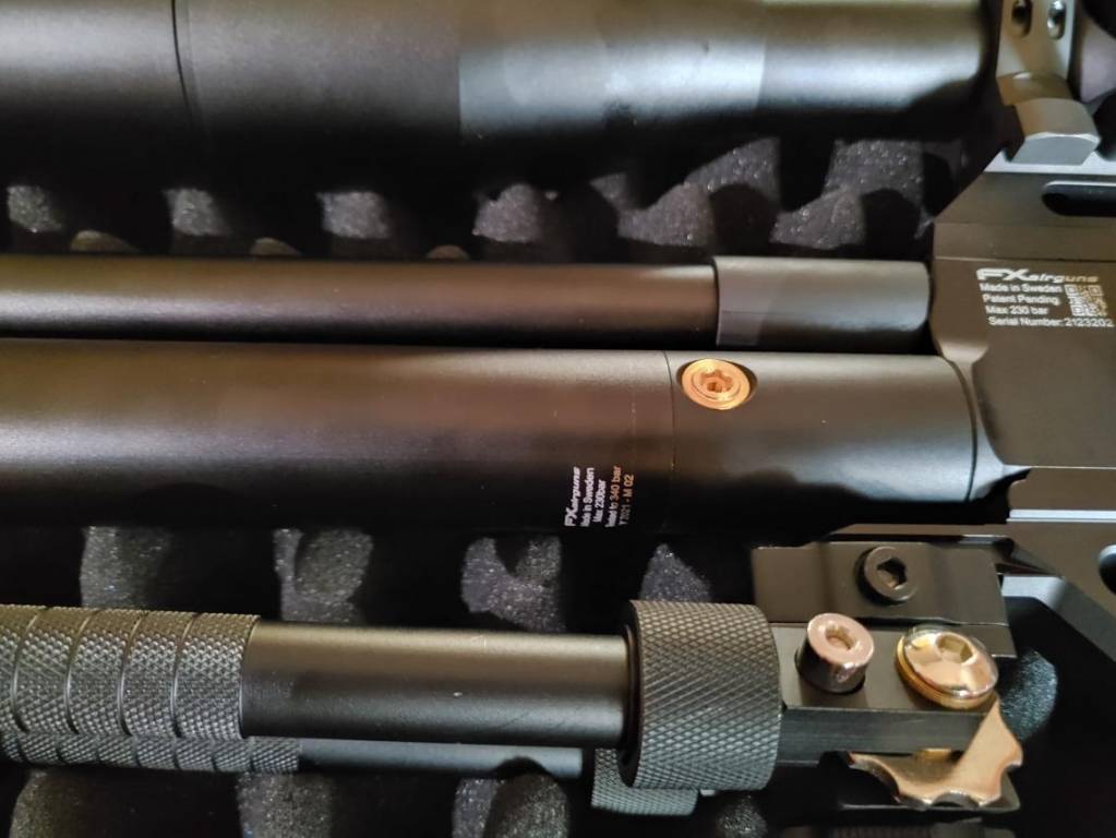

Yup. That's mine for example.
Greetings by the way, my first post here.
FX AMP Regulator Adjustments Instructions (by JoeKool)
2mm allen key
1. Counterclockwise regulator pressure goes ☝🏽
2. Clockwise regulator pressure goes 👇🏽
(If adjusting down, take a dry fire for every quarter turn)
NOTE: About 1 to 2 millimeters moves the regulator pressure gauge (it’s sensitive) watch the gauge while making adjustments.
Clear as mud?
Do you take the dry fire before or after reg adjustment?
