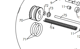

FX Dreamline leaks at the bottle adapter connection of the base
Where is the air coming out from exactly? How come you just dont send it to fx to fix it?
Here the air is comming out, but WITH the plenum. I just took this photo from the internet, to show.
I dont return it to FX, cause its actually only happen WITH the plenum. Without its working at the moment.
And I dont want to wait for months, to get back my DL. :(
Sorry for asking again, but do I have to use the thin o-ring, like I have to use at the bottle adapter, with the plenum or will it be installed without?

it could also be the tiny oring on the back of the valve pin.
You mean the valve pin cap, right?

I've installed the plenum without any additional o-rings. Only with some grease.
I've change the small little o-ring and closed the amp at the bottle adapter completely!
I've pumped up the gun to 100 Bar, open up the amp to 80 Bar and now its SEALING !!! :) :) :)
