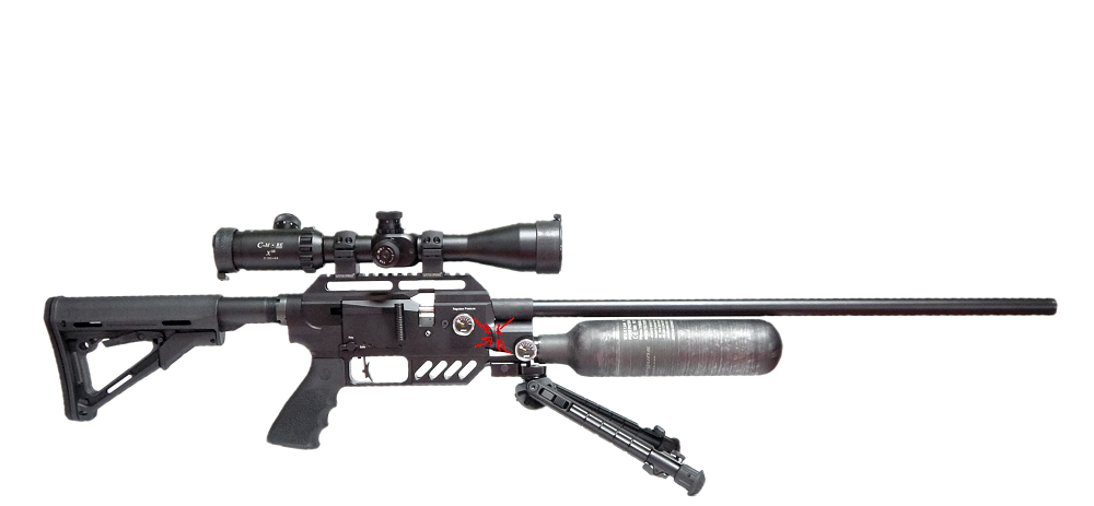

Here the air is comming out, but WITH the plenum. I just took this photo from the internet, to show.Where is the air coming out from exactly? How come you just dont send it to fx to fix it?
You mean the valve pin cap, right?it could also be the tiny oring on the back of the valve pin.
