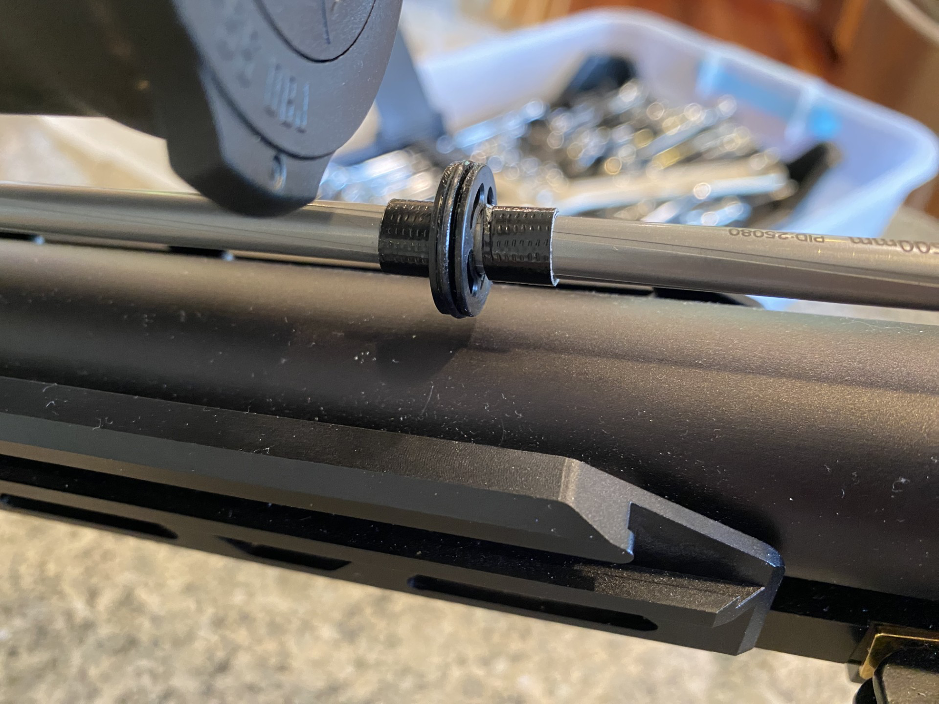

Pull the shroud off and check the tension nut that holds the liner in. Also when you have the shroud off, there should be a couple of spacers to keep the liner centered in the shroud. Why FX does not put some sort of tape on both sides of the spacers to keep them in place is beyond me. As you shoot the air that gets directed down the shroud will force those spacers closer to the action. Tape one at the end of the liner and one half way down before putting the shroud back on. I also pull the orings off the shroud end connections. In that I get a tighter fit and less movement when metal tightens against metal vs the orings being there.
Thanks a ton so far for this! So the nut as tight as possible, or is there a sweet spot? When you say tape the psacers in, do you wrap tape around the liner either side of the spacer? And one spacer midway, the other at the front end of the liner? Sure I'll have more questions when I actually take it apart tonight!

Get the tension nut snug pretty snug. Don't ham fist it and strip threads. Mark the flat that faces up with a black marker so you know where to stop if you strip it down again. I use a thin strip of duct tape on both sides of the spacer over the liner. One in the middle and the other about an inch from the liner tip.

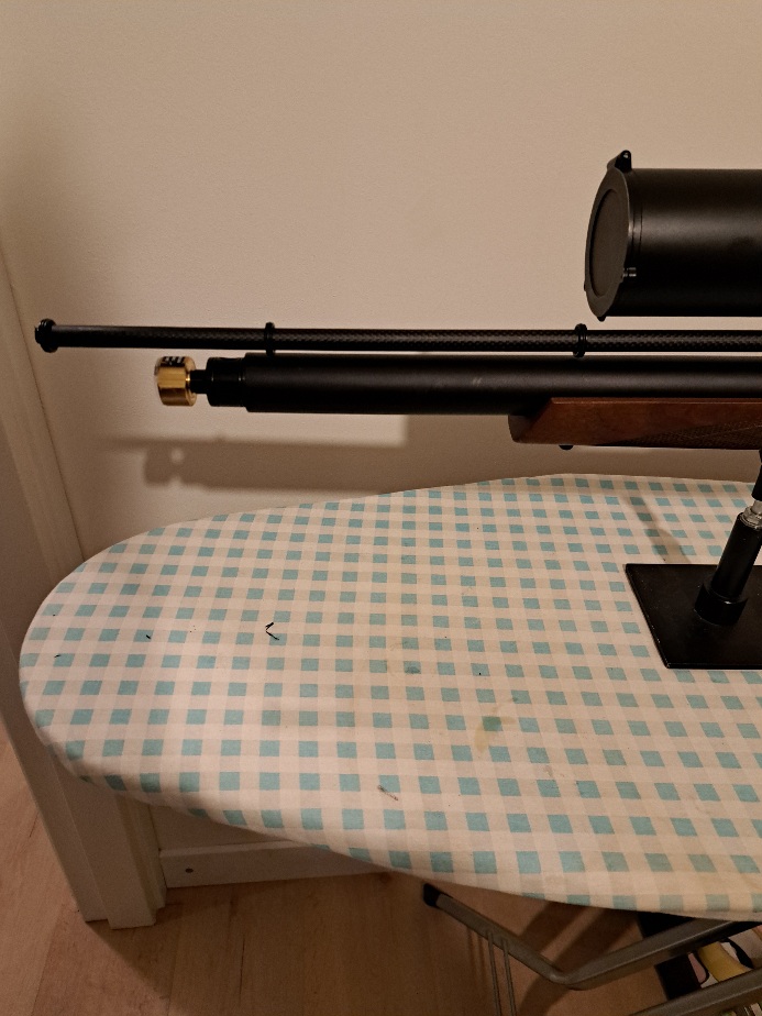

Also, you can use a carbon fiber tube on your liner to keep your shroud spacer in place in lieu of tape on the liner. It will stiffen your liner/barrel/shroud and greatly reduce POI shifts from barrel bumps or temp changes.
I don't think indexing will make a difference because the point of impact moves, it's not as though it consistently shoots too high or too low for instance. The carbon fibre tube sounds very good, I would like the barrel assembly to be more rigid. I'm also not very impressed with the little spacers, they can cant, so I don't think they're that great in supporting the shroud (more in another post, I did the tape fix). Can you share details of where to get the carbon fibre tubing please?

Ok tape stops are in place. I'm not very impressed with these spacers, they're kinda flimsy & they can cant.

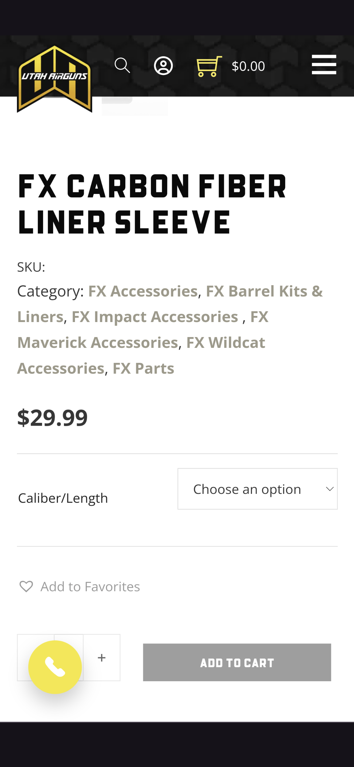

Utah airguns has carbon fiber tubing for the FX barrels, if you don’t mind dealing with them again. There are other vendors who have them also, but I got mine at Utah air.

Utah Airguns(or most places that sell FX) have carbon fiber sleeves for sale. Just choose your caliber and length liner.

Very good info so far, thanks a ton! So with the liner, epoxy or no? Also, where do you put the spacers? Right now one is halfway down the barrel, the other is closer to the muzzle? Do you cut the carbon tube in half? How often do you clean the FX barrels?
Try it without epoxy 1st. Mine were fairly snug going on my liners. I only had to epoxy 1 of my liners after I didn't see an immediate improvement.
The carbon fiber will end about an inch and a half before the muzzle. No need to cut anything. Just remove both spacers, slide the carbon tube down to the jam nut, then replace one of the spacers.
