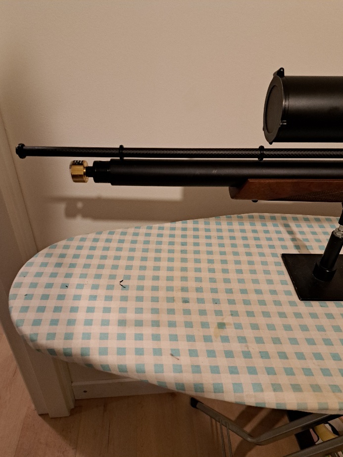

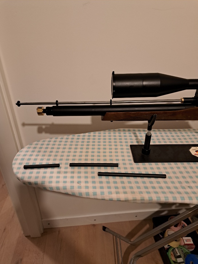

You could probably " stack " several CF pipes to fill the dreamline shroud just like the single CF liner sleeve would do in a barre like Impact or Maverick.
Actually when i changed from 600 mm barrel to 700 on my Maverick i did just that as the price for a FX shroud that would fit a 700 mm barrel and the additional barrel pipe to support a 700 mm barrel was too expensive.
So i got 3 CF pipes, each fitting inside the other ( with a little sanding ) and then of course on my barrel pipe which was extended 100 mm with a cheap adapter.
And my Maverick shot just fine and had a barrel the same size / thickness as it would have with the factory shroud.
Mind you the 3 pipes when assembled and installed on the rifle was a bit " bent " so you had to be weary of the clocking of the sleeve CUZ otherwise if off MAX you would be a foot or two off at 50 M.
I made a slight mark on my CF " shroud" but i did not have it off very often, when cleaning the barrel i just fished out barrel itself out the front so the CF " shroud" could remain in place.
Mind you POI on my Maverick still shifted, but i was okay with that as i anyway was tweaking on it all the time.
In my case it was more a problem of getting to a +100 mm longer barrel and still have the rifle look OK / stock.

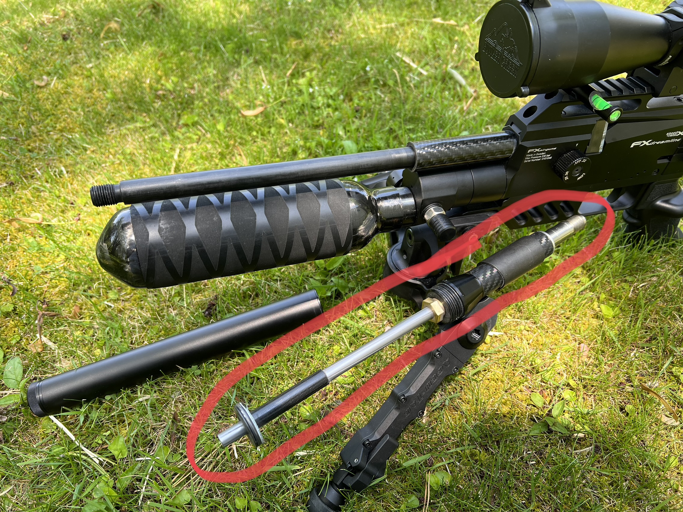

I never paid much attention to the full size Dreamline barrels. But this topic caught my attention and I’m a little shocked at the pictures. That thing is begging to POI shift. If you know you have a good liner because it shoots tiny groups, I would commit to fixing it. But it will be permanent. That is a nice setup you have there @bsahogger. Time to buy JB Weld, a carbon tube for your caliber and length then get to work. Lay out your work and cut the tube into sections accounting for those goofy discs. If you want to really commit then I would start my bonding process on the liner, then install the nut. Then work my way out to the end of the liner bonding everything tight up against each other.
My Dreamline Compact had a short version of “liner in the wind”. So accurate but it just shot tiny groups wherever it wanted from day to day. I thought about trying to fix it but wound up just making a barrel for it. If the little tiny barrel in this picture gave me fits, I can’t imagine how frustrating a long one would be.

I was also shocked when I saw those flimsy spacers, not what I expected from FX, very reminiscent of my days chasing POI shifts on Marauder, very much the same sad set up. Anyways, right now I have the pieces of tape either side of the spacers, I've cleaned the barrel & put the barrel band back on. Dime size groups but only at 19yds, hopefully time allows this weekend for me to shoot longer distances & a whole bunch of strings so that I can check for shifts. If it shifts again I'm either going to make a full length aluminum sleeve with about 5/8" OD & set screws so that I can jam it hard up against the nut, then secure it to the liner; or epoxy a CF tube onto the liner. At this stage I don't believe that a CF tube by itself without epoxy does anything but keep the spacers in place, the barrel will still droop & the fulcrum will be very close to the nut... so POI shifts will occur.

I have noticed the following on my FX airguns with shrouds:
The FX spacers are "friction fit" pieces of plastic with o-rings "connecting" the liner to the shroud(at various points) down the length out to the muzzle. The air(and lead particles) from inside the liner is re-directed backward(toward the action) into the shroud from the muzzle end. There is a tiny hole near the action end of the shroud which vents some of the air(and lead particles).
The more air that is forced backward into the shroud(i.e- the faster/more power you shoot), the more(and higher pressure) air(and lead particles) is forced backward into the shroud. This redirected, high pressure air "blasts" into the shroud, impacting the spacers. Over time, this increases the likelyhood that the "friction fit" on the spacers will give way, and they will move to a different point of contact on the liner/shroud. This new contact point can potentially change harmonics, POI, etc...
At lower power, this system seems to stay in place well. When the power is increased to near max settings, no so much. The solution that has yielded the most consistency for me is using the carbon fiber sleeve over the liner. This serves help to stiffen the liner/shroud and anchors a single front spacer near the muzzle. It also makes it easier to remove the shroud for cleaning the barrel and cleaning the lead dust out of the shroud/liner system(which should be done on a regular basis because it actually does improve performance).
