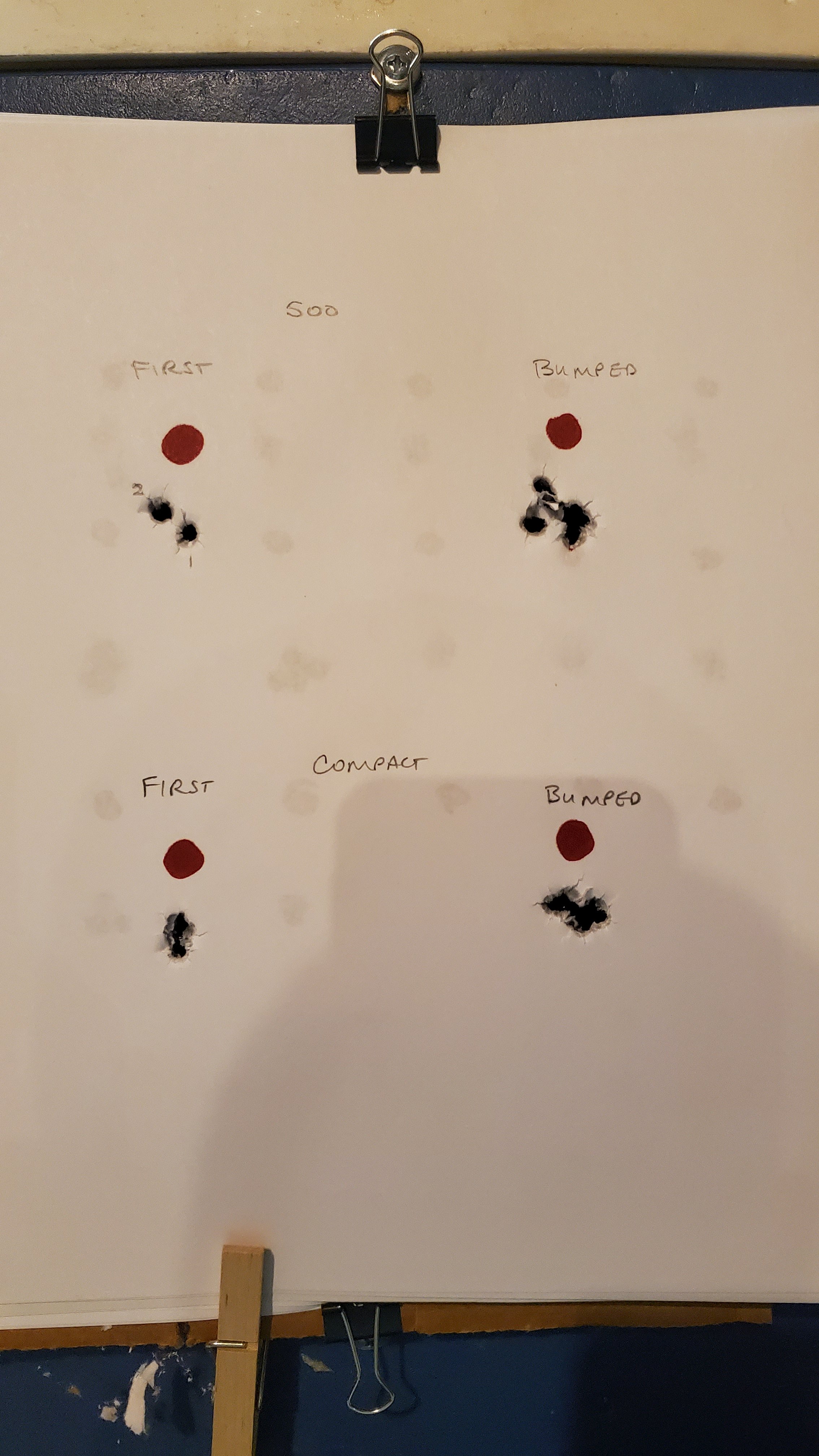

So here is what I got today and my setup
Dreamline Tactical Bottle 500mm .22 with Sightron S3 3-10 scope shooting JSB 18s around 860 fps Eaglevision magazine off a tripod
Starting bottle pressure 192 bar
Reg Pressure 106 bar
After first few shots 103 bar
Transfer port High
Macro wheel setting A
MIcro hammer setting .75"
First shot speed 836 fps
Second shot speed 861 fps
Third shot speed 861 fps
total shots 11
Dreamline Tactical Bottle 300mm .22 with Leupold 2-7 rimfire scope shooting JSB 15.9s around 730 fps from Carm mags
Starting bottle pressure 195 bar
Reg pressure 97 bar
after a few shots 95 bar
transfer port Medium
Macro wheel B
MIcro hammer adj .7"
First shot 710 fps
Second shot 709 fps
Third shot 746 fps
total shots 11
I took a control group of 3 shots on the left to see where it was hitting and to see if there was reg creep. Then I squeezed or pulled the barrel in four directions, 12, 3, 6, and 9 o'clock to test poi shifts. The 500 barrel is pretty stock while the 300 barrel has the liner carbon sleeve, and a carbon tube glued to the outside of the shroud tube for more rigidity. The shifted shots are two shot groups and the 500 was doing really well with minimal shift until I squeezed it in the 9 o'clock direction. Those shots landed outside of the main group. The 300 barrel, even though it is shorter and stiffer did worse.
Transfer port High
total shots 11
Reg pressure 97 bar
Macro wheel B
First shot 710 fps
Second shot 709 fps
Third shot 746 fps
total shots 11

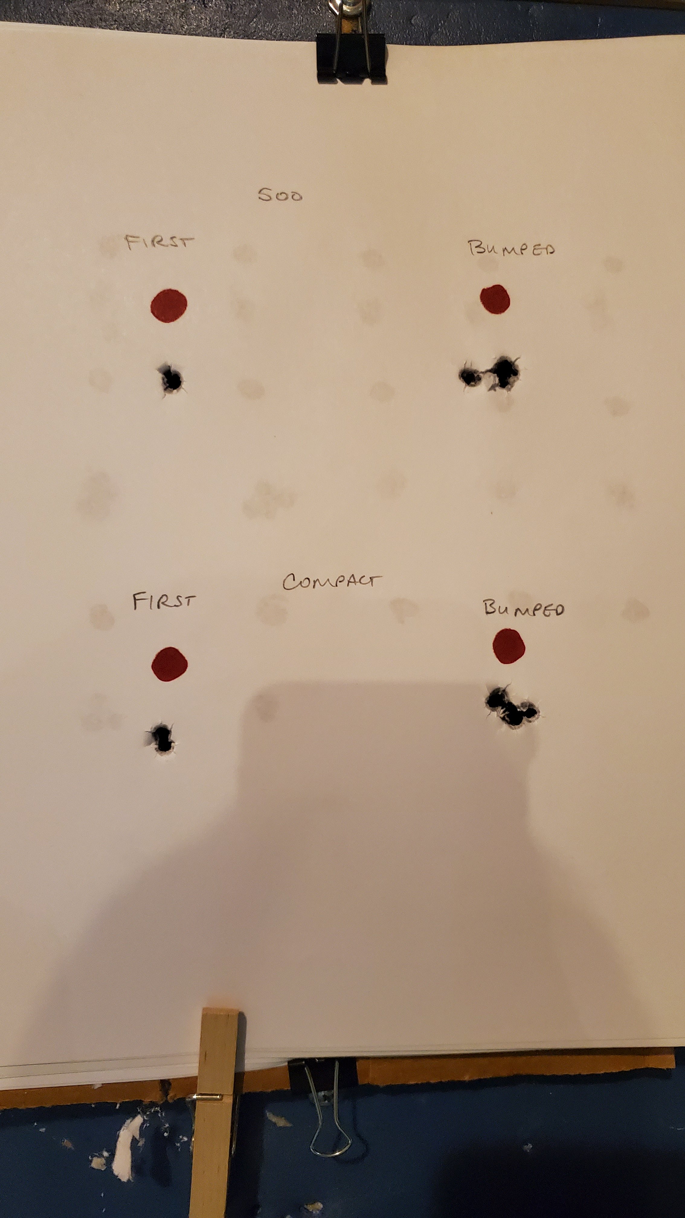

Day 2 500mm tank start pressure was 180 bar, reg 106 bar 1st shot 819 fps, 2nd 851 fps and 3rd 849 fps. Group was high and to the left of the original group.
300mm 185 bar on tank, 97 bar reg, 1st shot 711, 2nd 717, 3rd 726. First group was pretty close to the original and the bumped group stayed together. The 300 has all kinds of extra carbon tubing to stiffen it. Guns stayed in the basement and shot indoors between groups.
