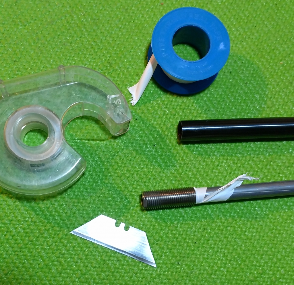

Reading through the thread it sounds like you have tried some things. Here's what I did to fix my Impact point of impact shift. From what I understand, you gun has got the same basic barrel tension nut on the front. Here's the quote I wrote up on someone else's thread, and a link to my thread on the subject.
I've got an original Impact (with many Gen 2 parts) that point of impact would shift on. It was due to two things shifting. One was my Athlon scope's parallax adjustment sticking. I could see and feel the adjustment move incorrectly and throw off the point of Impact at different ranges by quite a lot. Googling showed that it was a common problem and Athlon warrantied the scope immediately. The second point of impact shift was more minute and was caused from the barrel shifting, due the sloppy fitment between the barrel tension nut and the barrel itself. There was enough slop between the two that barrel whip at the shot moved the tip of the barrel within the tension nut. To fix this I simply wrapped the end of the barrel with a couple layers of Teflon tape to remove any movement. Now when the tension nut is tightened over the barrel and into the tube, the barrel centers itself within the nut and can't move.
I have some fixes coming to try. Going to layer carbon fiber tubing all the way up to the inside diameter of the shroud to make a carbon wrapped bull barrel. I checked my barrel tension nut and was able to get another 1/4 turn on it for tightness so check yours periodically as I think when the orings take a set, they can be tightened just a little bit more. Going to do half the liners on the barrels the thickness of the shroud. Also have a carbon tube to go on the outside of the shroud. Time to strengthen this thing up.

That is why I will never buy a FX. A fix for one does not mean it will fix the others as well. Why is it not done properly during manufacturing? Why is it up to the end user to fix their design and manufacturing problems? Why don't they offer from their side free and complete fix for this problems? Why don't they manufacture it with a proper barrel like other makes and their older rifles used to be instead of this drinking straw rubbish? Just look at that flimsy thing in the picture above. For me, the barrel is 50% or more of the gun and they come up with this !!!
To the OP, if you decide to keep the gun and can't get it fixed, buy a LW or CZ barrel and install it, that is if the receiver is strong and sturdy enough to hold it.
