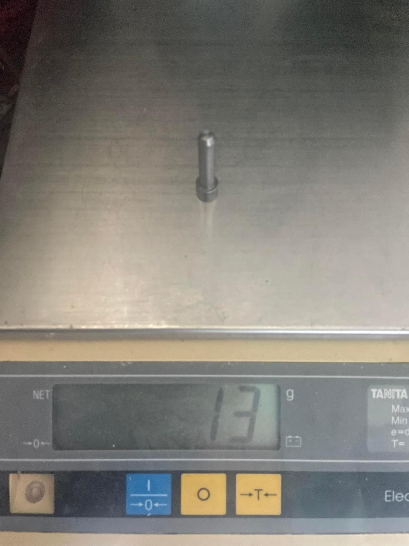

you have to make sure you have the correct hammer weight.
