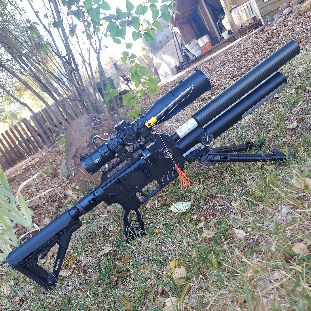

I sorta agree .. the Dreamline is not a powerhouse & especially in the smaller caliber.
My personal Dreamtac compact came factory with 1 extra plenum from factory.
Having shot 20 grain .177's in other capable platforms, the dreamline I seriously doubt is up to that task. 12.5 or maybe 15's tho ??
