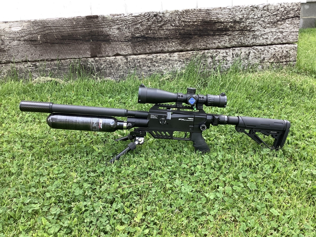

I did build a longer barrel for my compact. It was longer than the 380mm but shorter than a 500mm. It allowed the gun to coast along at 880fps with 18’s. Funny thing is, I didn’t like the gun as much. The gun lost a little of what I originally liked so much about it. I’m back to using my 380 and just shooting a little slower. Gun is just balanced better with the shorter barrel. I even made a 3 stage shroud for the longer barrel to keep OAL as short as possible and keep the noise under control. Sill like the 380 with a functioning shroud better. Here’s the longer barrel with shroud.
