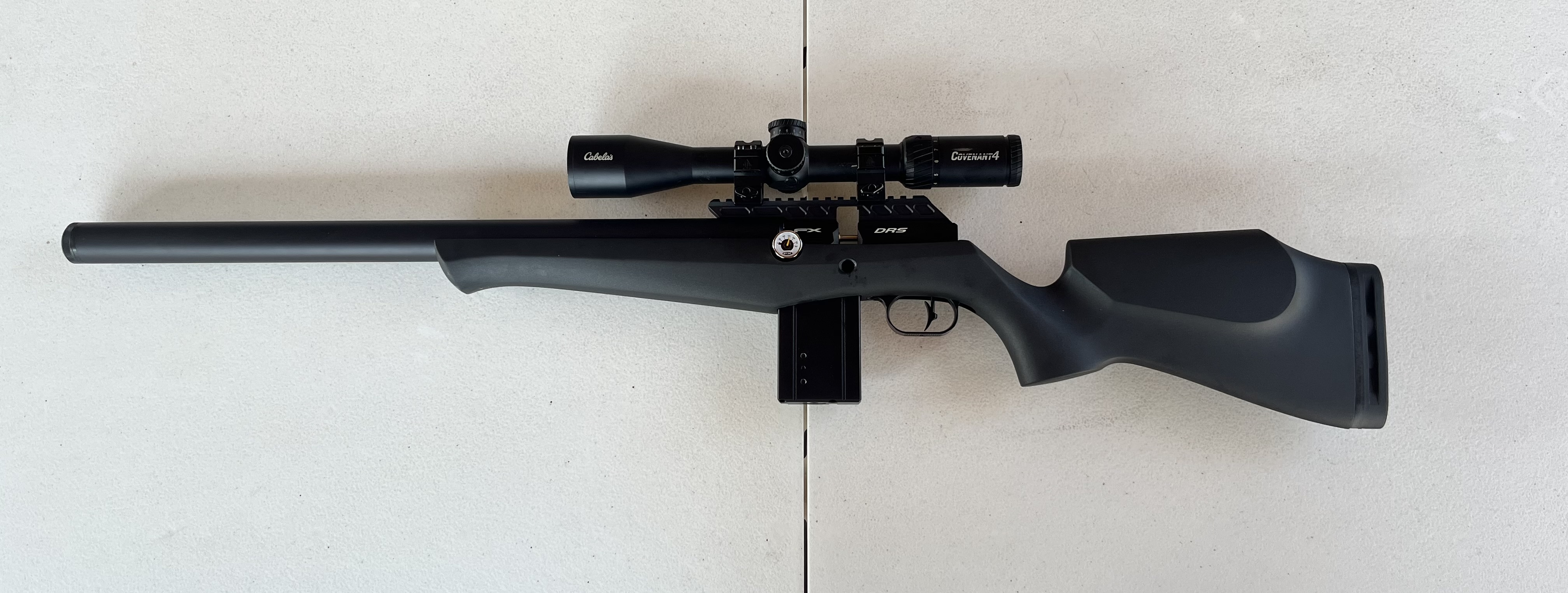

FX FX DRS .22 600 mm super high power plenum is in the way to it's new home.
I decided to trade a 35 fpe .22 Cal and a .357 Cal to buy a powerful .22 (60-65 fpe).
After A LOT of analysis, I decided for the DRS in 600 mm and with the super powerful plenum and high picatinny rail.
This rifle should give the alternative of shooting accurately slugs at different levels of power.
Length of 41', not so long...... Super light weight.
Only time will tell if this was or was not a good decision....
It will take some time for me to receive it.
Once I have it in hand and after shooting with it, I will share my experience.
