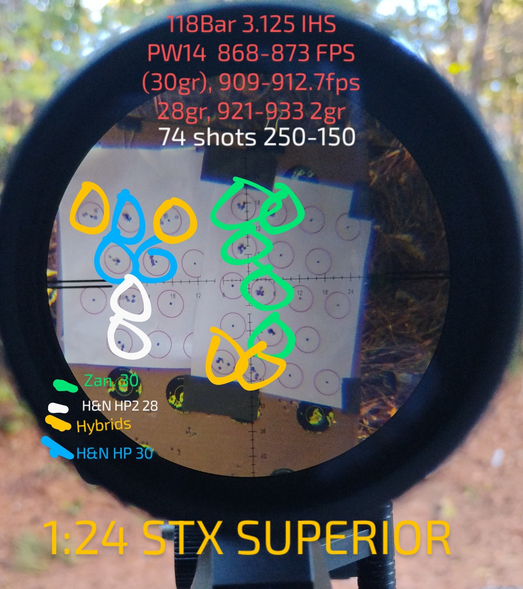

The stx slug liner in .25.. ON MY GUNS shoots Hades, MK1 and Mk2 heavies, AEA 29.5gr and above pellets VERY WELL. Slugs above 30 very very well.
i've tried 26 and 28 gr slugs in the 1:16 liner and it scattered them all over. The .250 30gr and up hole on hole.

All standard superior FX liners in .25cal can and will shoot up to 34 grain slugs. It has been proven on here by myself and many many more, and also goes along with what FX states about their standard superior liner.

I'd love to know, i hate swapping barrels depending what i'm hunting (thus what i'm shooting) I've done side by sides on every slug i've had and there has been a total of one slug i've had more luck with (over 30gr) the superior than the 1:16 STX slug MK1 KO. everything else gets much tighter in the faster twist IN MY experimenting. from 820fps-925fps. For me .22 superior was fantastic for 17-25gr slugs.

Btw that zan 28 with 3 marks on the target isn't one group. It's 3 the zan 28 seemed to have the lowest tolerance for fouling had to pull a patch every 2 mags or they'd open way up

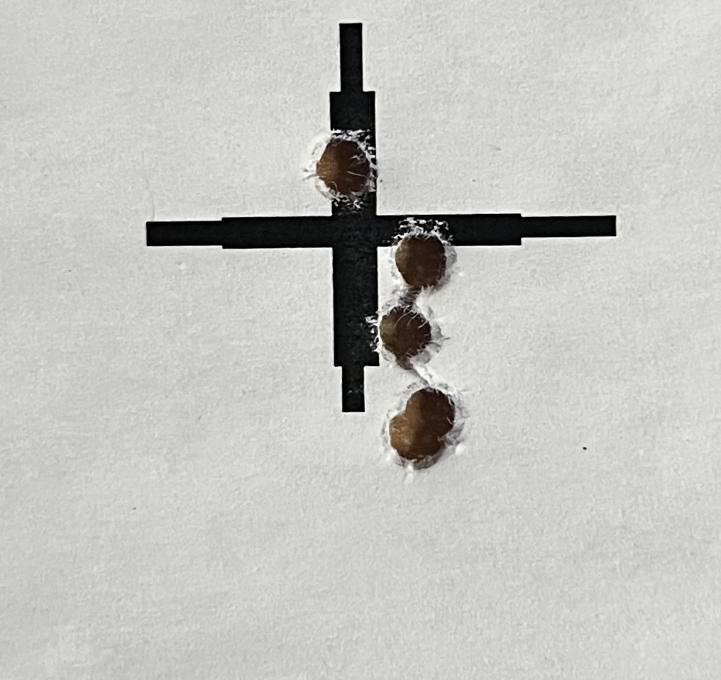

My FX DRS 600 mm with super Powerful,Plenum shoots NSA 25 grain like a super champ...... And I mean It:
88 yards
