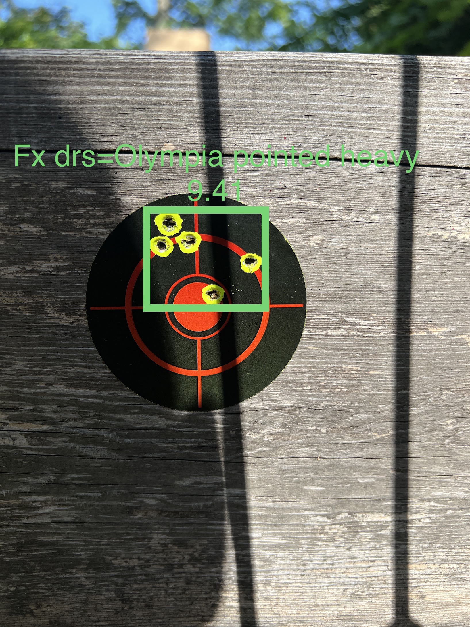

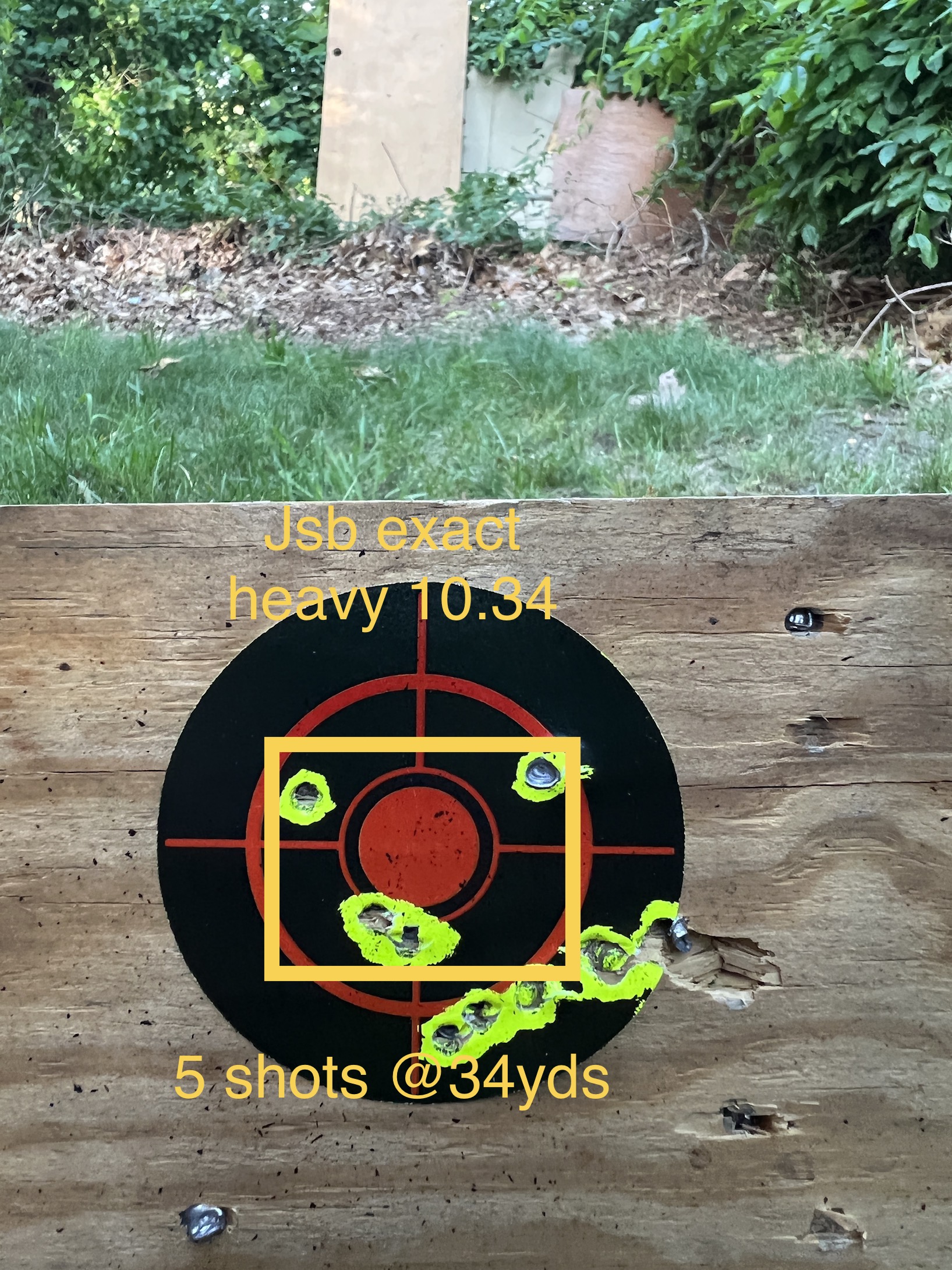

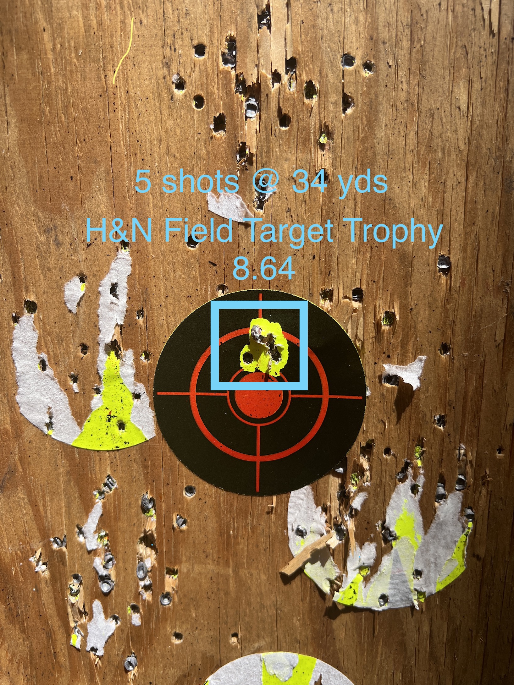

check these stats out… B85057CF-BAD9-4E10-B9FB-36B6885E7D7C.jpegF5BB716F-5A47-45DE-837D-534F5CF264A1.jpegB472DF86-C37A-4E4C-8332-181305FEC2AF.jpegF848E44C-70E7-4B13-B08A-57B55C76BD92.jpeg
That rifle definitely is not tuned for that pellet. You can tell that from the spread on speeds. Not close. I don’t know what the conversation was like when you purchased it, expecting it to be tuned like you wanted, but that is not in tune at all.
The guys who sold me this said this gun likes jsb 10.34!!!
but my test results show me
this gun loves H&N field target trophy 8.64!!!
now it makes me wonder if its the shape of the projectile that matters more when looking for accuracy than the weight of projectile!!!!

I see two things in this topic. First, I see the all too common honeymoon post when a guy first shoots his new toy. Then days later, unhappiness. I respect your honesty and not being ashamed that you may have prematurely……….posted. Second thing I see is that your barrel wants to shoot pellets fast. I would try those 10.34’s at 915+fps before I gave up on the gun. You have plenty of shot count to play with. Just turn up the reg a little, find the max speed with the hammer spring until you get to 910ish fps and test. Then bump it up again if no good. I would test all the way to 930fps before I gave up on that pellet. Remember, baby steps with adjusting the reg. You have time.
Weight matters first when it comes to a particular tune. You tunes would normally be different on 10’s vs 8’s.
Based on your targets, it definitely appears to be better setup for 8’s. If your original shot strings on here were with 10’s, I agree that it looks like they are probably being shot too slow for typical 10’s accuracy. If 10’s are too slow on that tune, then it’s probably better for 8’s, which seems to fit.
I don’t know anything about the DRS for tuning, because I don’t see any usually FX knobs to help you. But the general tuning ideas are the same for most all PCPs once you figure out how to adjust the reg and hammer spring.
Most retailers are good about support after the purchase. Call Utah and tell them about what you are seeing and ask for help.

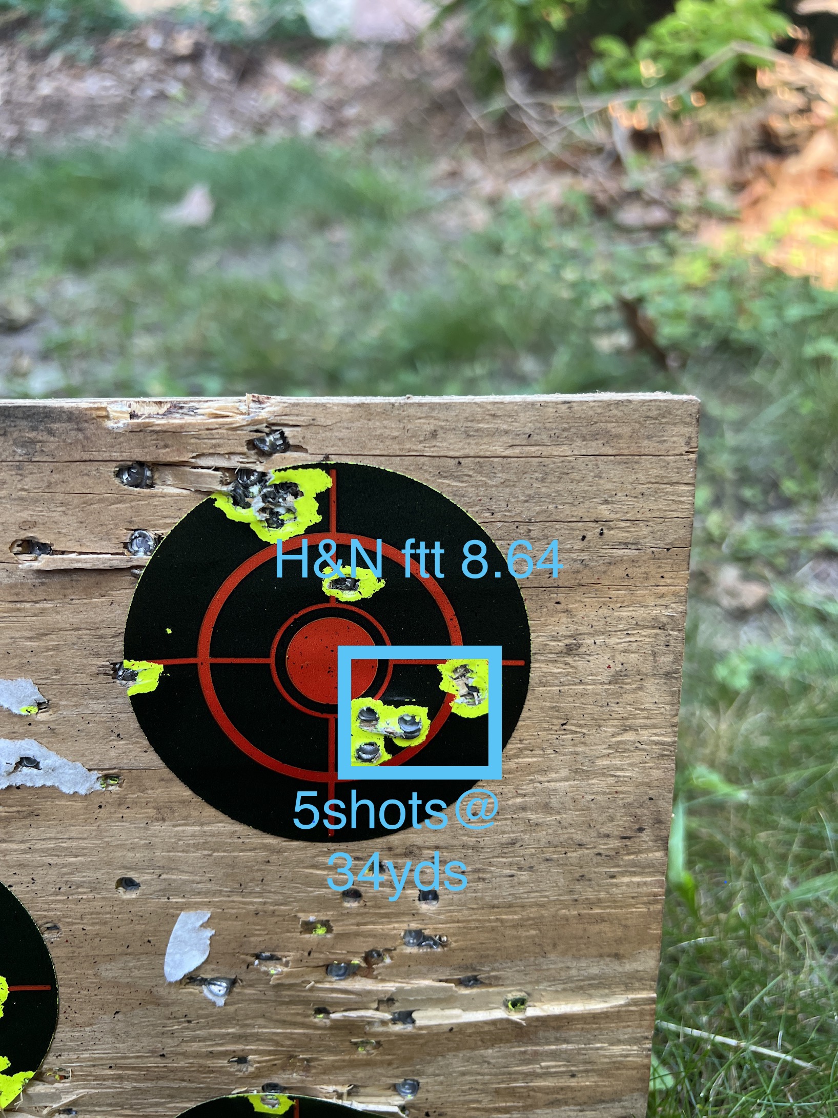

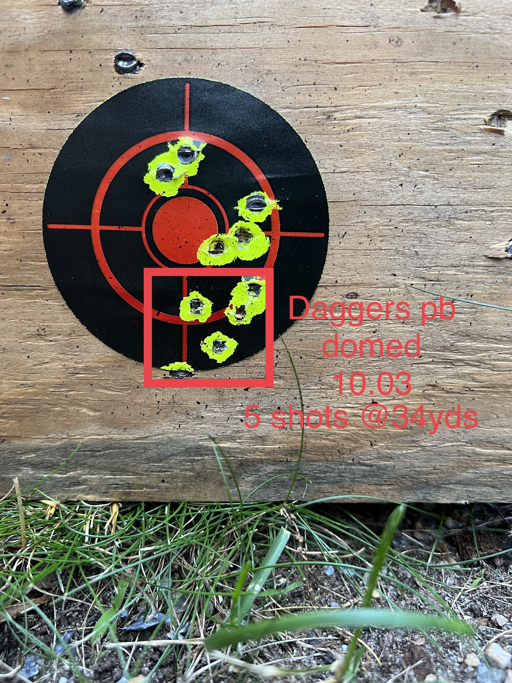

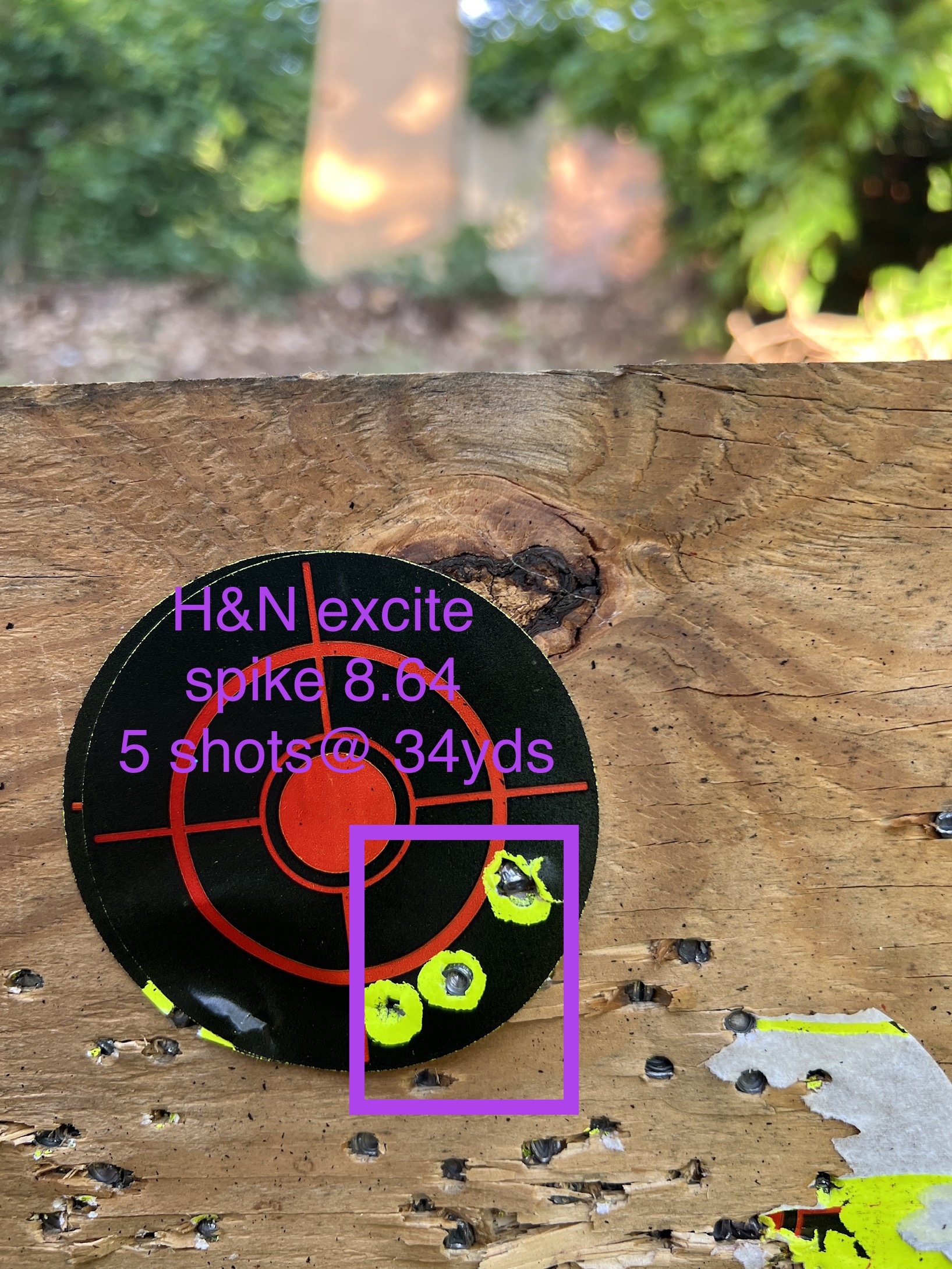

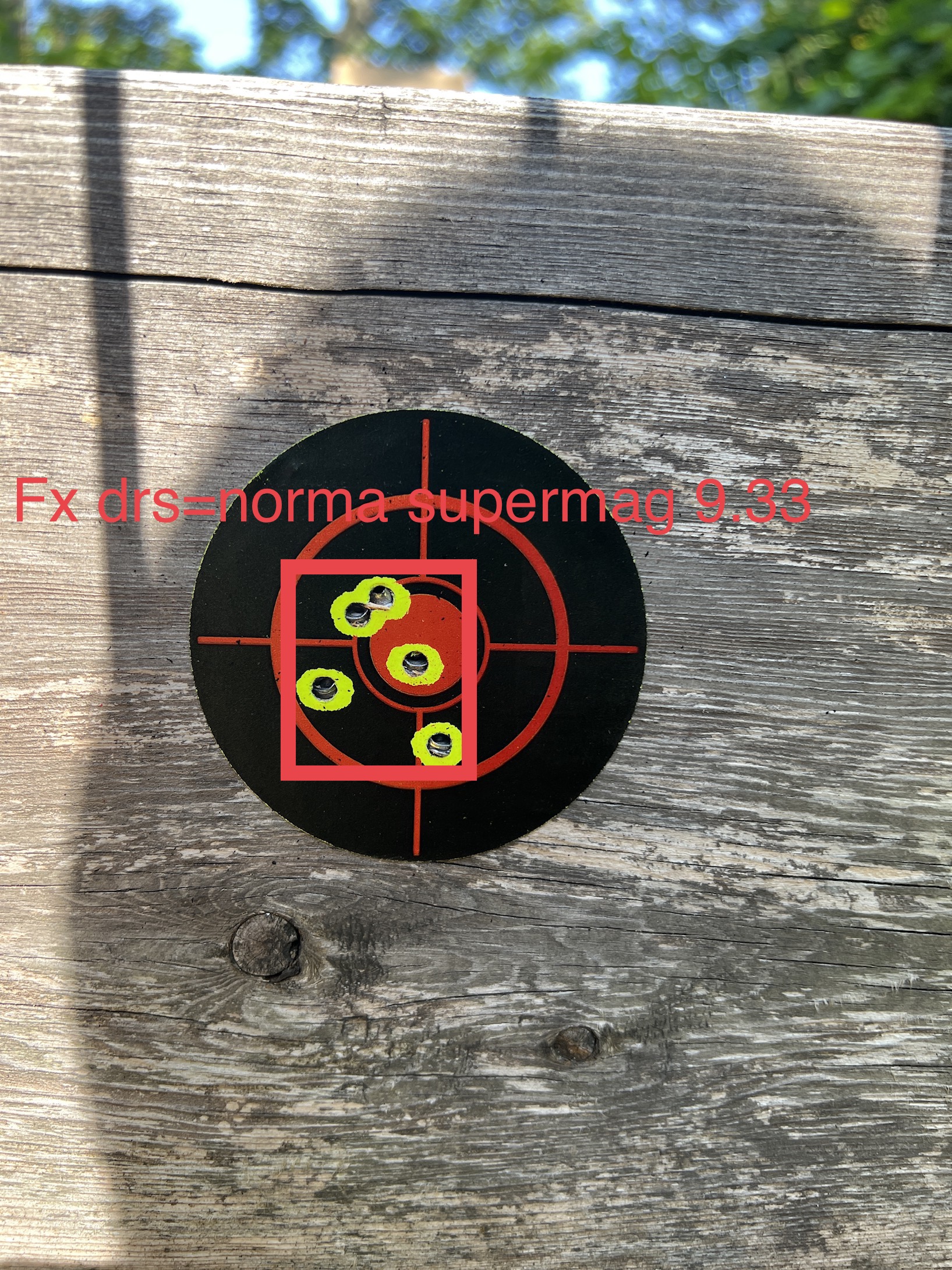

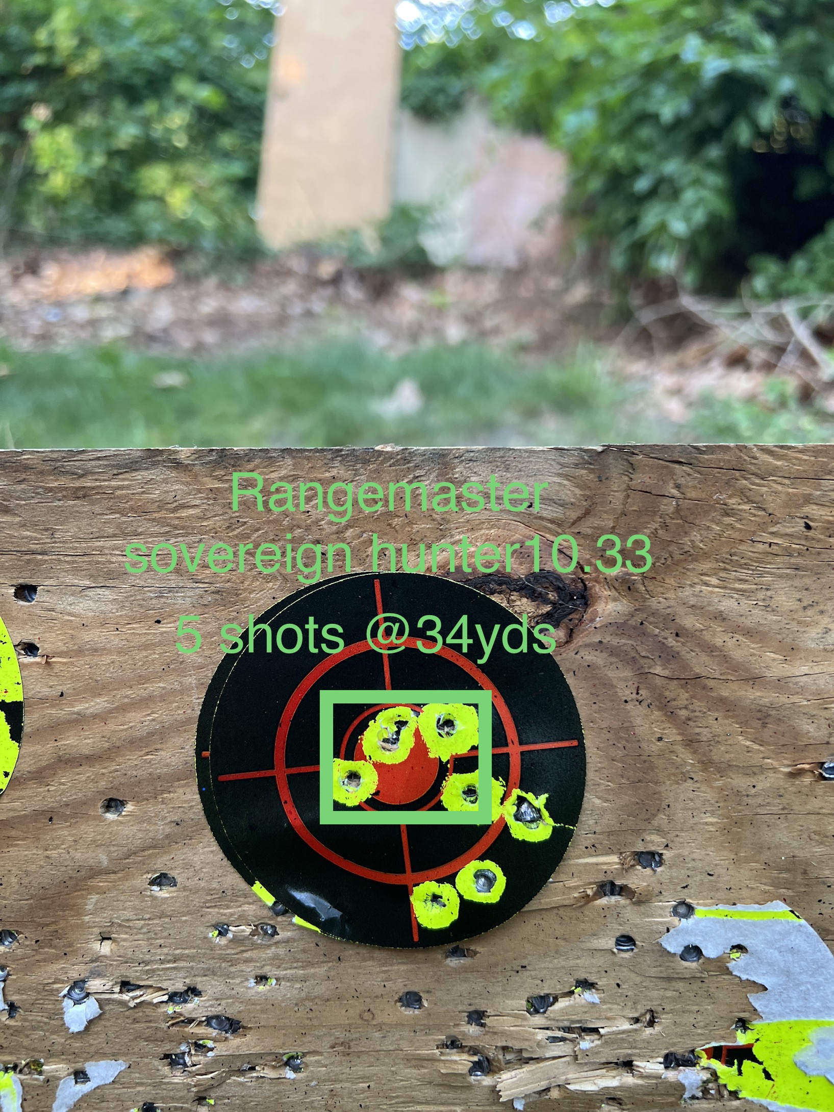

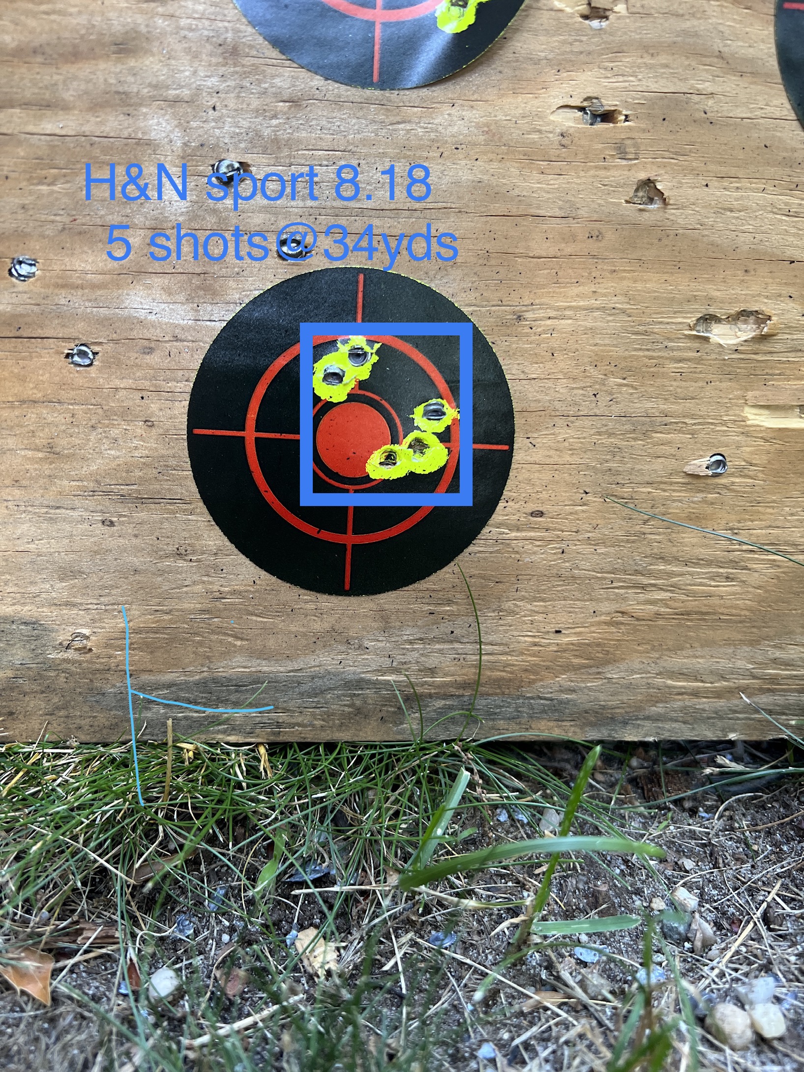

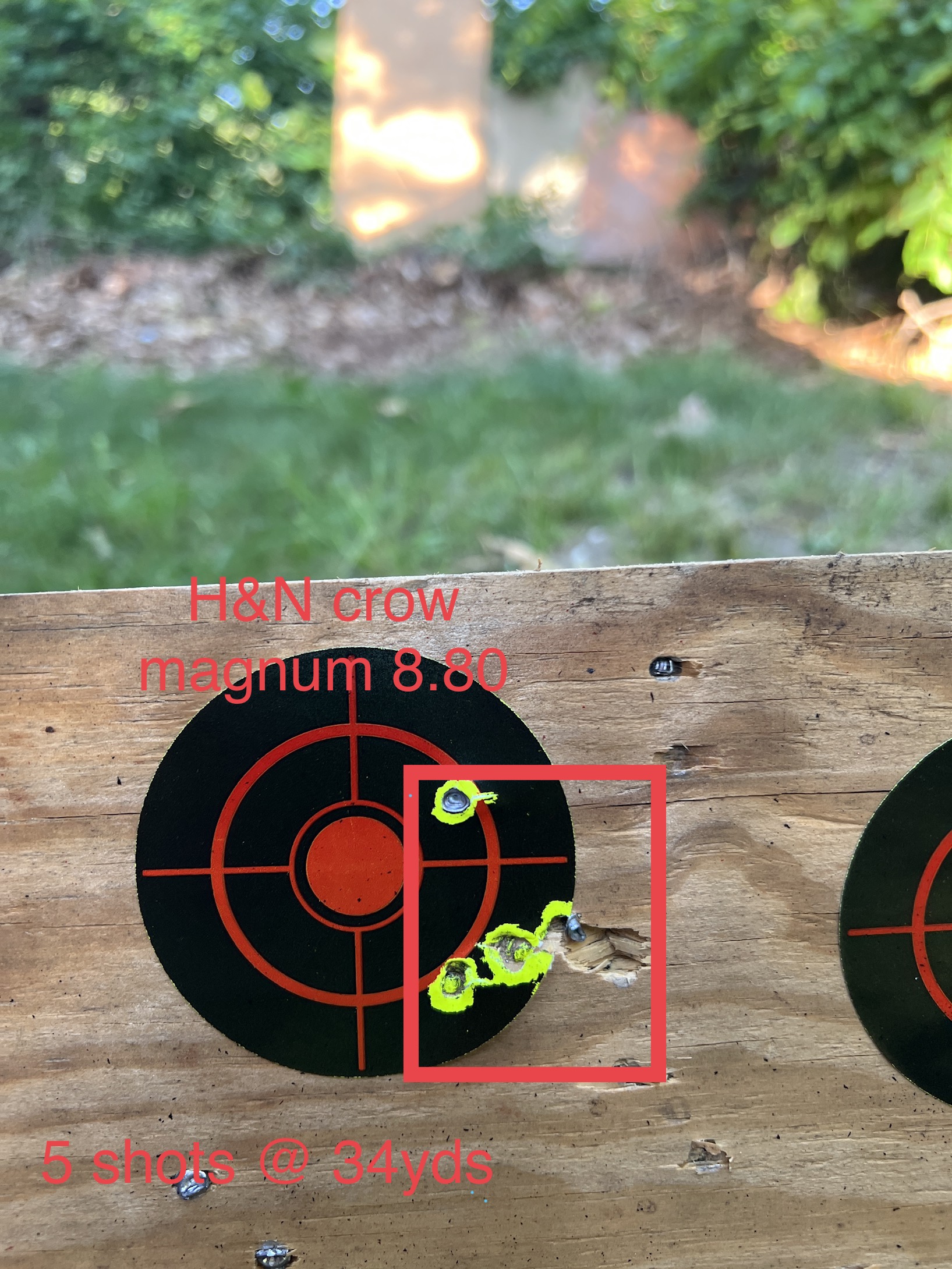

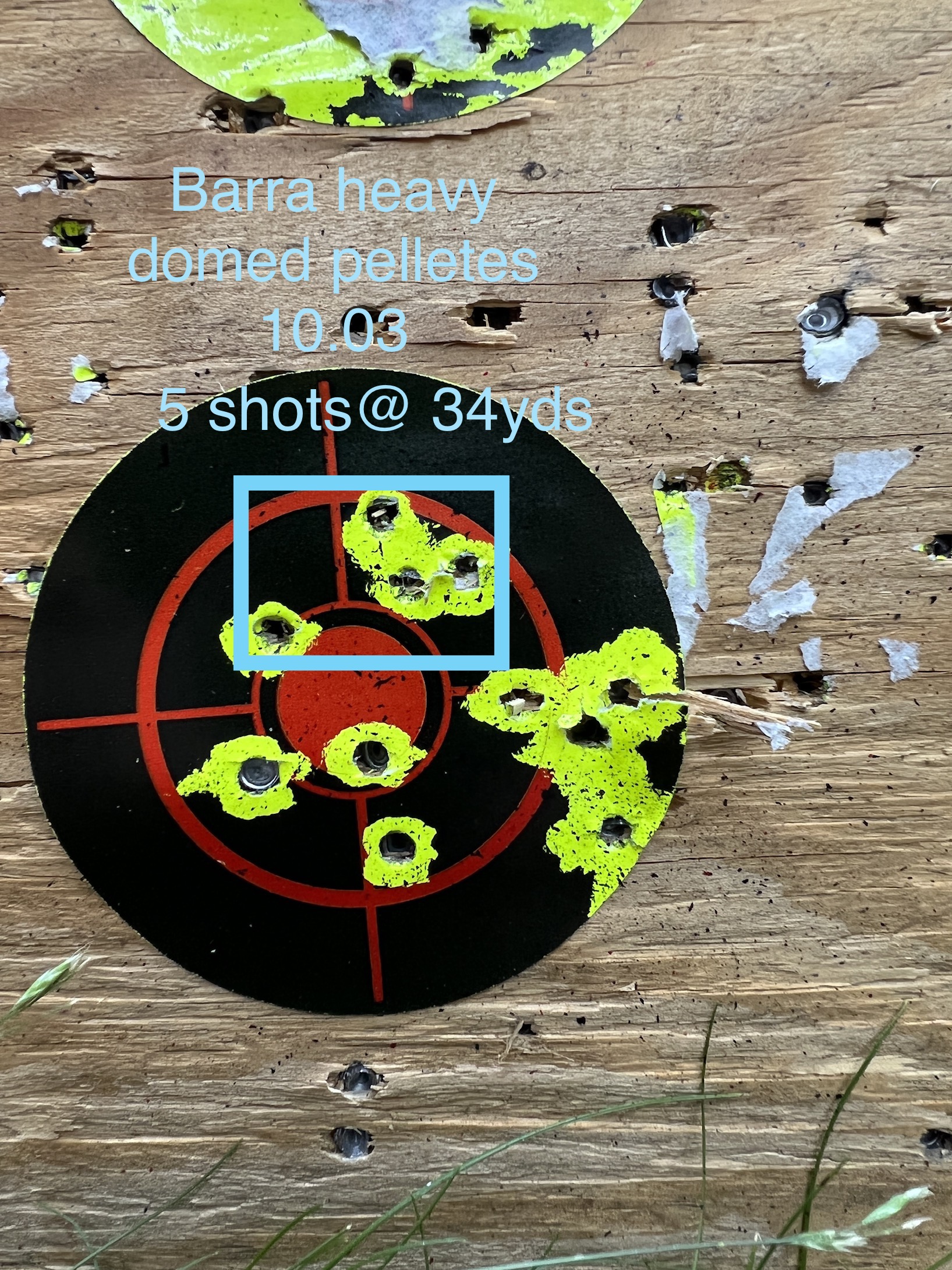

I just took some more drs group shots..
enjoy.
and yeah the wind out here pretty decent…
DA41F6DF-5D7E-4383-9B89-AF3381463334.jpegD22CCD76-665F-47E6-8130-EDC46A11089C.jpeg814DDE7B-3900-40E4-8FEC-53D9C5ED6AC9.jpegE873F250-5B3E-401E-9189-F72662FA7203.jpeg27F505FA-5408-4222-A3AB-2CB57654C689.jpeg3C5F5A97-C906-40BC-8A09-EBCB9A824936.jpeg923B8EEB-9259-4309-A8D6-D25A05E0E4D8.jpeg8F24EAD7-DD67-4E4C-861F-F9C6382AFBA9.jpeg
Jumping around with different pellets isn't going to give you your best groups . If one is showing promise stick with it for 20-30 rounds and judge it from there. It should be set up for 10.3-10.5gr pellets. I would think.

I would be frustrated with that as well. Get that fear of tuning behind you and start fiddling with it. You will not break it.
Watch some of Steve's video about tuning as it will help you a lot. Here is one but some of his other videos also explain it well.

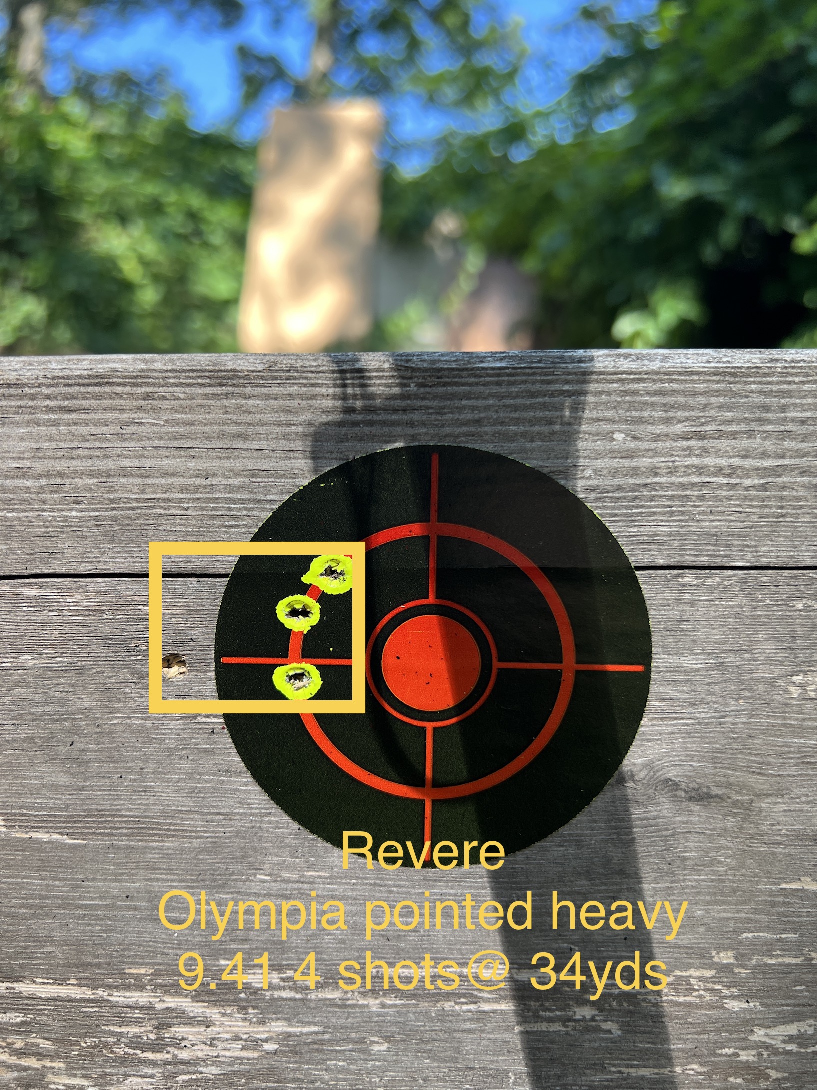

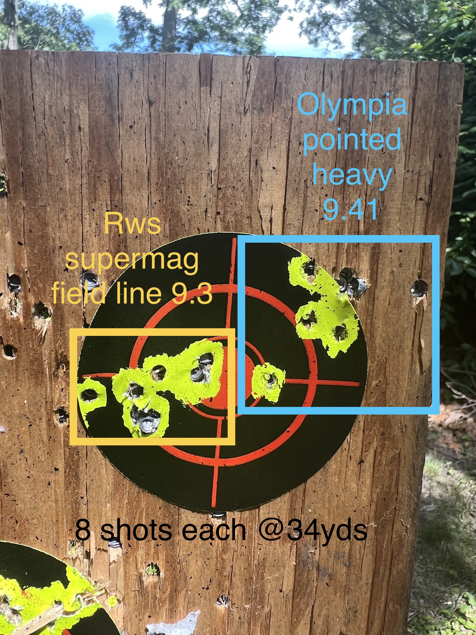

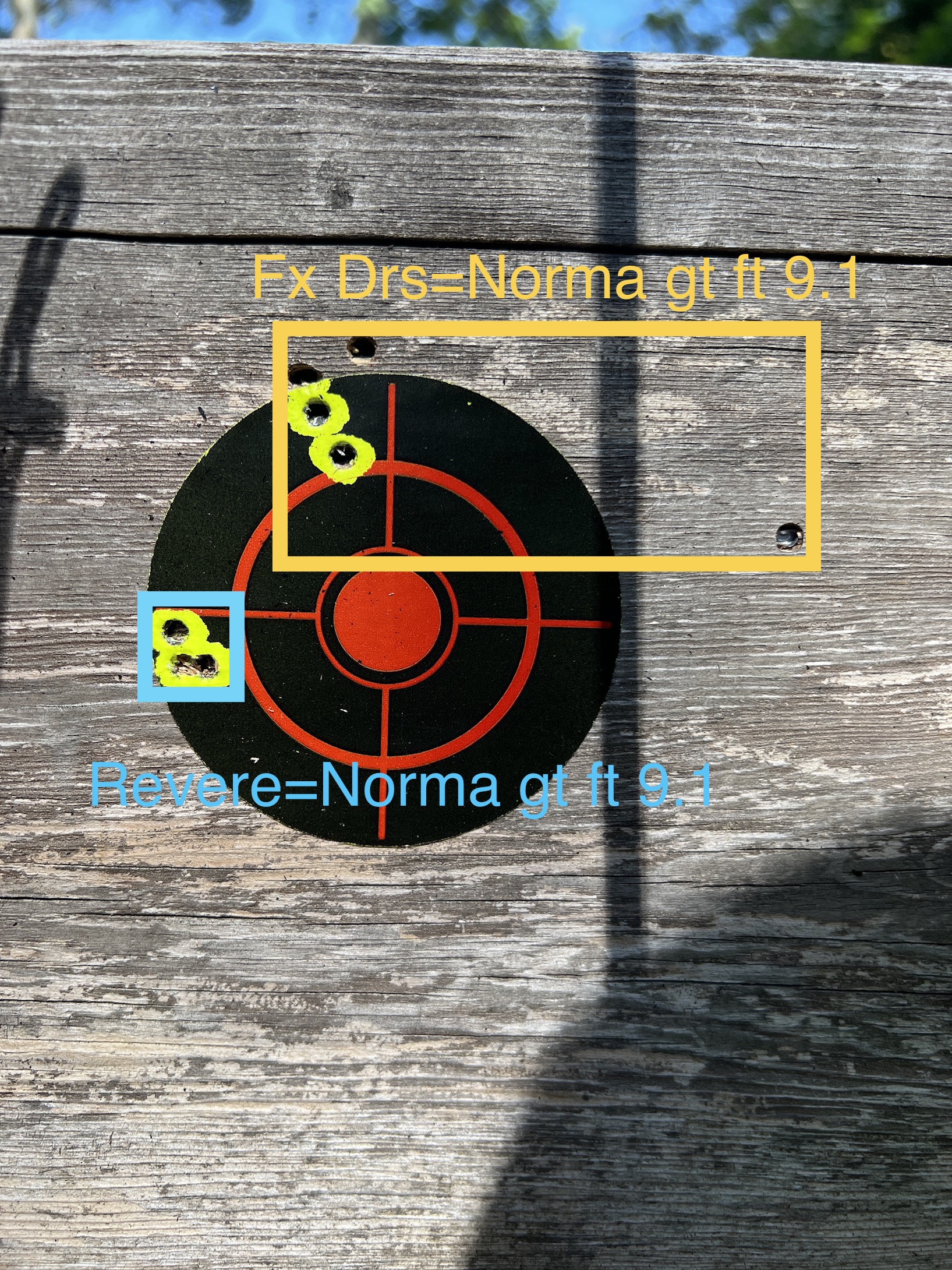

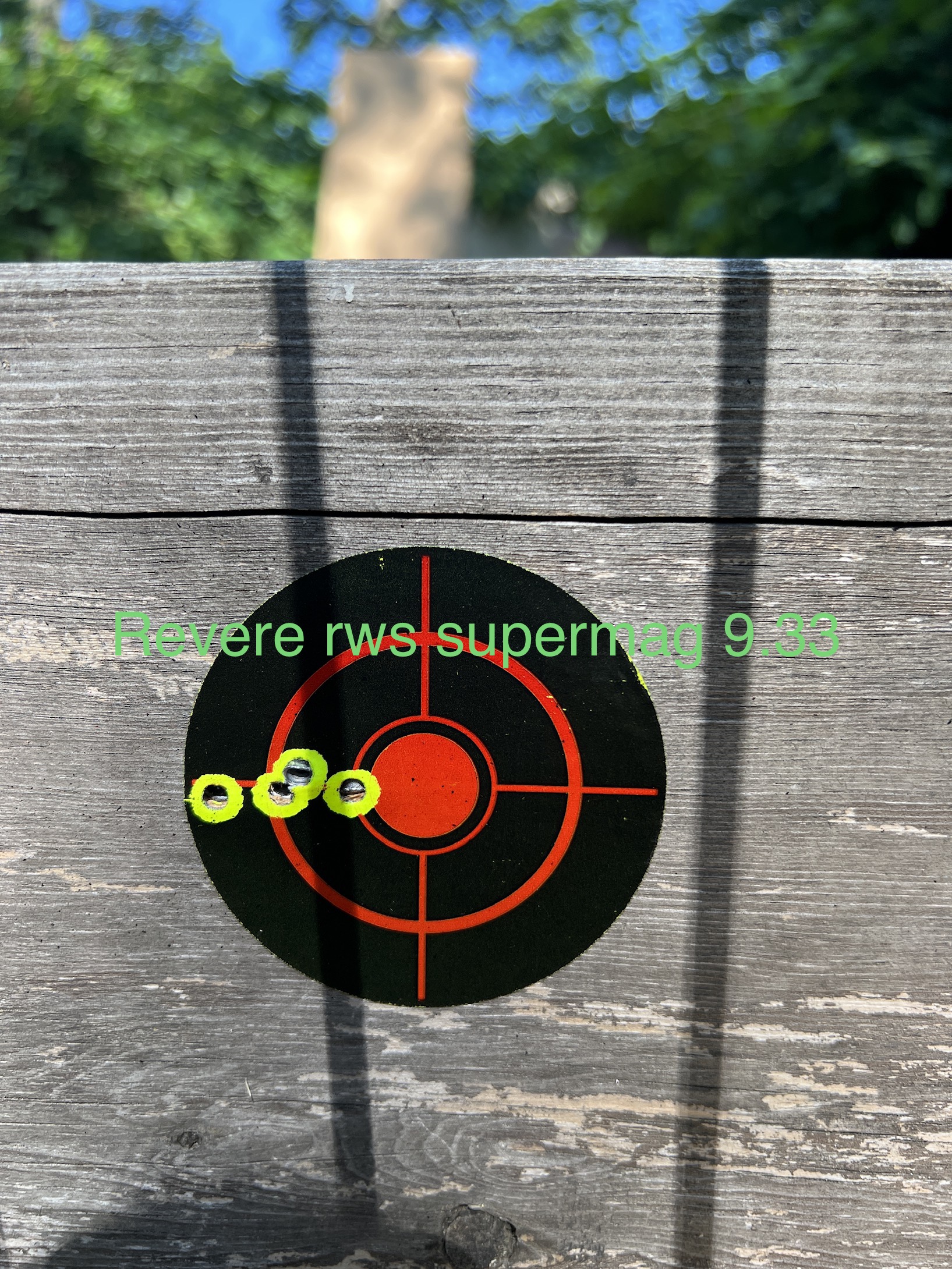

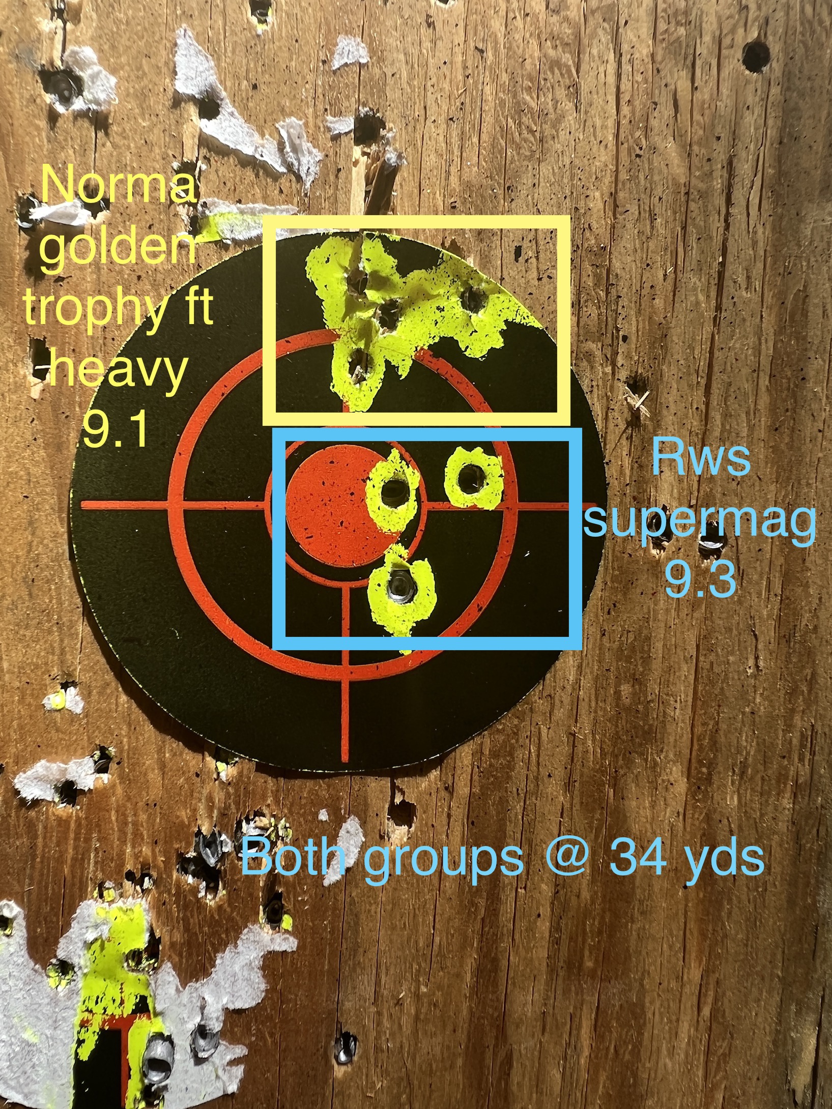

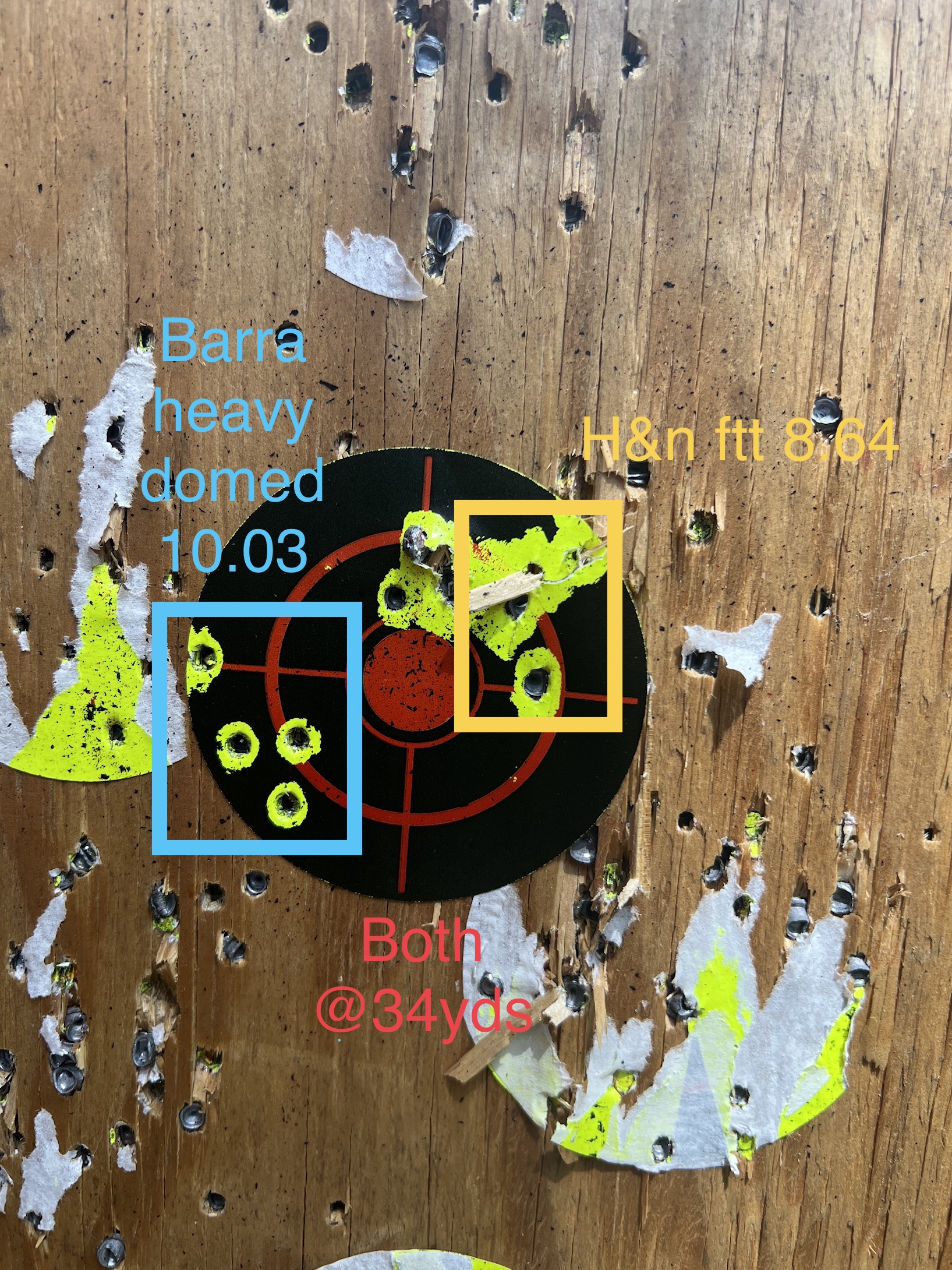

Some revere vs drs shots somparrison as u asked sir!!!6F8A1CDD-F8B1-4669-B711-FBCFEC3AB206.jpeg0DC9A858-4768-4E36-98D5-E4C2B6BA526F.jpegD1825D65-D61F-4D08-A8B3-47364996ADD5.jpeg9902147D-0C77-4360-A07B-82B96196507E.jpegA98541BF-2D1E-40B6-8462-A52B29FF6CDF.jpeg
