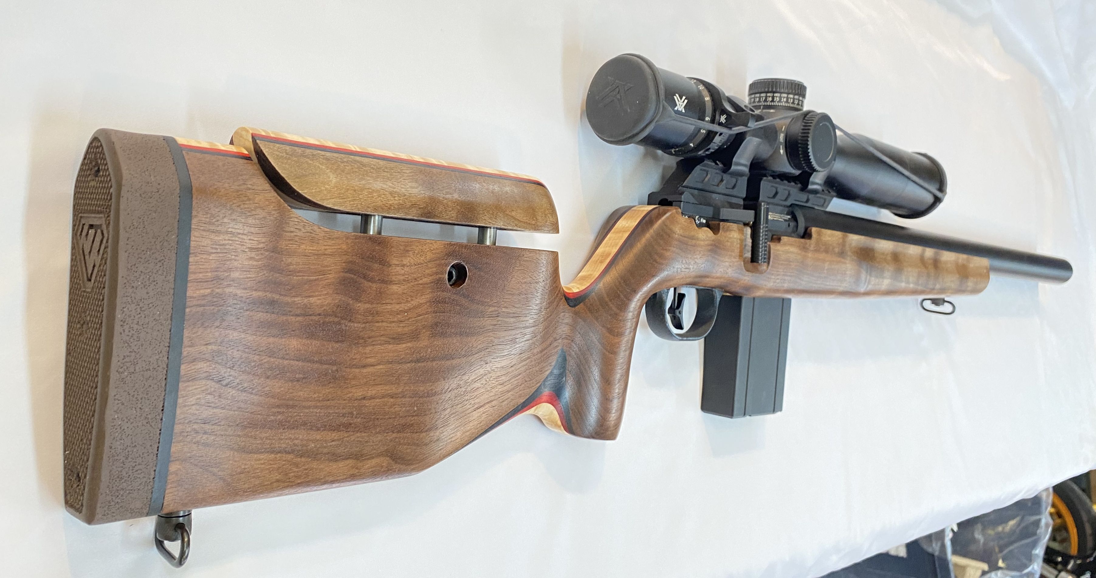

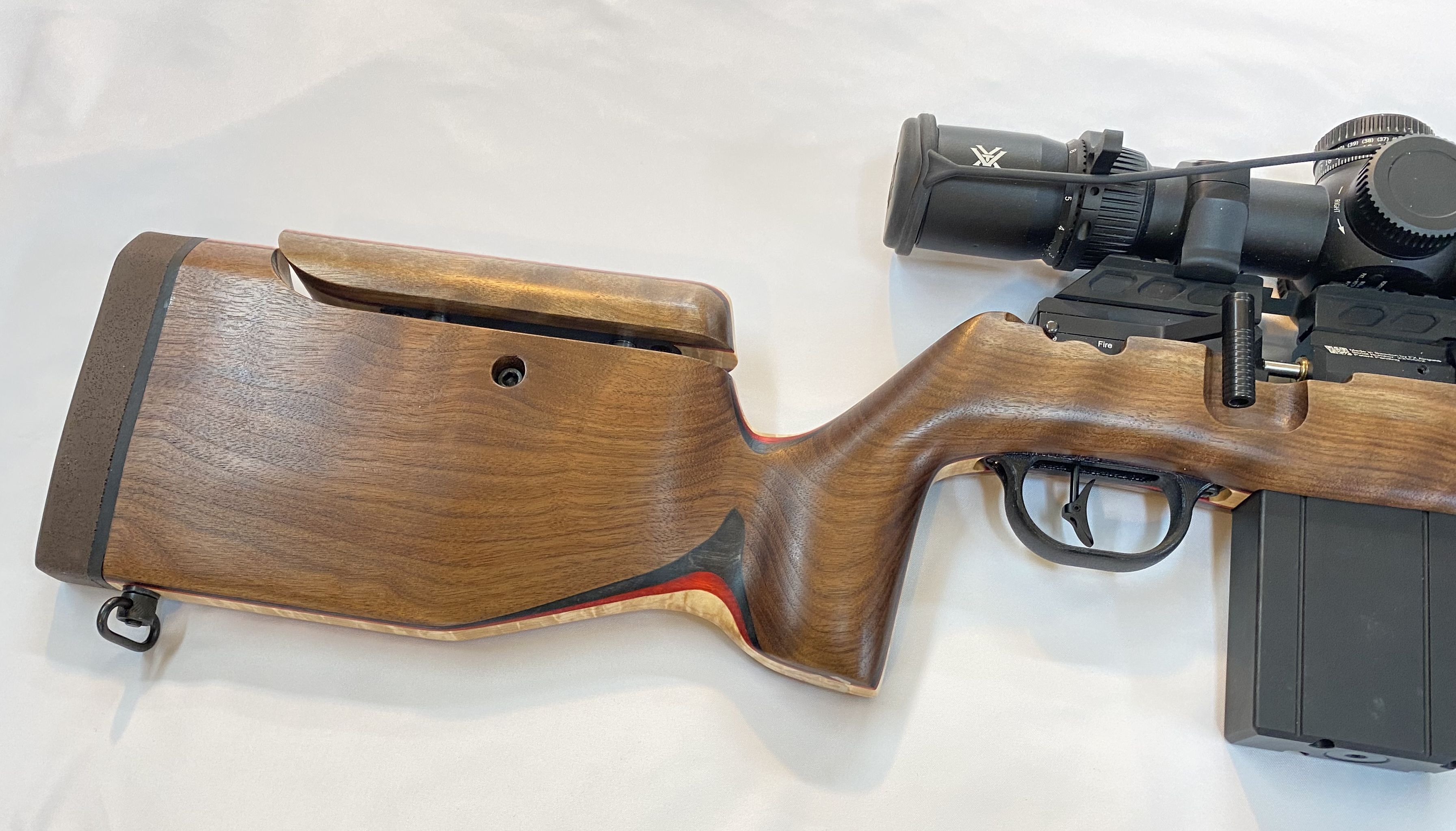

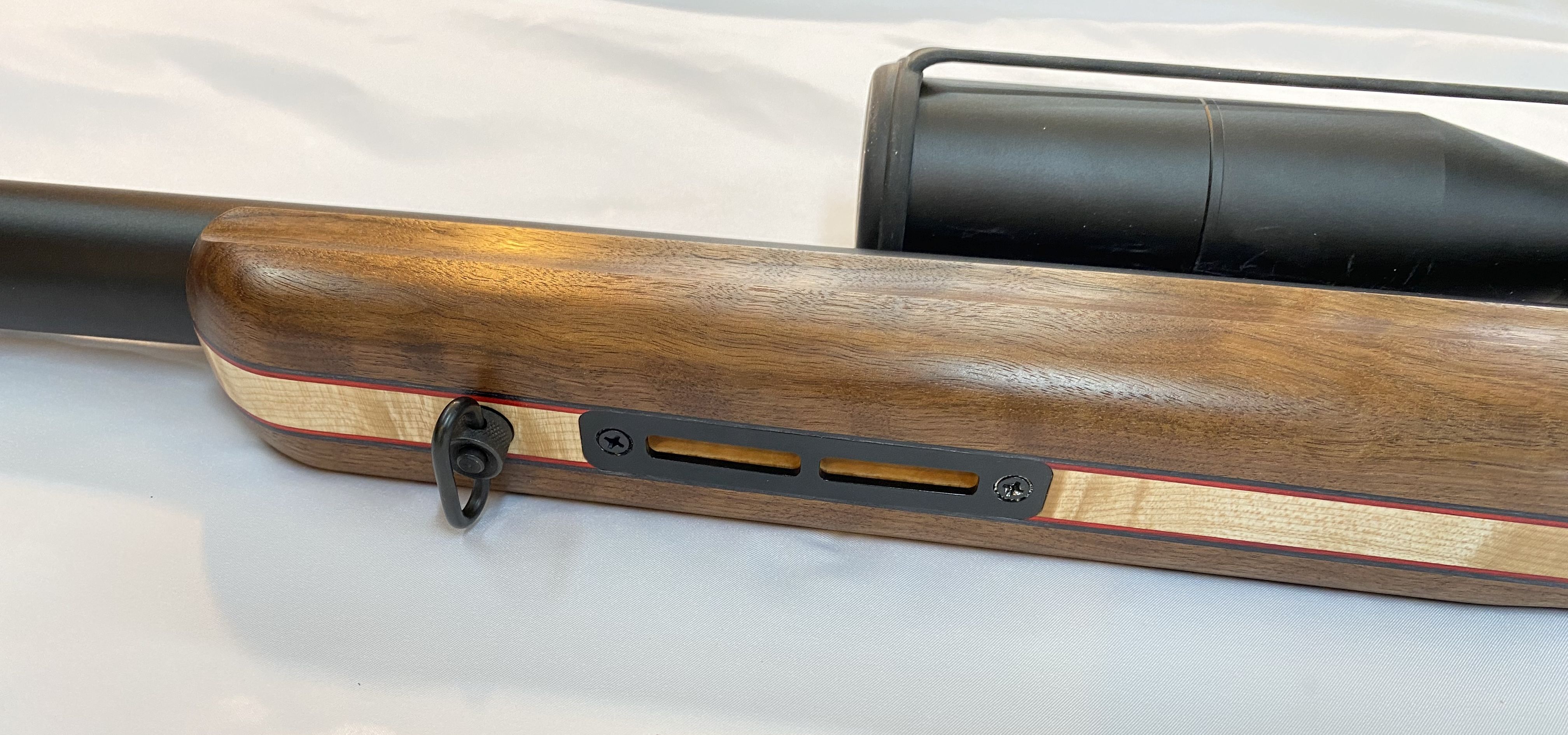

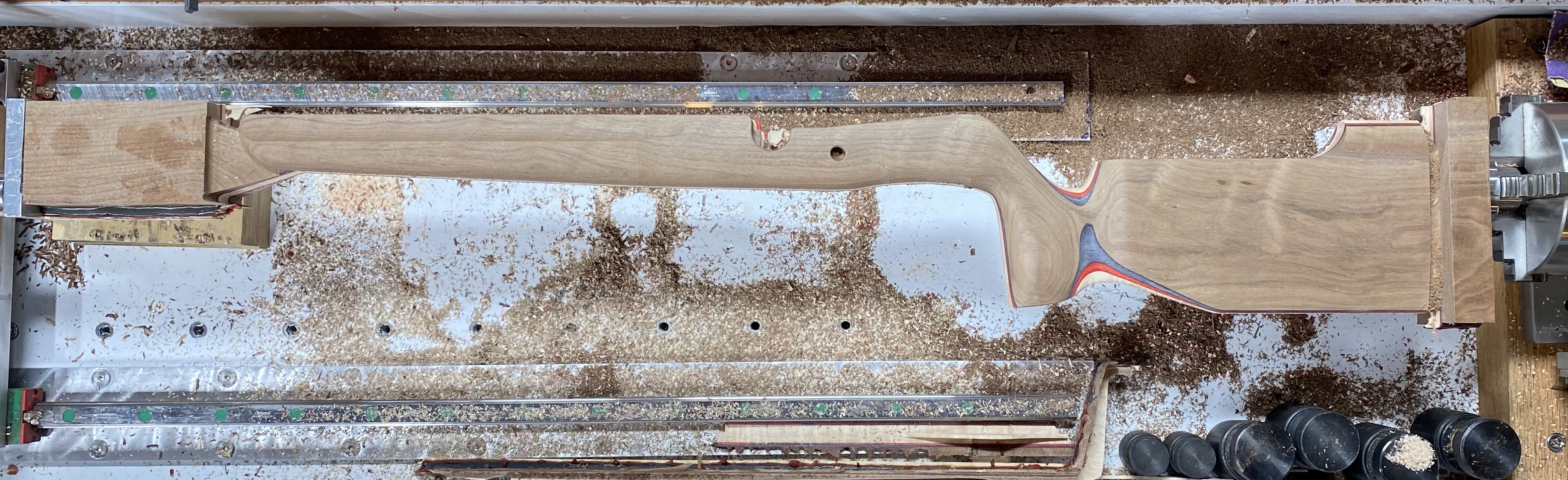

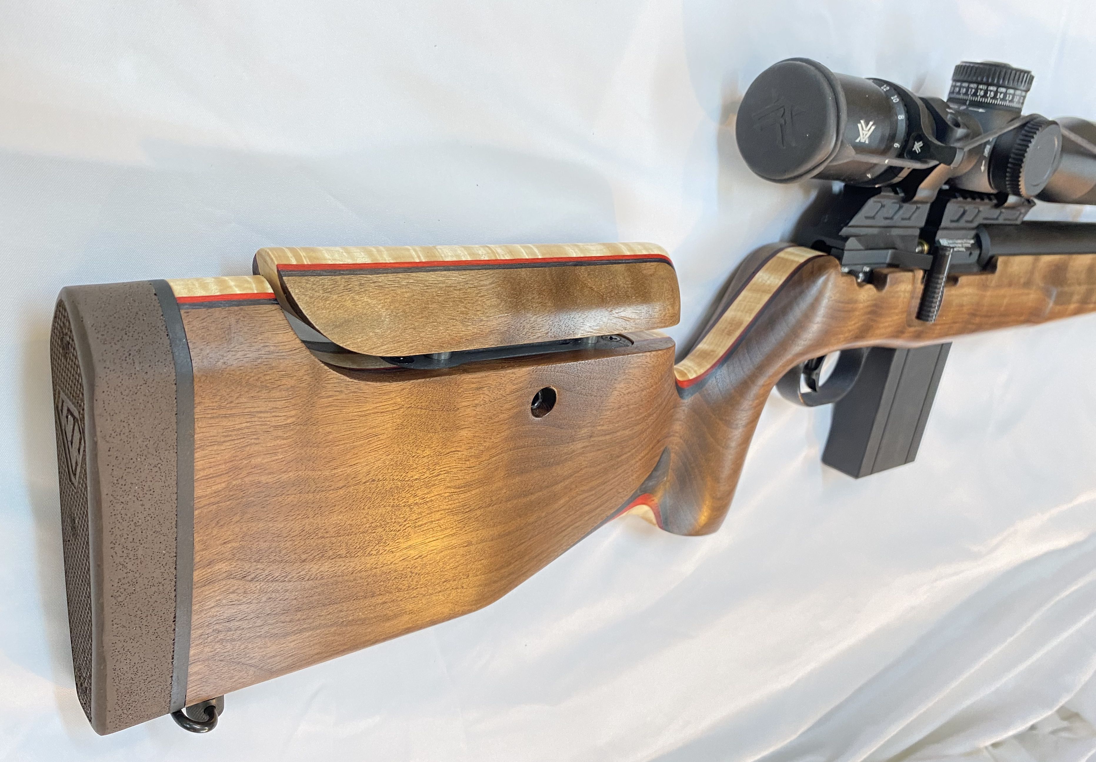

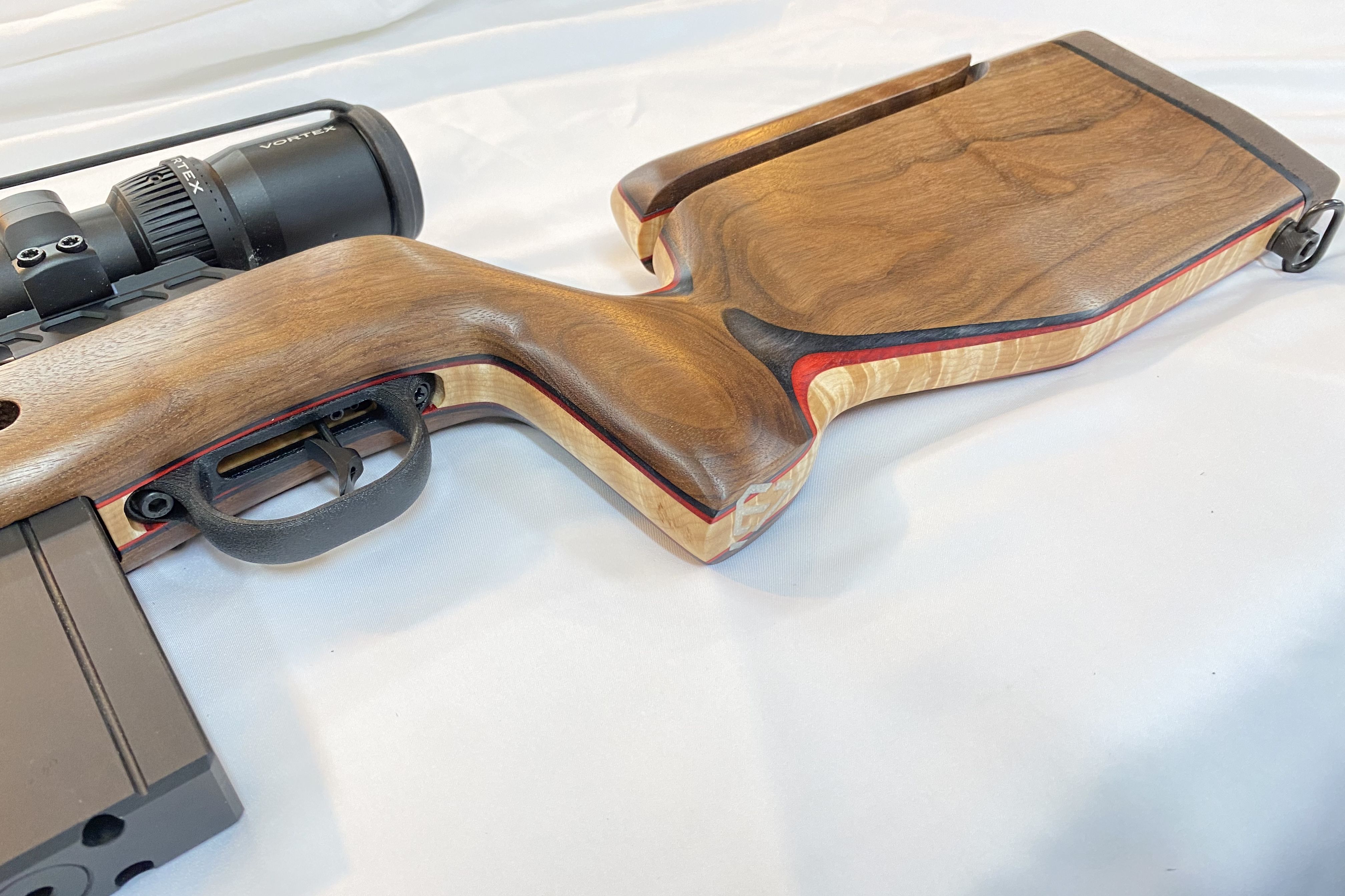

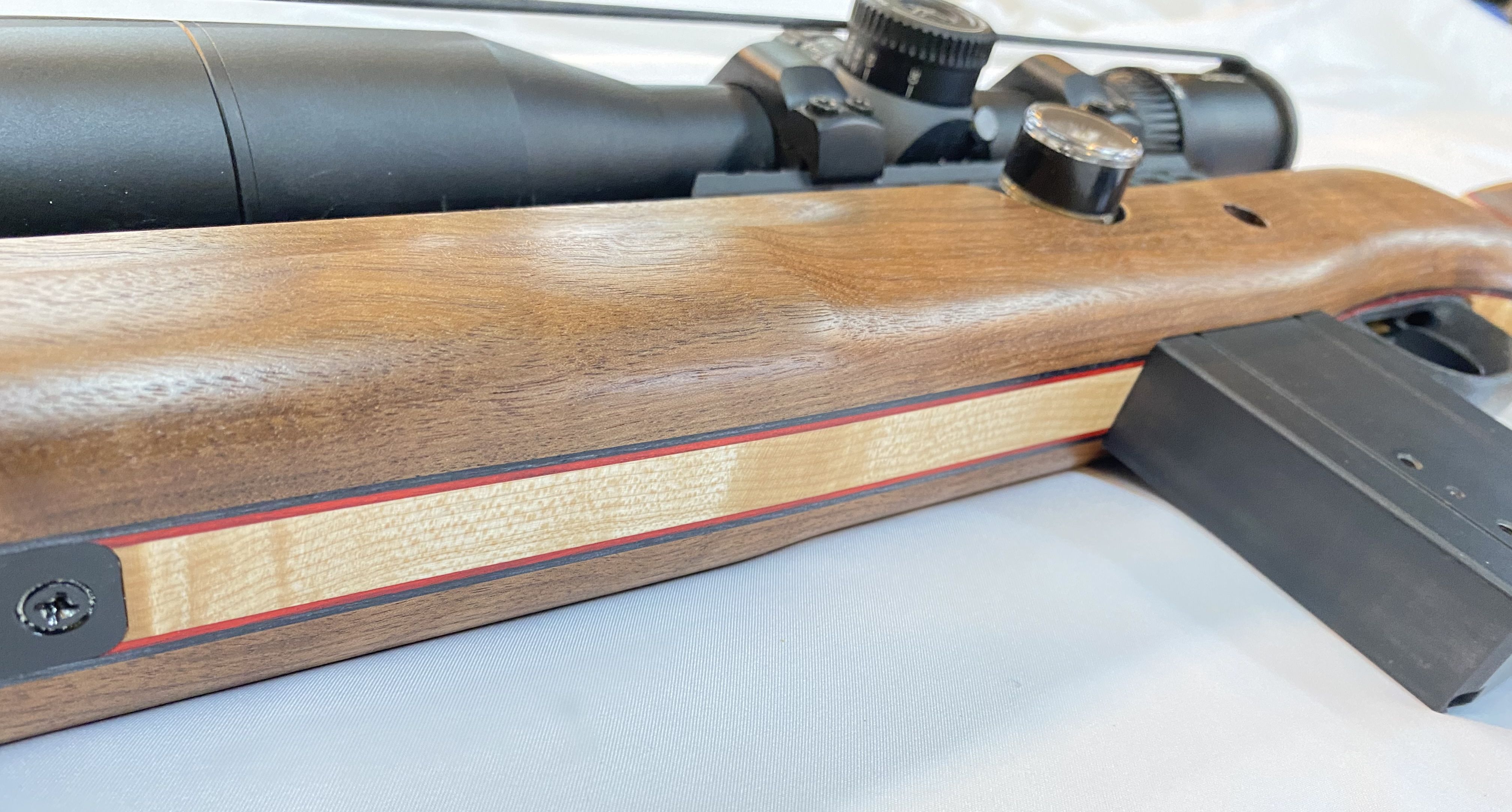

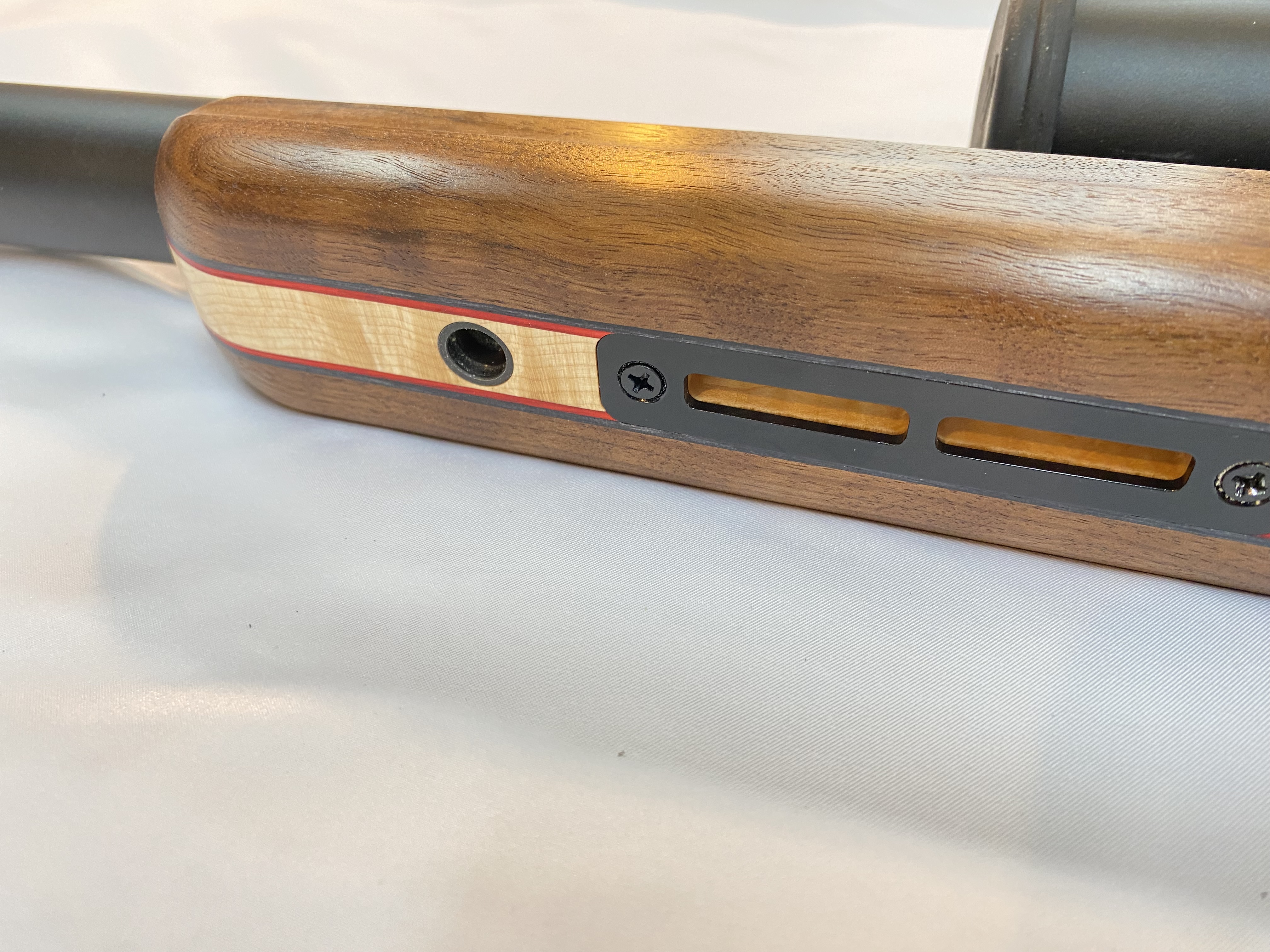

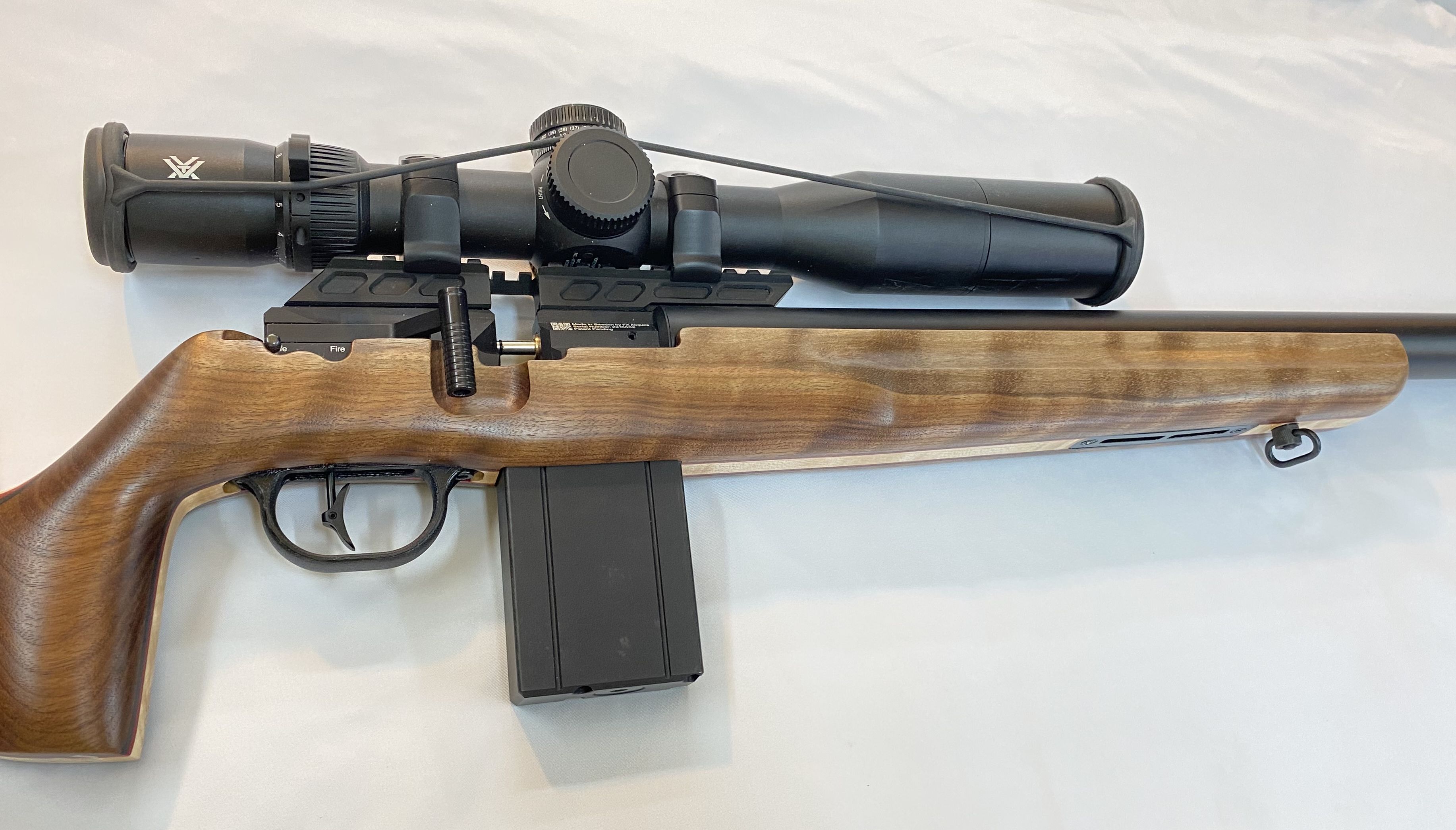

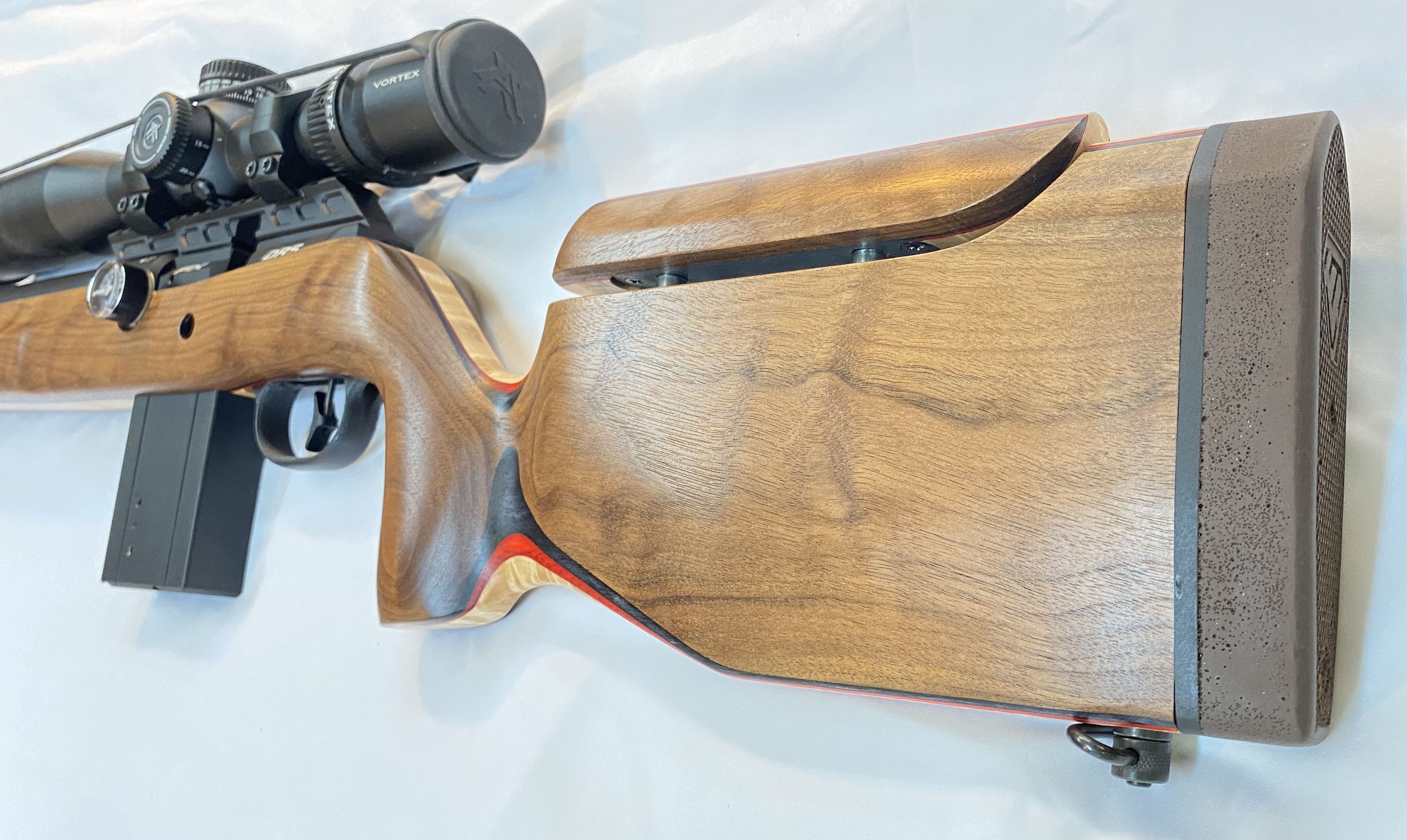

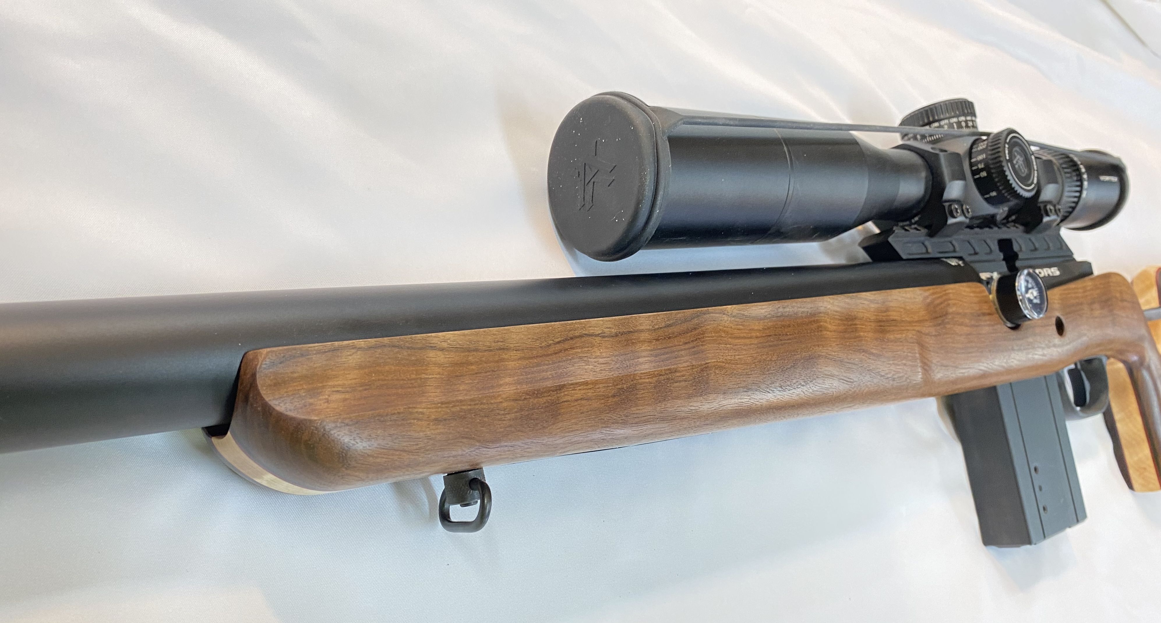

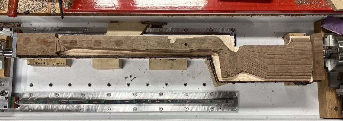

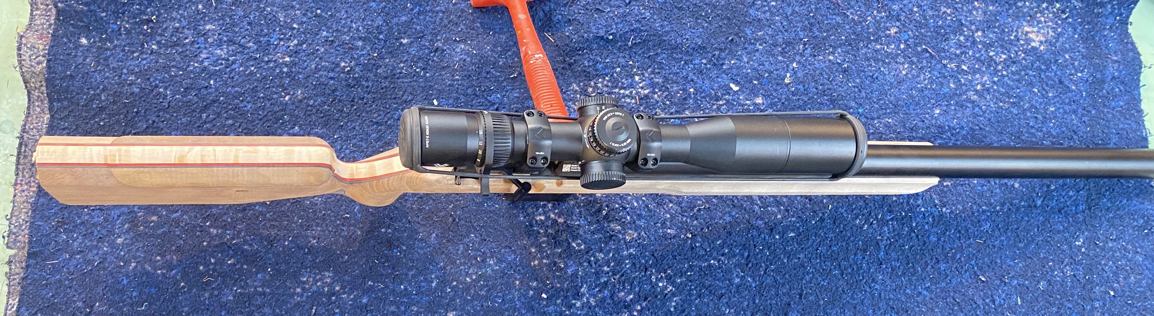

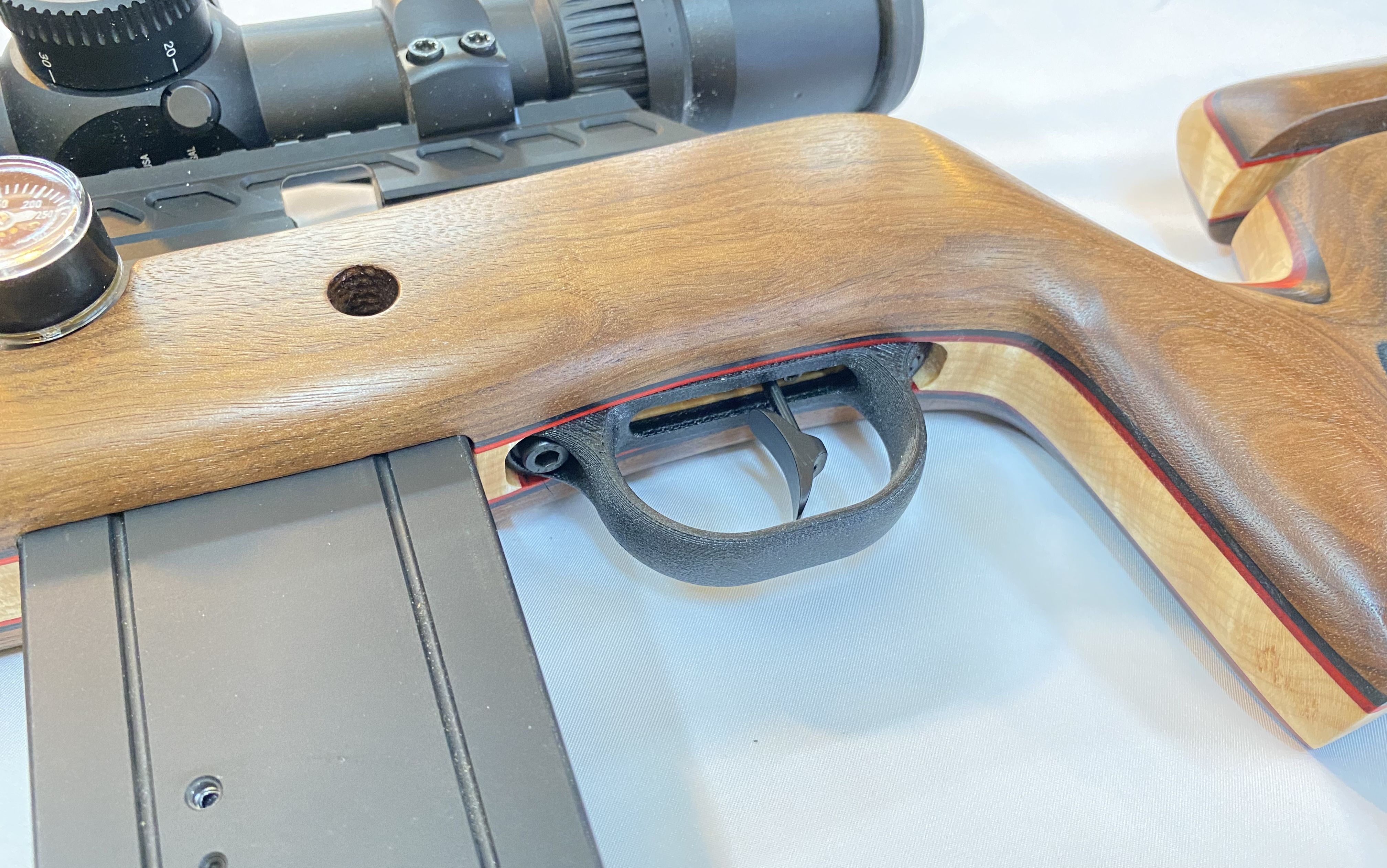

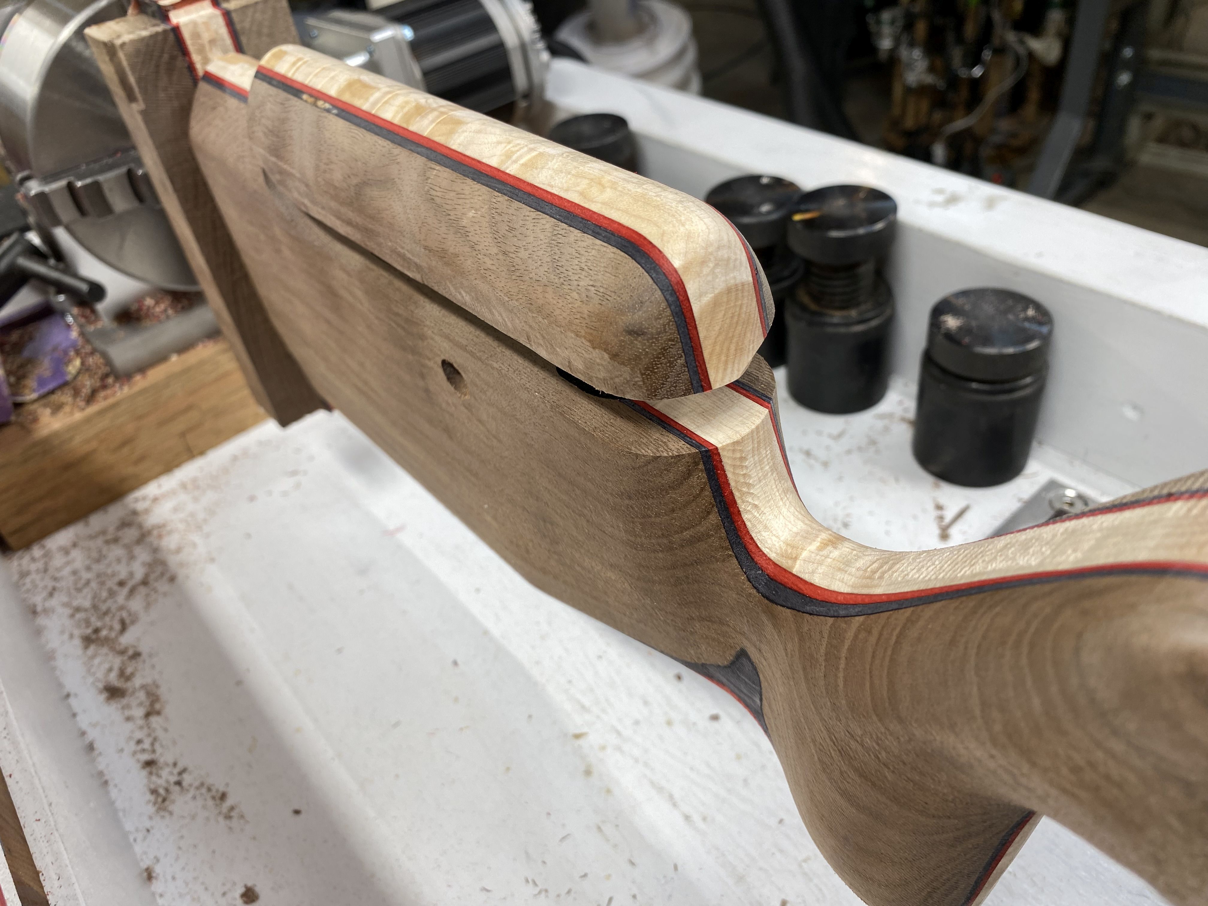

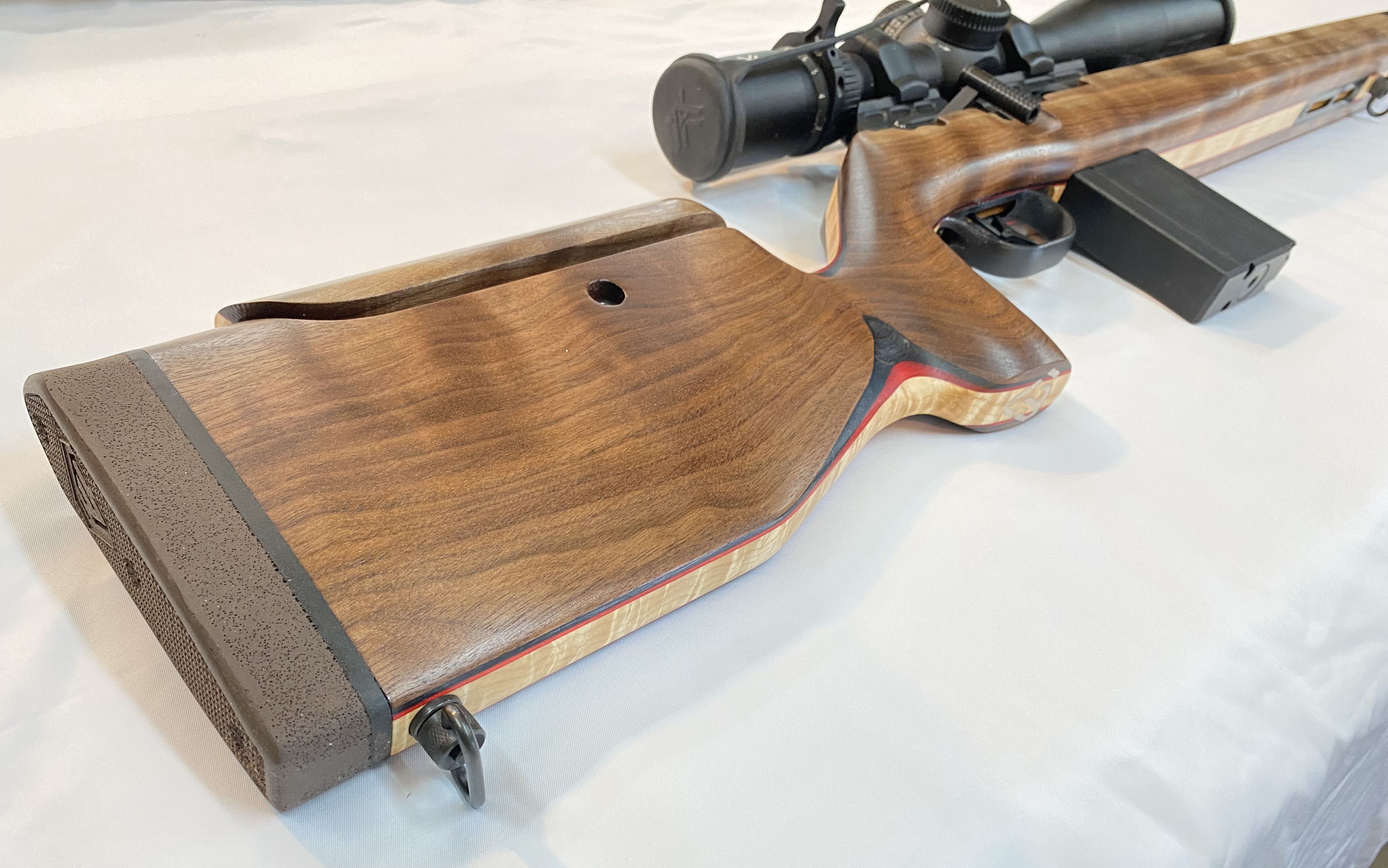

Thanks. Always a million design options to consider for all kinds of shooting styles.Wow you do some really nice work. Personally I would ditch the forend finger grooves and go with either a rounded or angled section instead. Less machine time and I think it looks so much cleaner that way, finger grooves never fit anyway.
ETA: I would also trim the top edge of the forend to a rearward angle, and give the forend less taper like a Manners stock. The rear stock angle could also be stretched out further to allow better fit on rear bag, and give finer elevation adjustment.

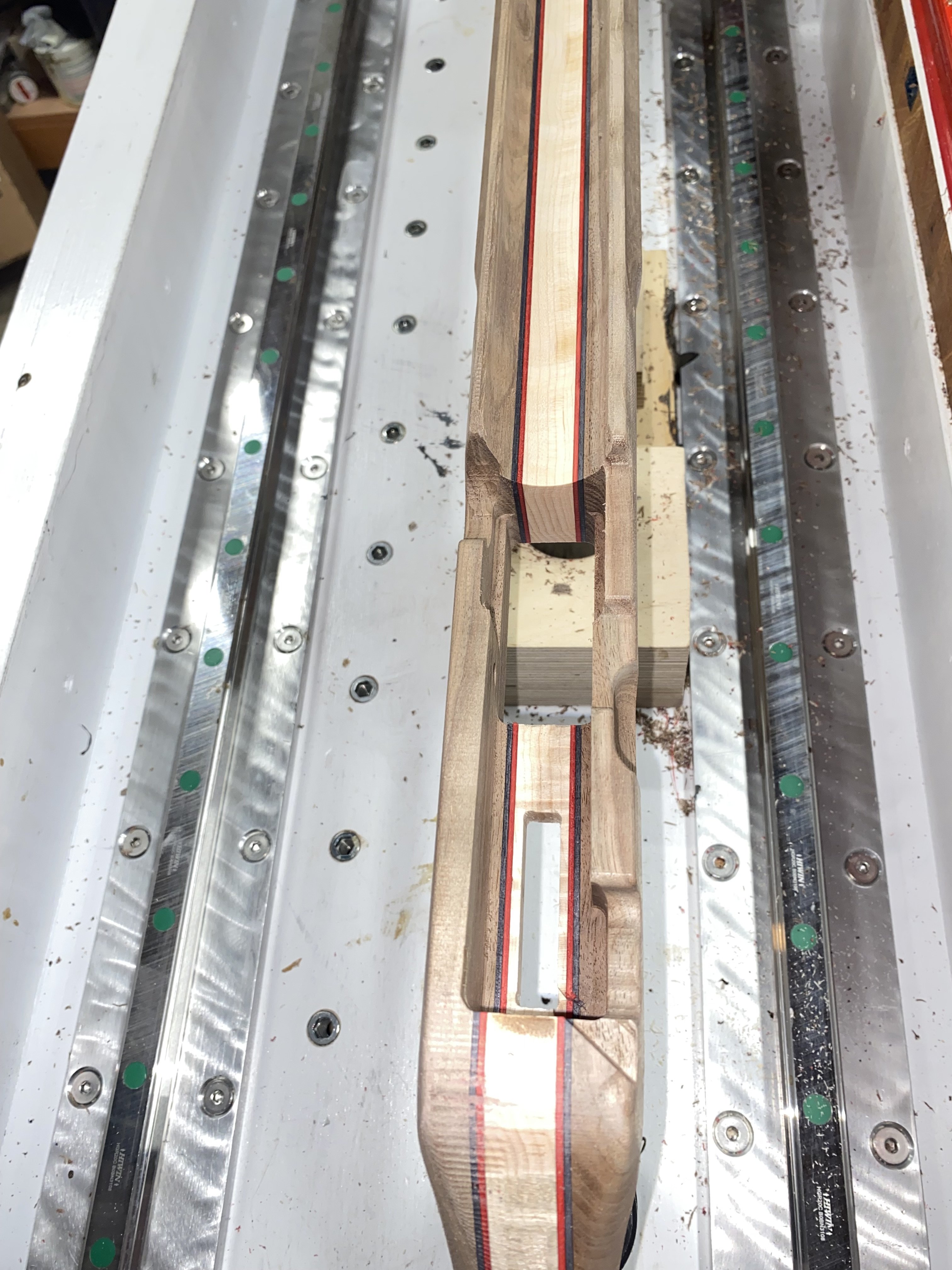

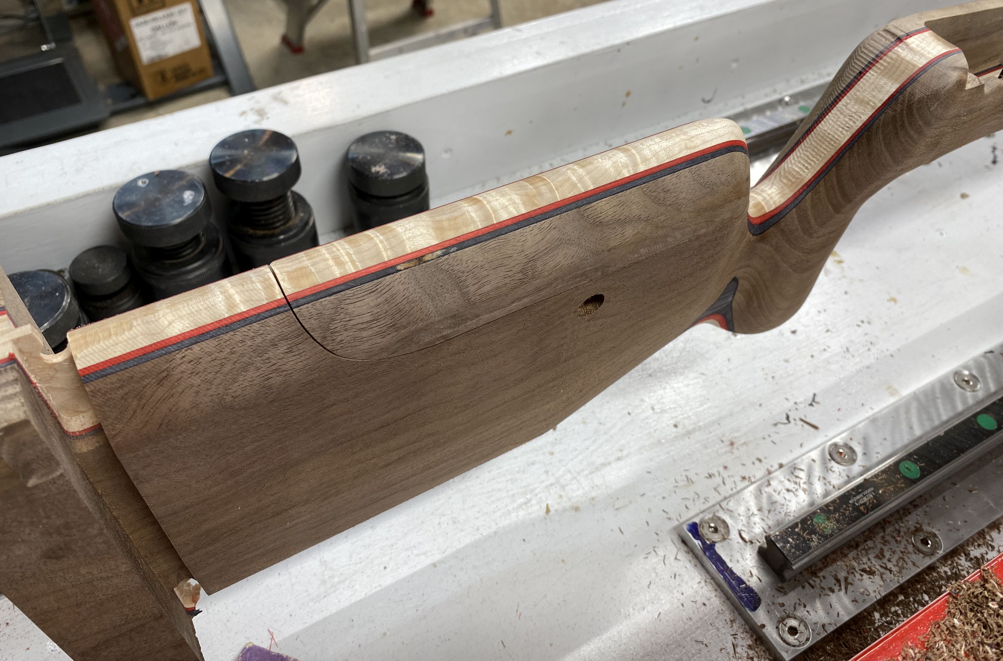

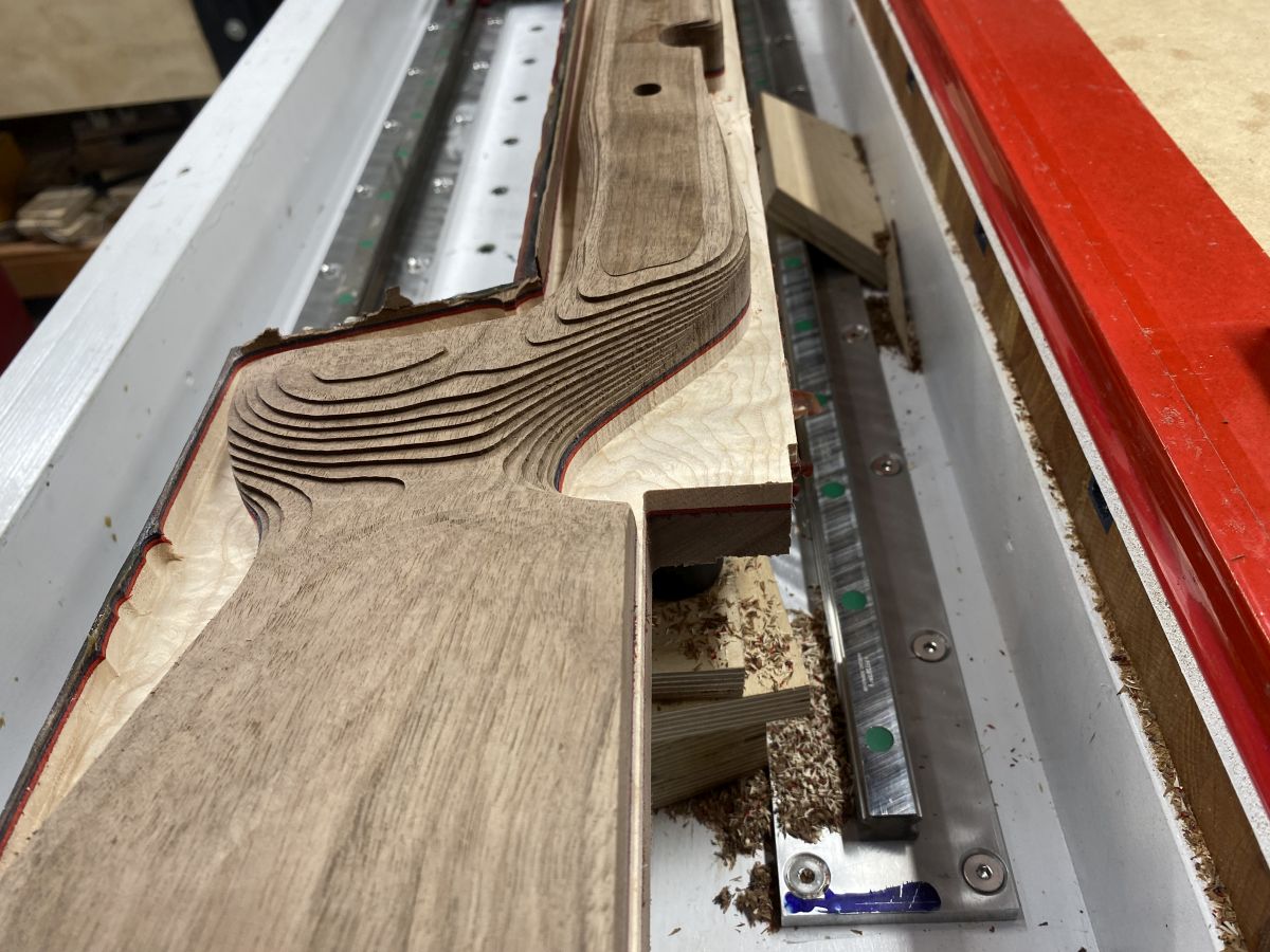

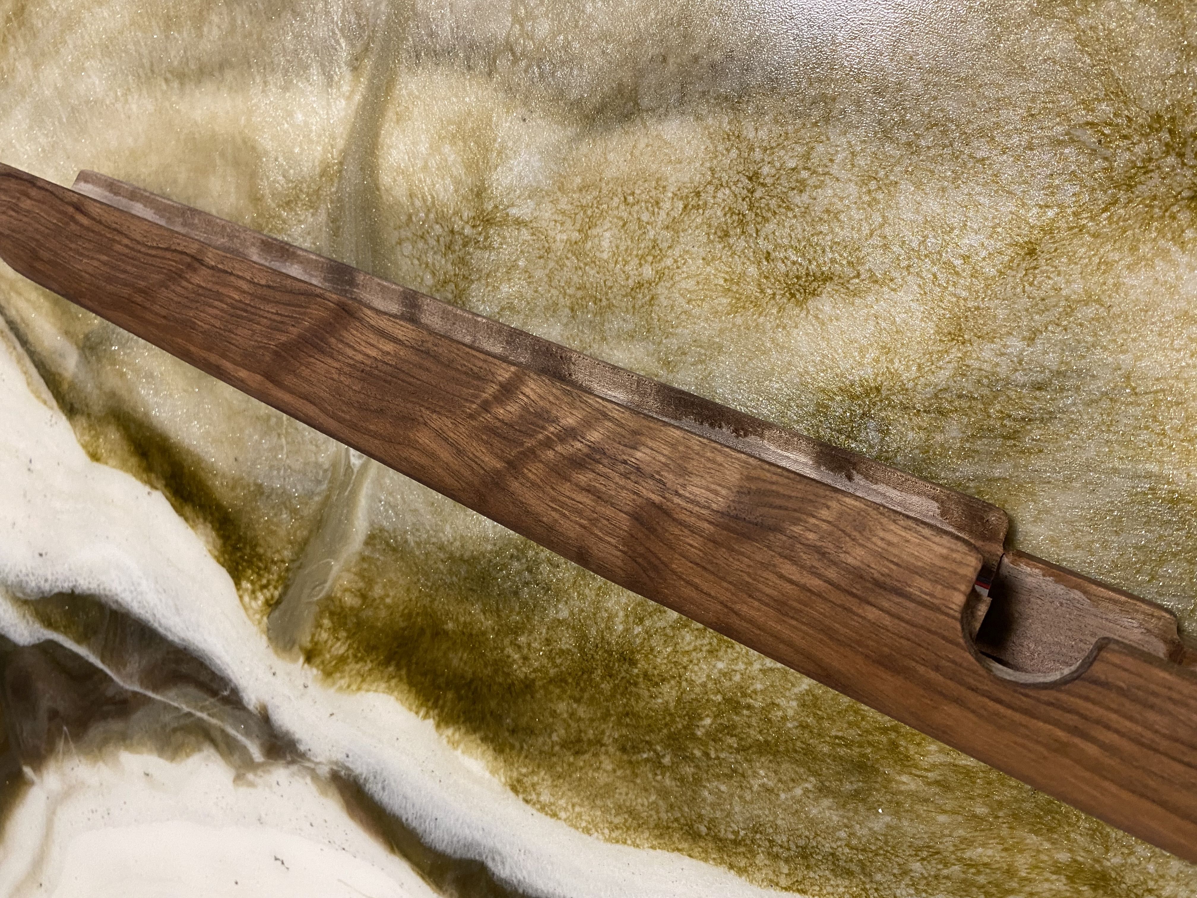

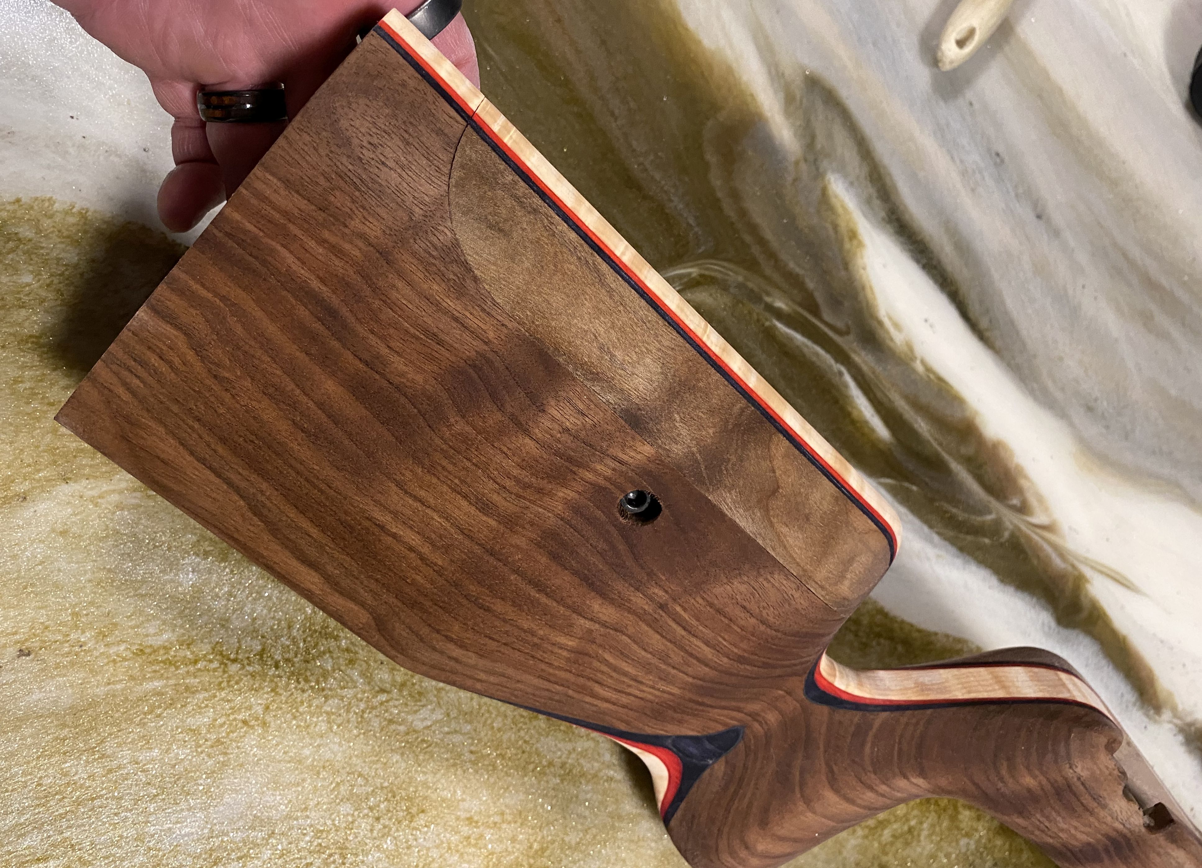

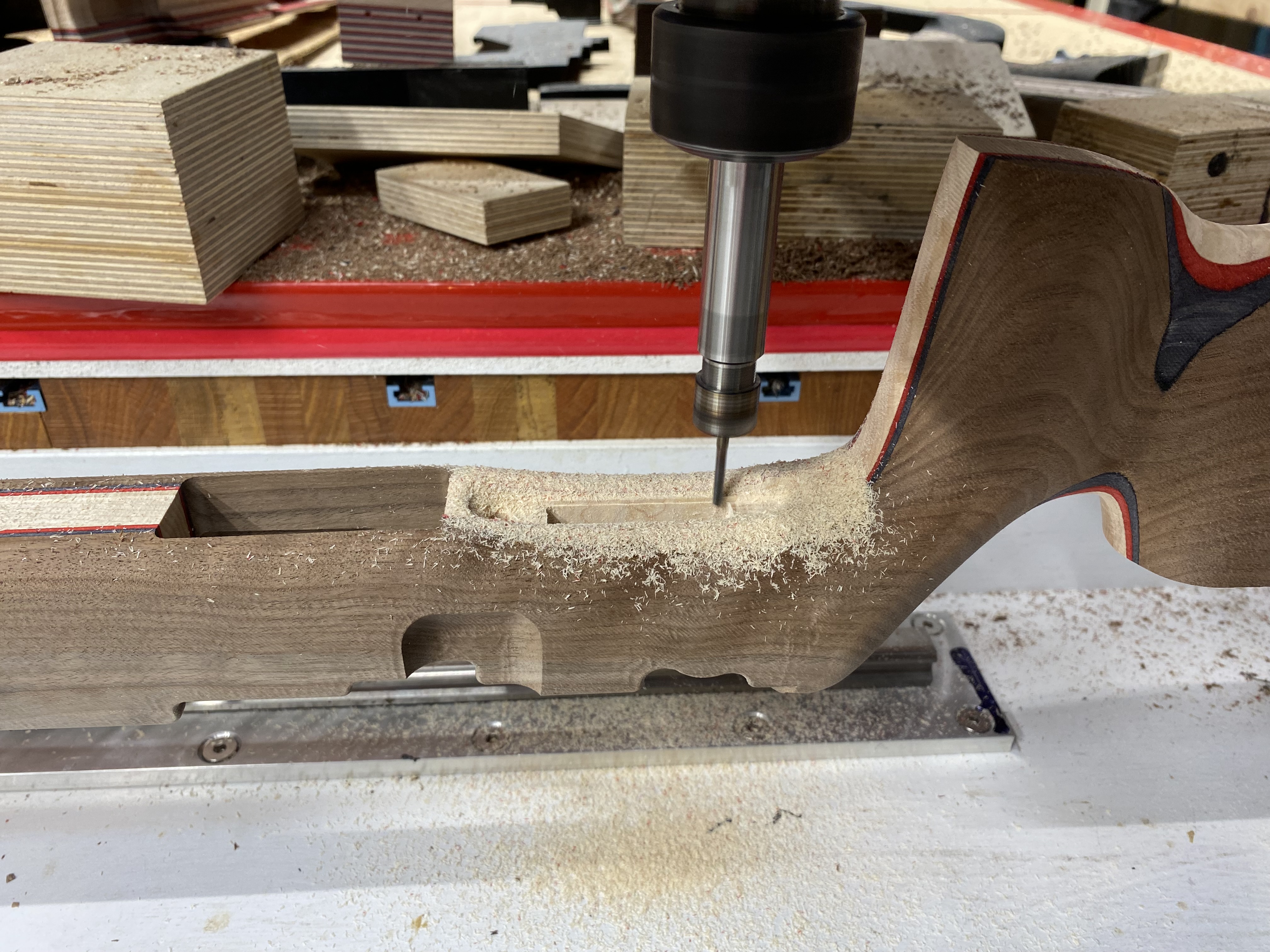

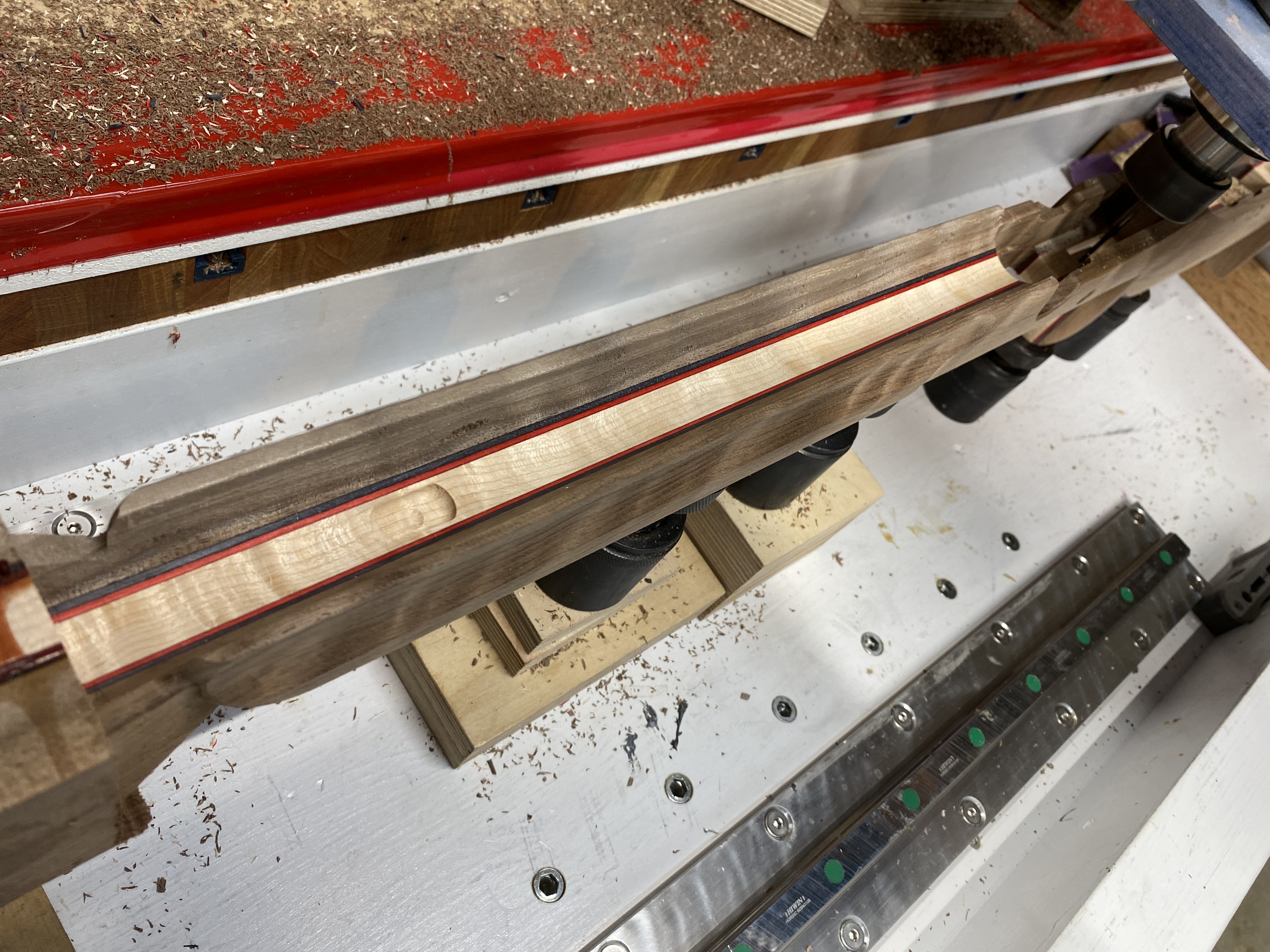

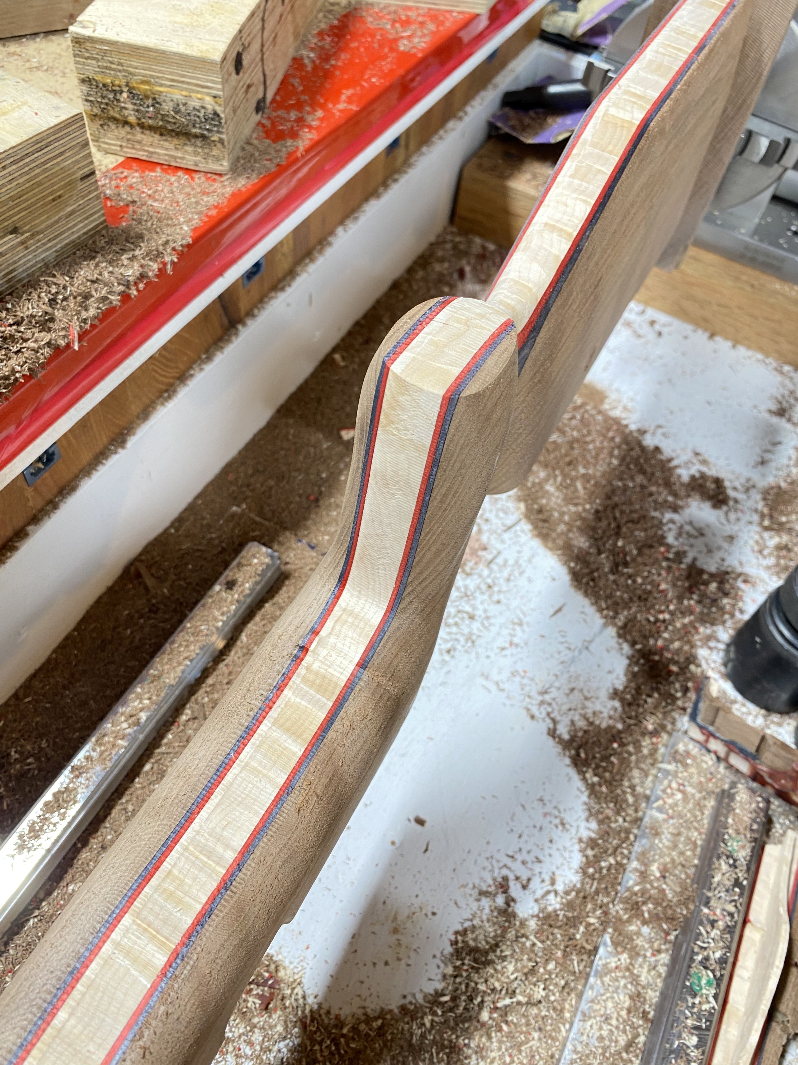

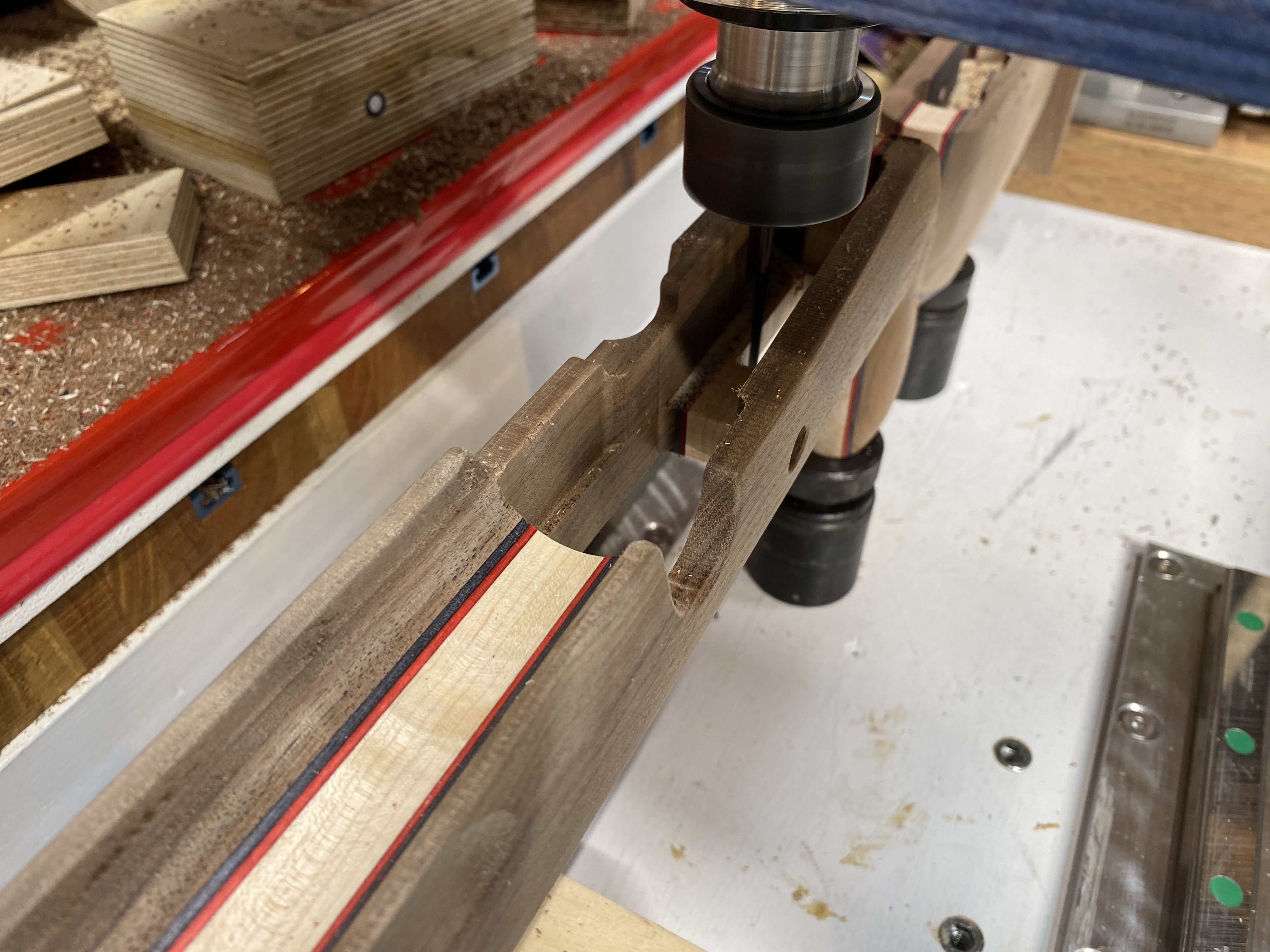

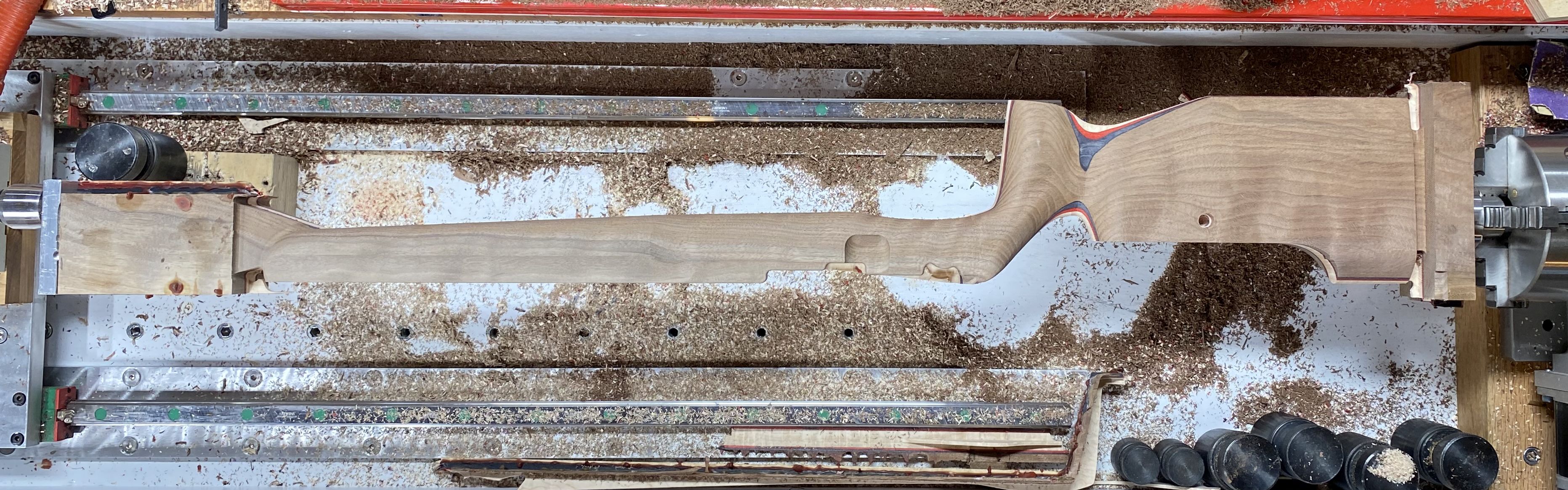

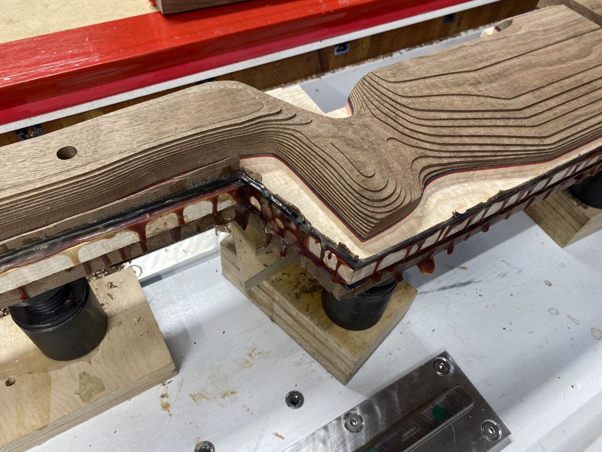

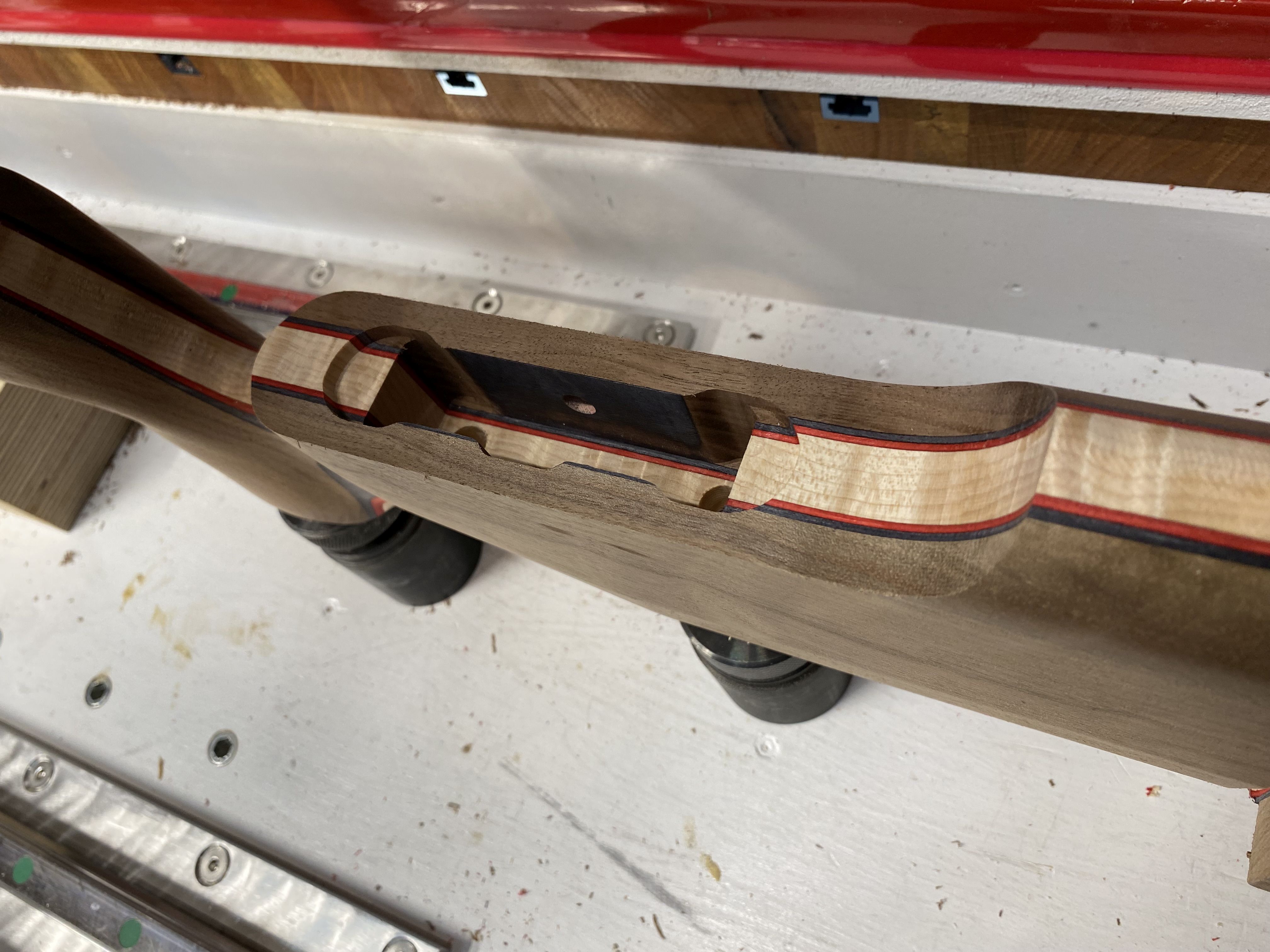

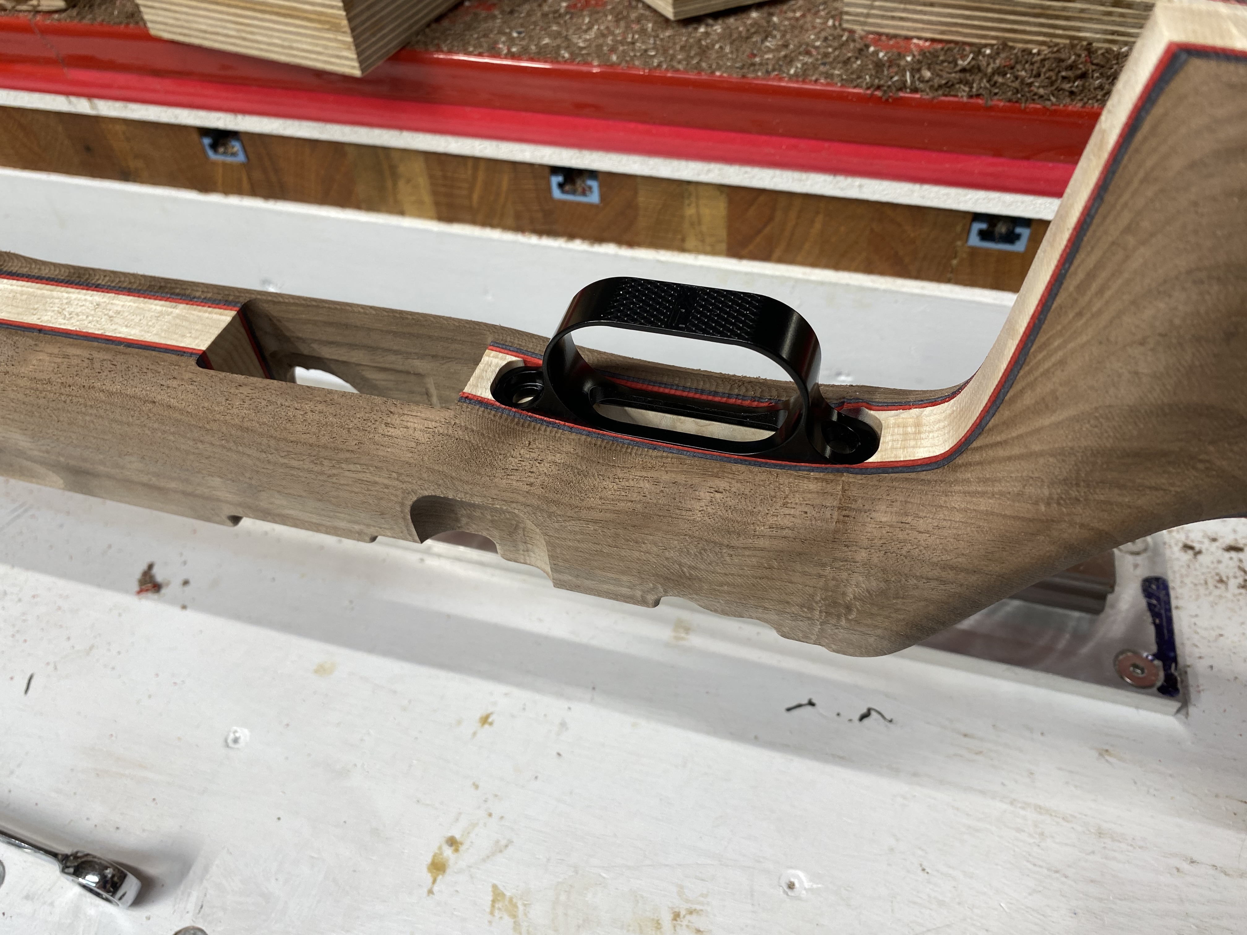

Side one roughed out.
