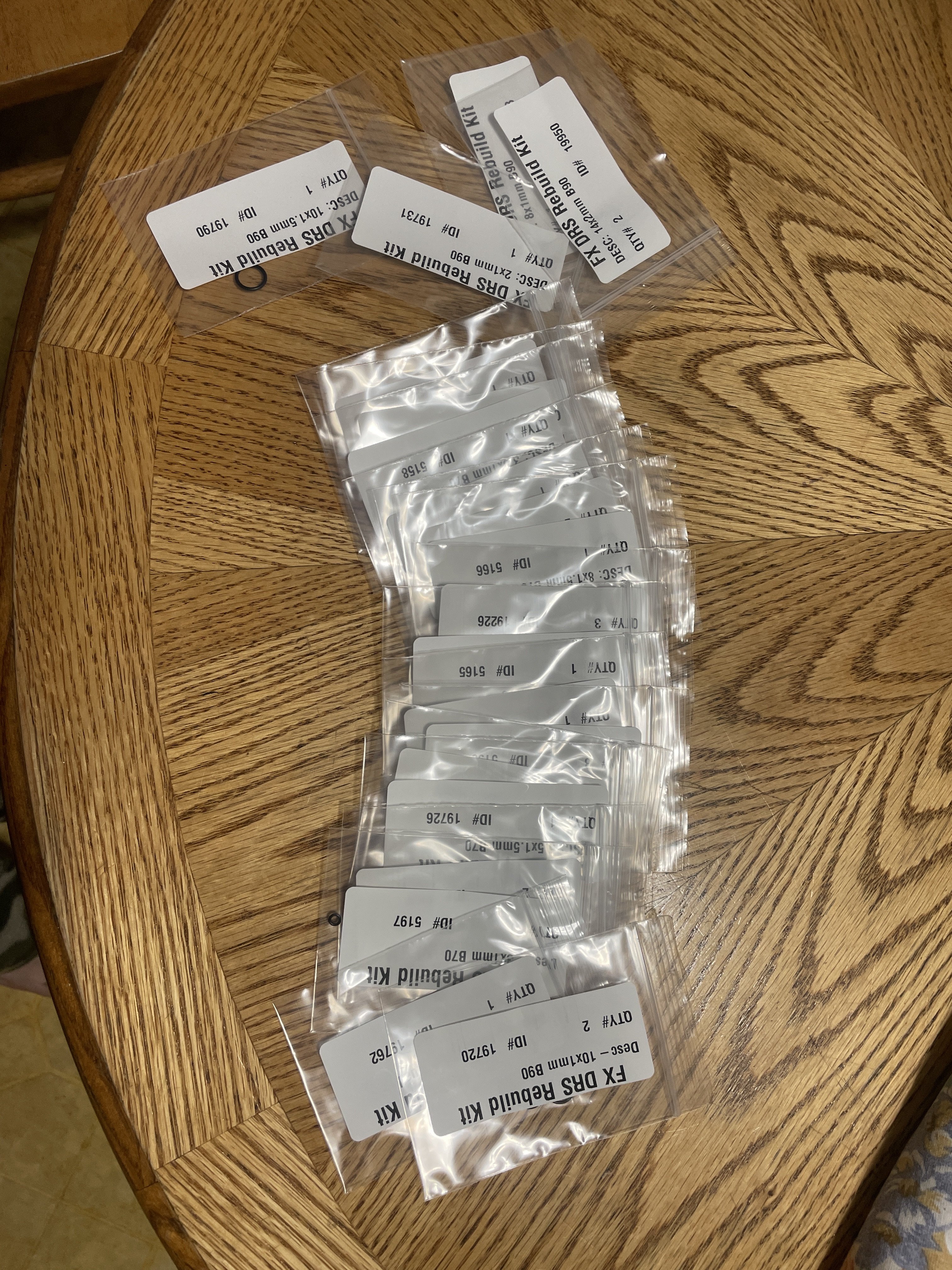

Received my fx drs classic .22 700mm with the shp plenum .
Let’s first say that when this gun is sealed it’s a tack driver not only at 100 but even out to 200 yards !
Unfortunetly 6 out of 10 outings an oring failure has occurred 3 of which has been an oring on the barrel that holds the compressed air in res. To back flow through the transfer port .
Next failures have been one oring between the shp plenum and receiver .
Next failure has been the oring to seal probe inside of transfer port body .
And yet again a oring failure on the amp regulator body .
All these failures appear to be the oring delaminating leaving bits and pieces behind during removal .
So I ask has anyone else ever found a bad batch of orings on a rifle or manufacturer ? If so can anyone point me in the direction of some higher quality orings in the states ?

Well a good days work and a few cuss words and the drs is back to holding air and shooting .. I found several other orings that you could delaminate using fingernail .. I’m guessing I just had a bad batch of rings on this gun . Went on to the tube 100yard range and shot a .565” 5 shot group using griffin boat tail slugs .. she’s back but when will I need to go down this road again .. hopefully next year at the soonest
