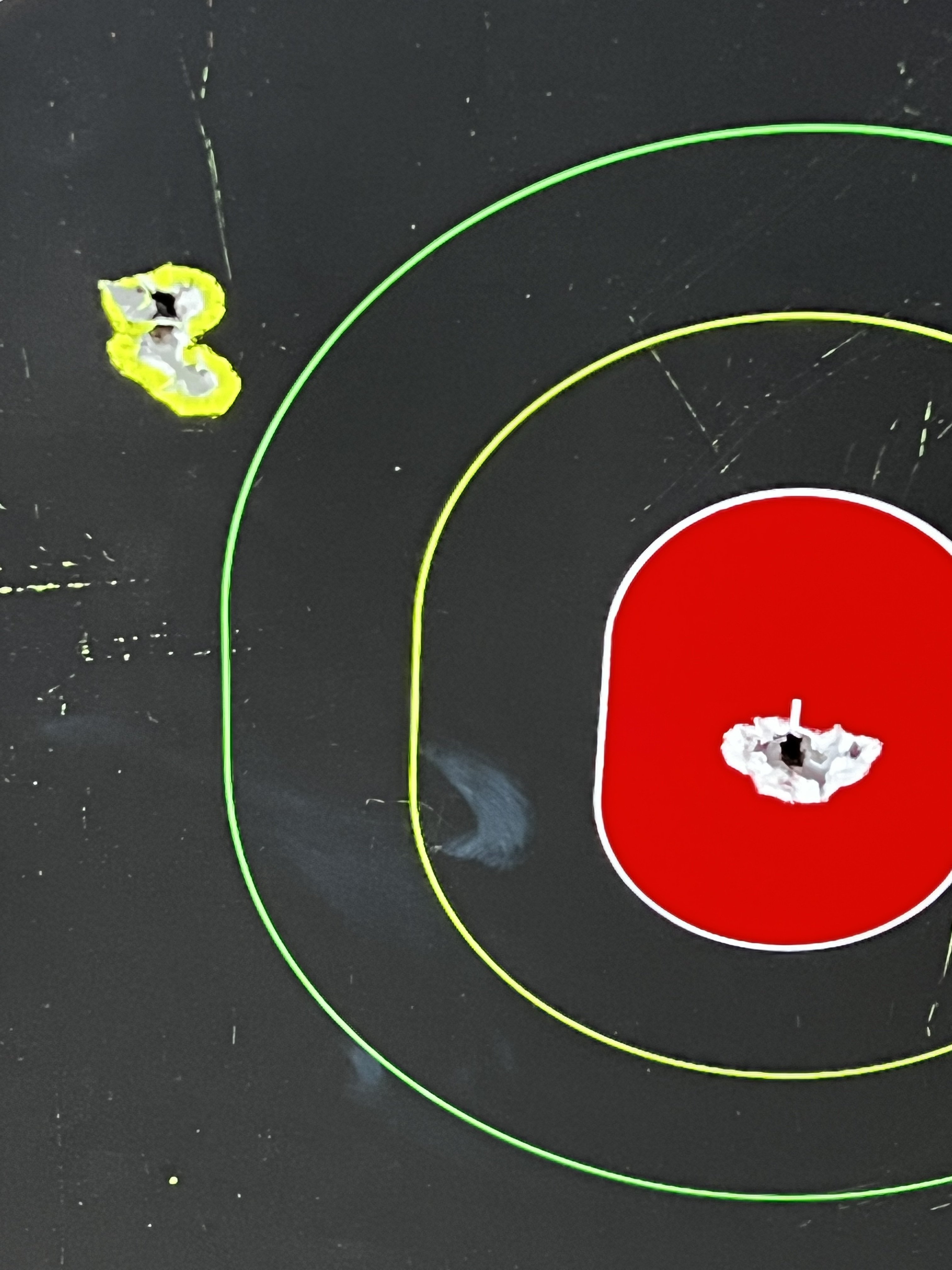

I have the classic with 600mm barrel. I turned up the reg to 145 bar and tuned the HS to shoot the heavy 25 to 28 grn. Pellets. They shoot well enough for hunting but the barrel still likes the lighter pellets like Hades and Predators and 18 grain domes For best ragged hole groups at 40 yards. As advertised it is a pellet hunting rifle in 500 and 600 barrel lengths.
