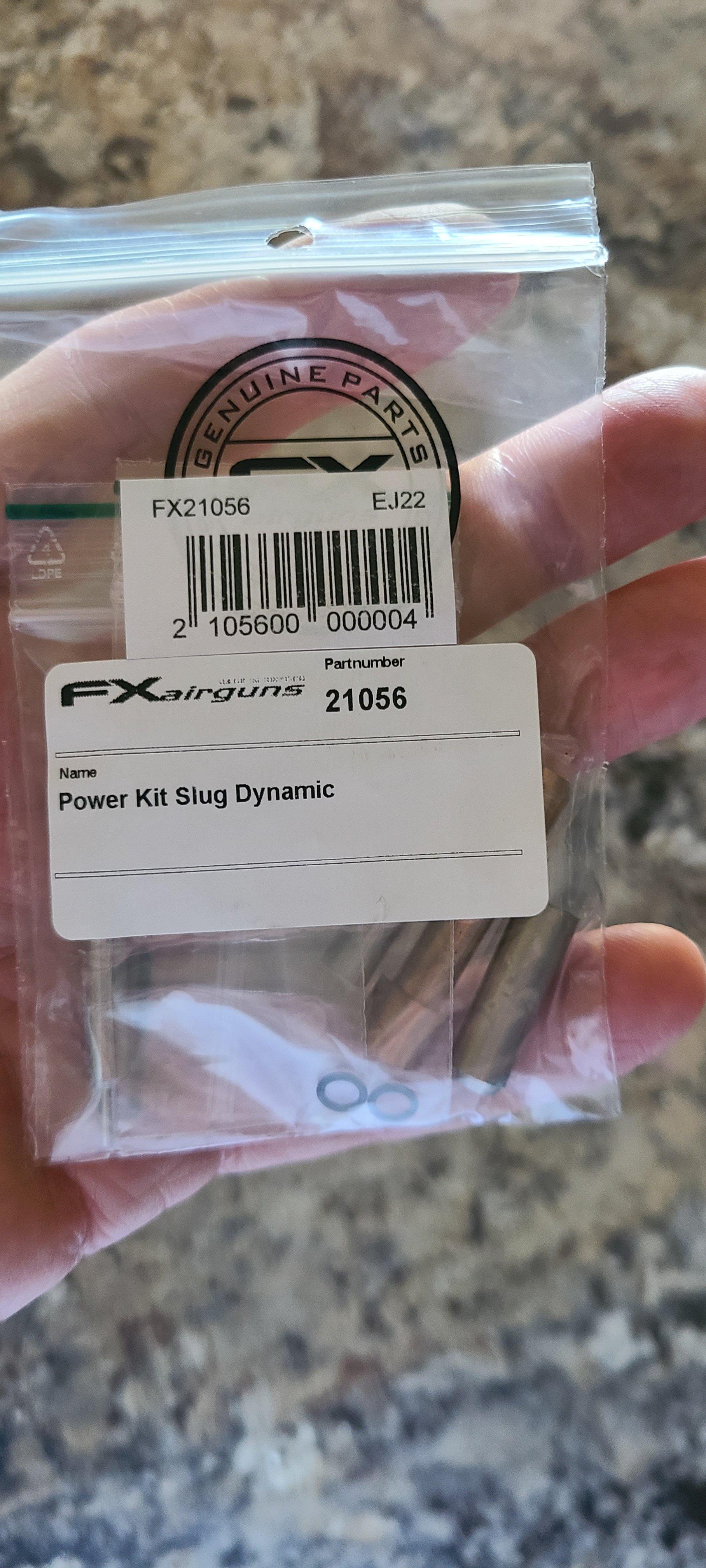

I received my slug power kit from Europe Airguns today and got it installed.

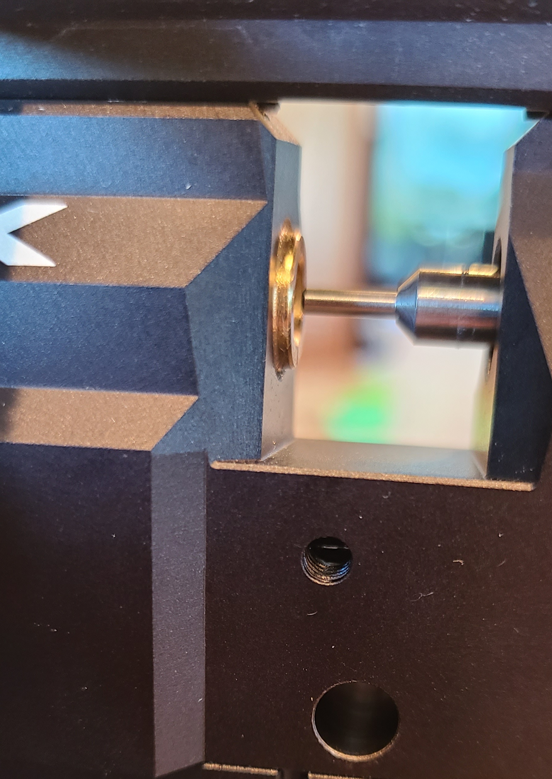

I installed the slug probe 1st without installing the tungsten hammer weight.

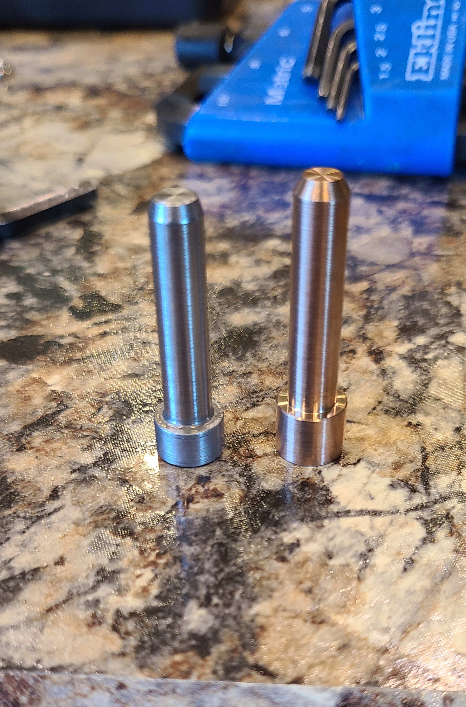

Now for the tungsten hammer weight.
I measured my hammer spring adjustment at 9mm from the back of the receiver. I made a guess to turn it in to 6mm since the head of the tungsten hammer weight is 2mm taller and definitely heavier.

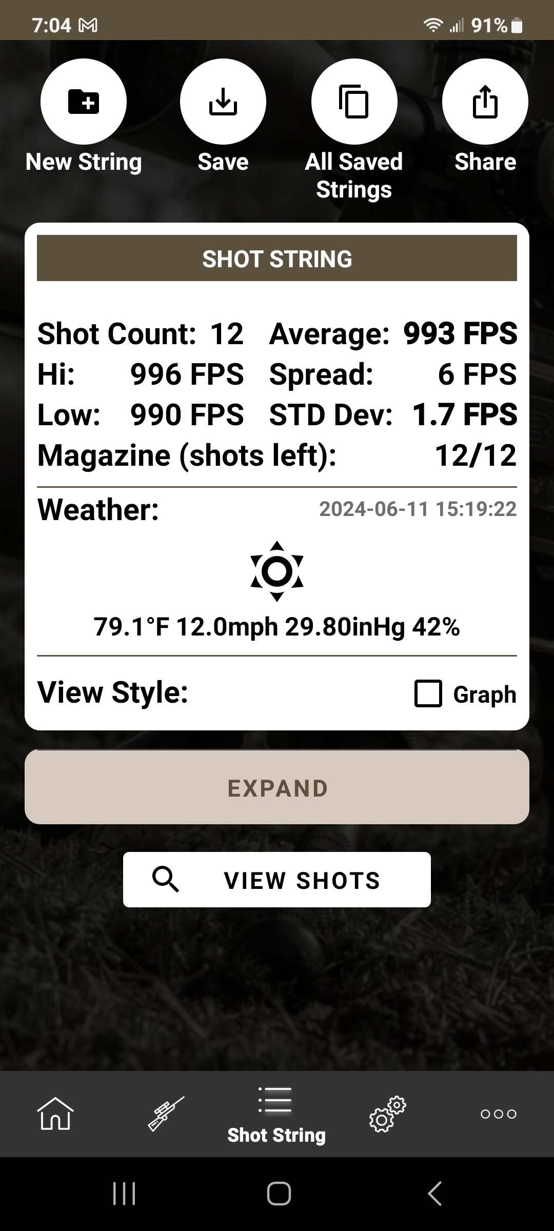

I actually didn't gain any velocity after the installation of the hammer weight my average 1001 fps and extreme spread was 10 fps. So I tried adjusting more tension but speeds got slower so I did ⅛ turn out until I got this 12 shot string
I was running low on air in my SCBA tank so I didn't get to shoot the 38gr again.

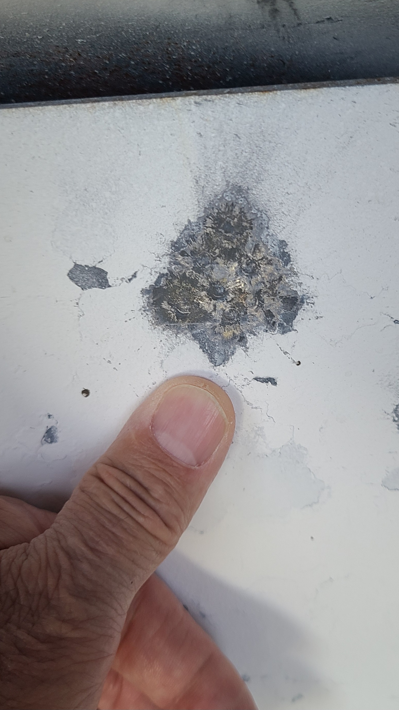

I don't usually like to post groups, but this group goes wth the crony results.
This is shot off of a sandbag no stock at 90 yards. View attachment 471810
Is that a 10 shot group? Looks to be about an inch? That's pretty good!
