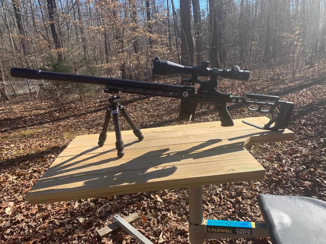

Picked up my DRS Tactical from my good friends at Utah Airguns today. Installed grey Hogue grip, stock, with a folding hinge, and a plenum/regulator gauge. Straight forward easy install of everything. You will need a douty seal for the regulator guage as it seals against the plenum surface. The rail is easy to remove if you need to access the regulator and hammer spring.
Shooting 18gr jsb pellets around 885fps.
