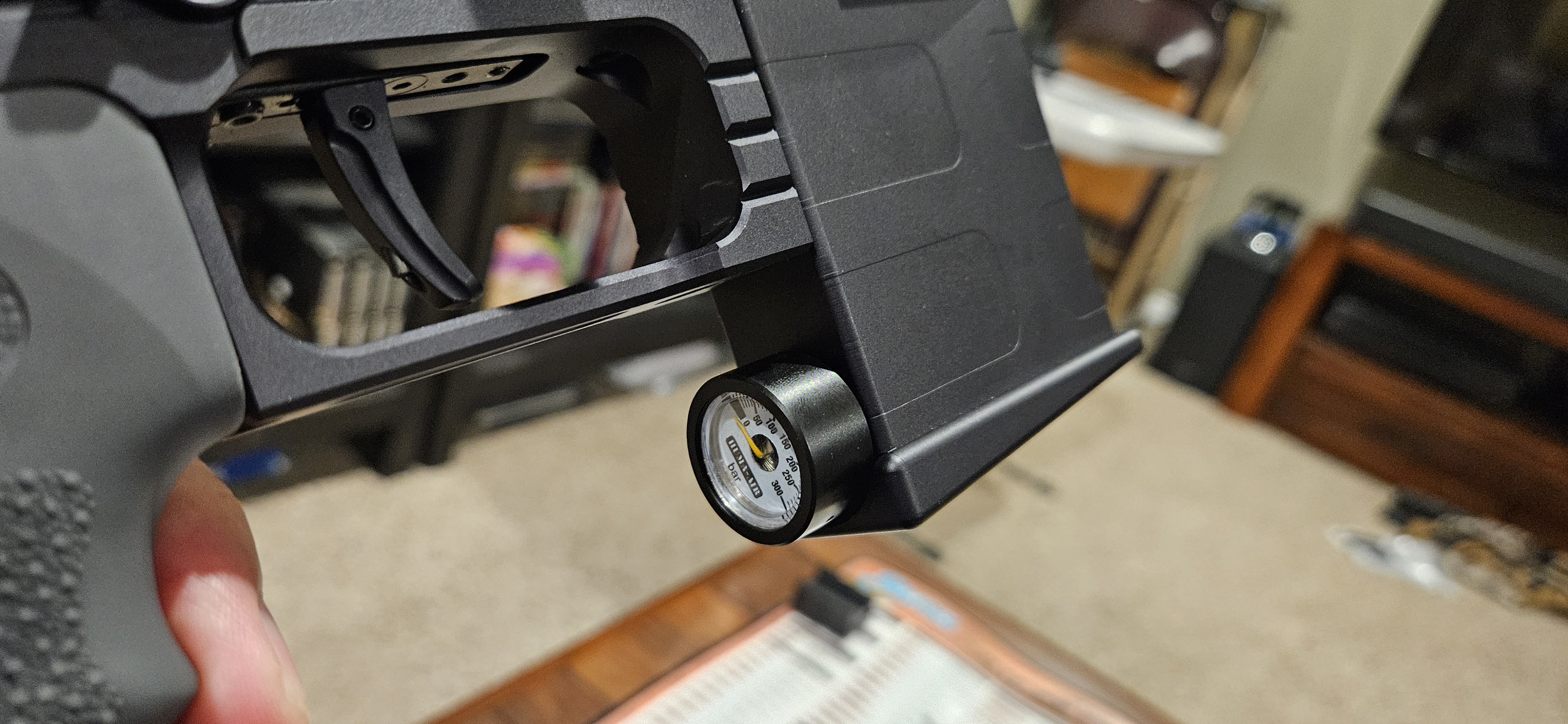

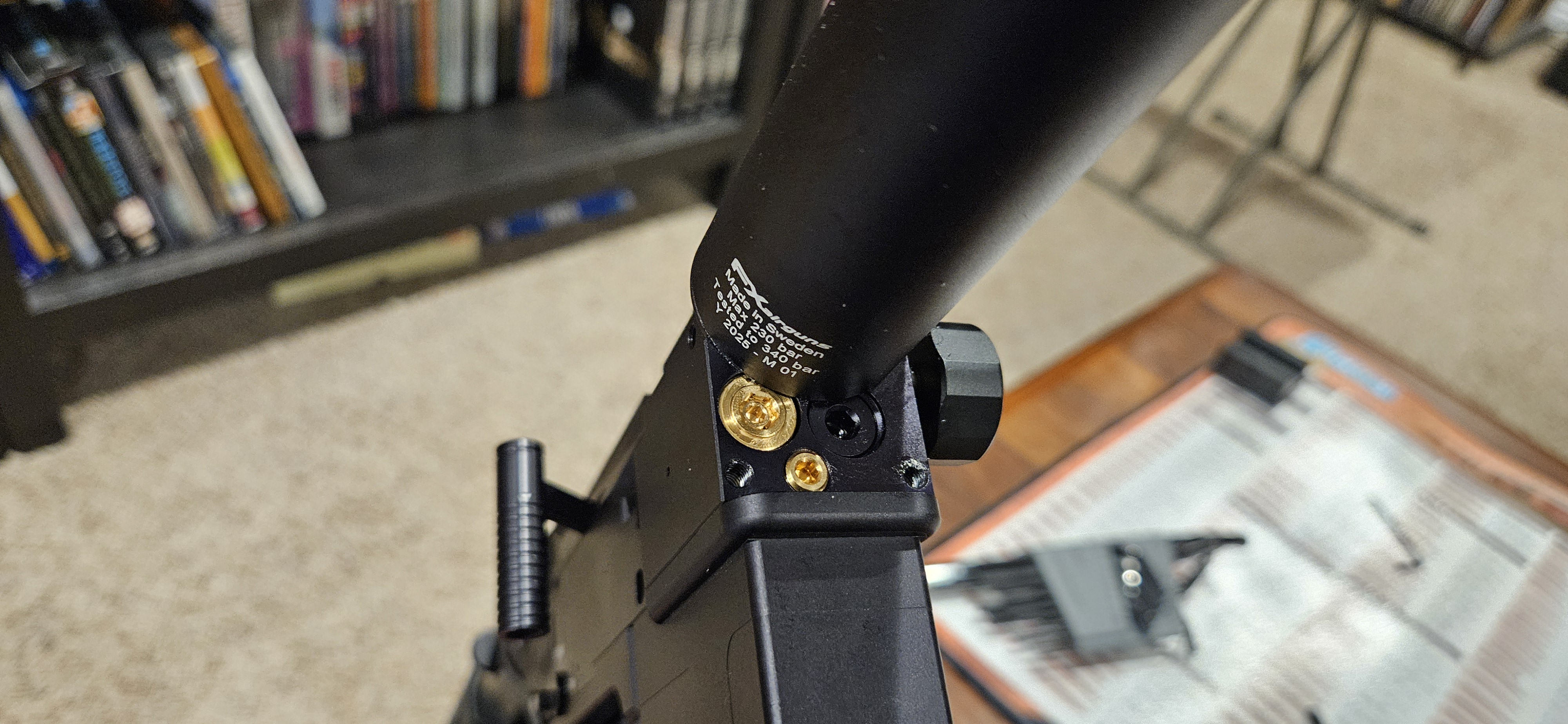

I am considering DRS Tactical, cam you tell me, what did you need o install the additional plenum gauge? I assume it's 1/8 BSP thread gauge, 1/8 dowty seal.
How is the installation itself? Just unscrew the cover and screw on the gauge?
Your exactly correct on all of it. The bleed screw is the small one on the bottom of the plenum.

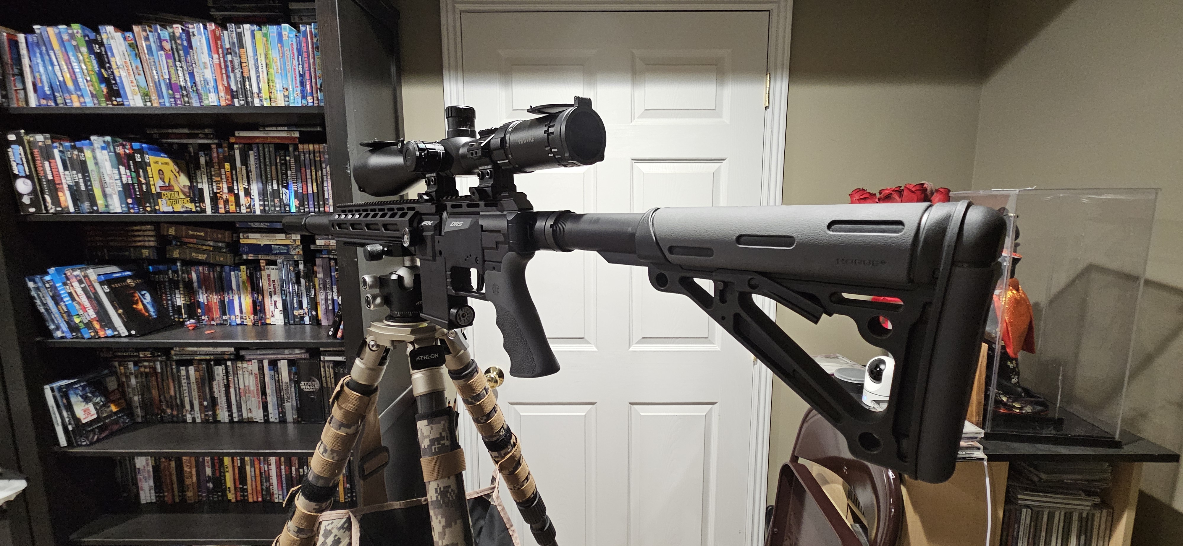

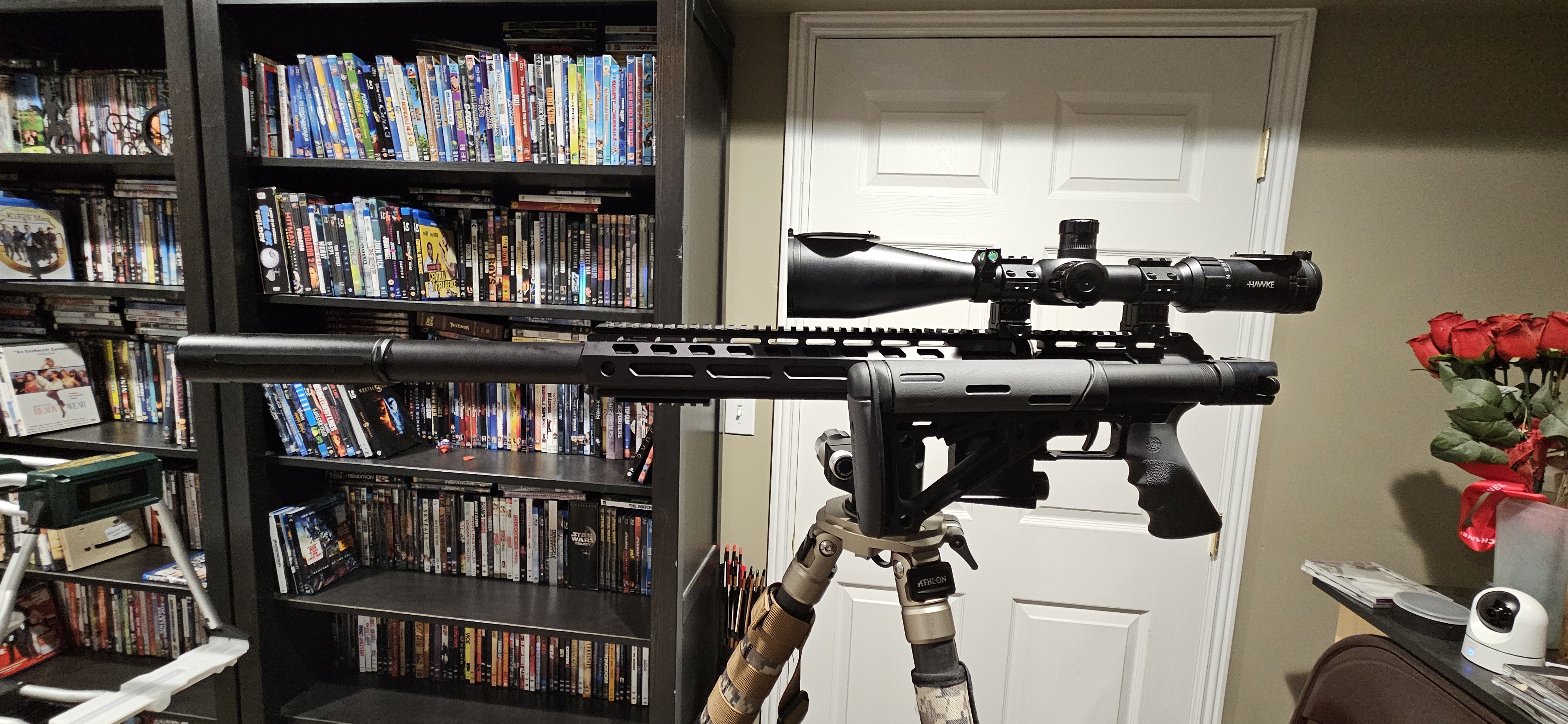

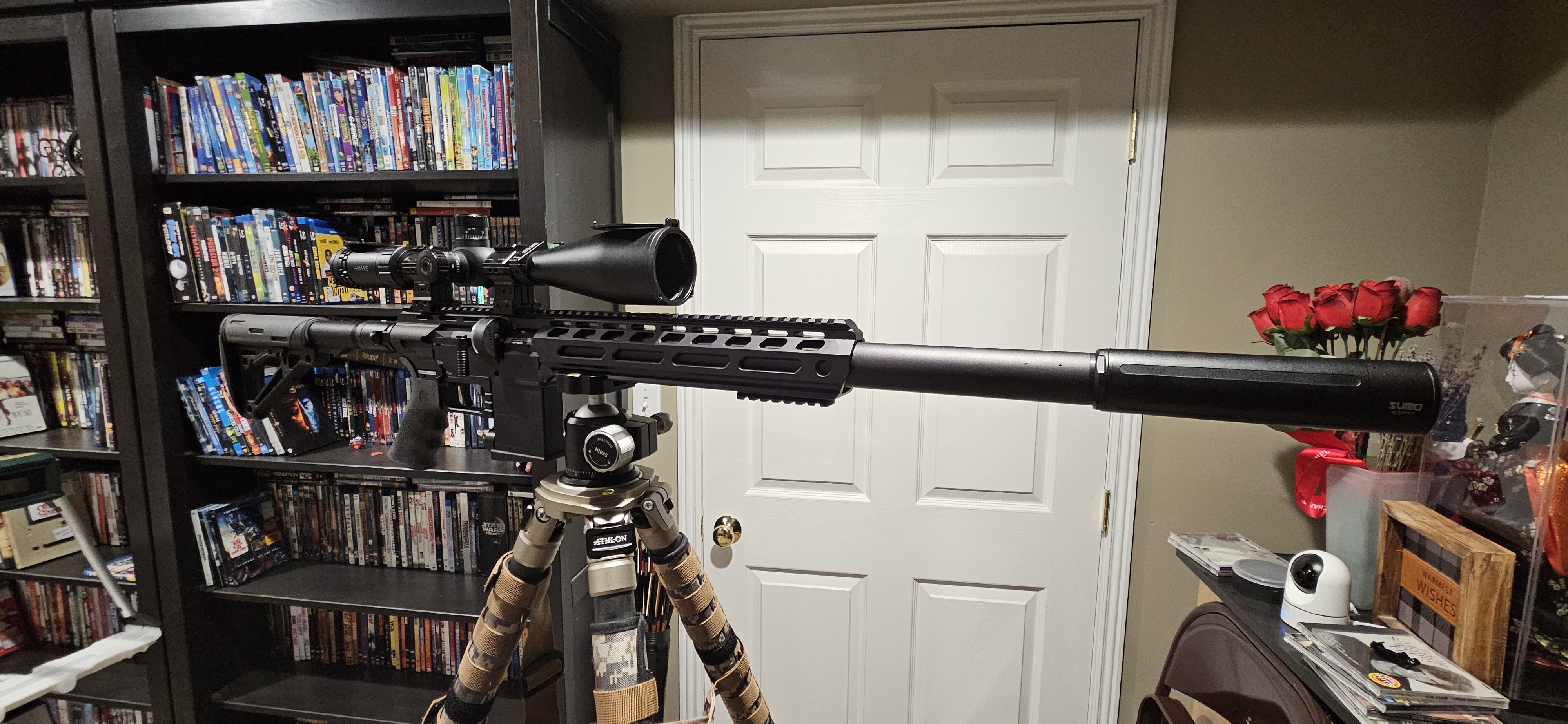

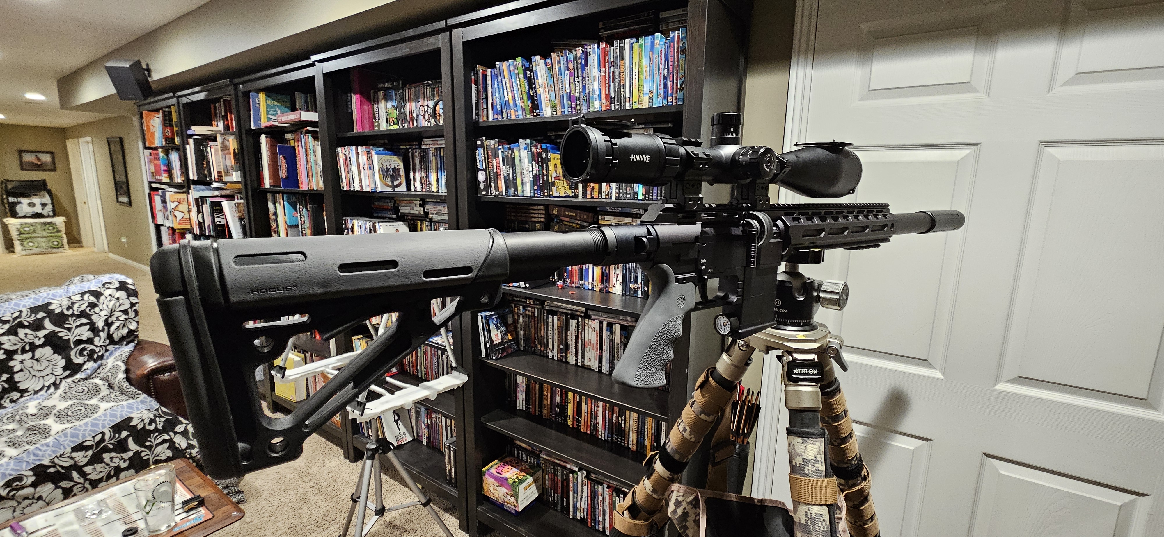

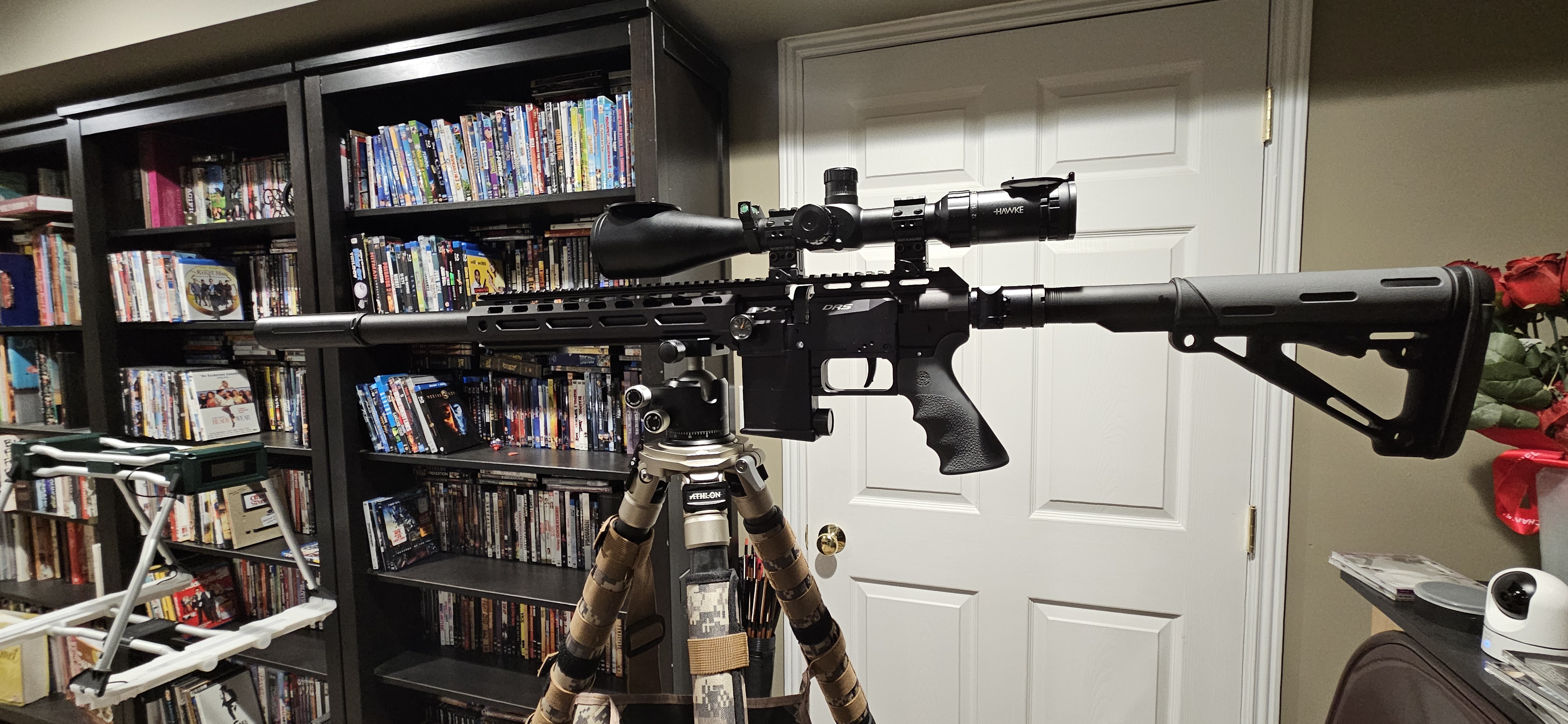

Picked up my DRS Tactical from my good friends at Utah Airguns today. Installed grey Hogue grip, stock, with a folding hinge, and a plenum/regulator gauge. Straight forward easy install of everything. You will need a douty seal for the regulator guage as it seals against the plenum surface. The rail is easy to remove if you need to access the regulator and hammer spring.
Shooting 18gr jsb pellets around 885fps.
looks good, 885 is a great speed for the 18gr. what kind of shot count are you getting?
