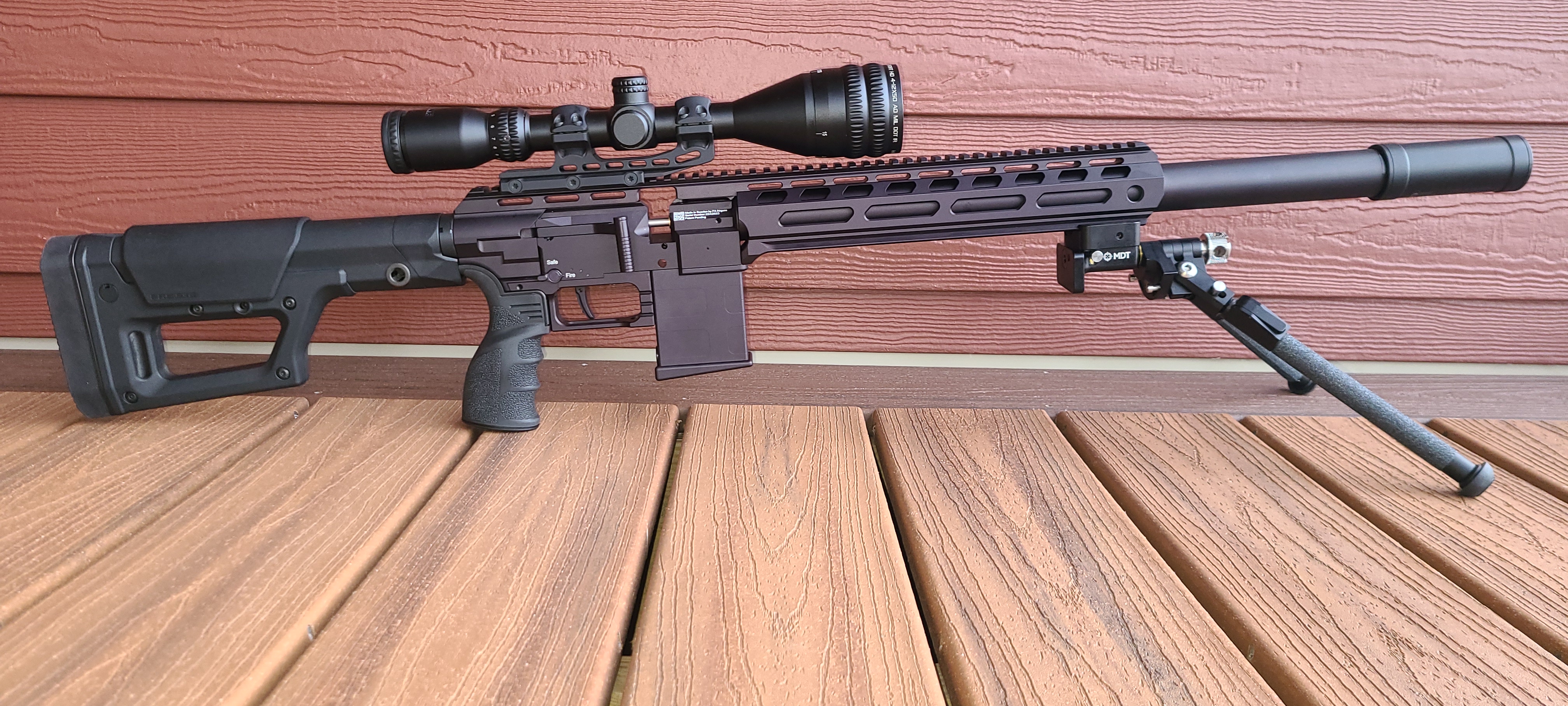

Do you have a pic of your DRST with the FALX?

Sorry I only have this picture with the Pugio.
