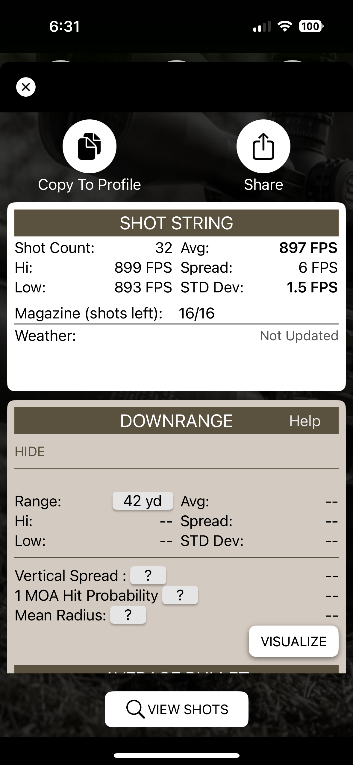

I did my drs t without reg gauge, just upping reg and hammer until fully open valve would give me the speed I want plus some and then dialed the hammer back to go 3-4% below vMax. No idea where the reg is sitting right now (but seems like I am falling off at around 100-105b (.22 600mm). Here’s the result (18gr AEA):
