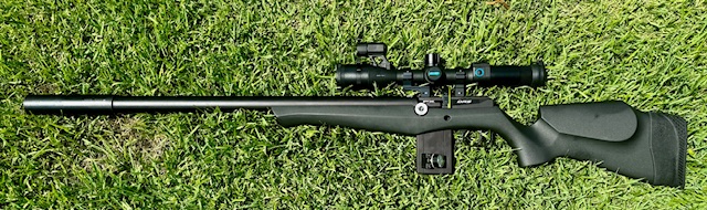

I installed the SHP Plenum this morning and did some testing. Install is pretty straight forward, just degass the gun and the plenum, loosen the 4 bolts on the bottom of the standard plenum, remove it and replace it with the new SHP plenum. No need to even remove the stock!
First thing I did was run a 10 shot string of H&N Barracuda Hunter 18.52 grain pellets through it to stabilize the regulator before I did the base line. As expected, the 1st few shots were low, then it stabilized at an average 913 FPS. Here's the shot stricg:

The slugs picked up an average 106 FPS and the pellets picked up an average 97 FPS. The regulator is sitting at 130 BAR. There was no change to either the regulator or the hammer spring tension, I just swapped the plenum! This increased FPE by about 11 FPE with the pellets and 12 FPE with the slugs. Interestingly, the POI of the FX Hybrid slugs barely changed, maybe a 1/16th of on inch higher, but still grouping extremely well at 35 yards. Fro the time being, I think I'm going to leave it as is. Oh, and I also tried some of the cheap 25 grain Apollo slugs and they grouped almost as good as the Hybrids! They were running about 45 FPE. Just the plenum change really made a pretty significant difference!
After I finished, I topped it off to 230 BAR and let it sit for a couple hors. I did notice when I checked after a couple hours that the regulator pressure had crept up 5 BAR to 135 BAR. I just hope running a few hundred pellets through it will help!

What barrel lenght do you have? is that the 600?

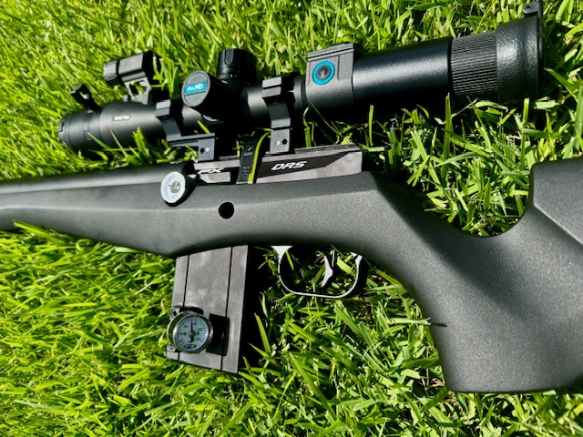

I can get a full 3 magazines, it starts falling off the regulator about half way through the 4th mag. The angled manometer mount is the same as the Impact M3. I'm not sure I'm going to keep it on there, but for now it will stay so I can monitor the regulator pressure.
There is a plug on the bottom of the SHP plenum like the one on the front of the standard plenum, so you can probably mount a gauge facing down on the bottom of the plenum if you don't have the angled mount. The angled mount prevents the ability to remove the stock without removing all the air from the gun and removing the mount.
