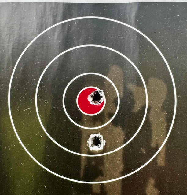

This is exactly what I'm talking about. First shot after sitting over night in the air conditioned comfort of my mancave! Regulator crept from 130 BAR up to 135 BAR.
First shot didn't even register on my FX Chrony, so I have no idea how low the velocity was. The second shot is 970 FPS! The first shot is almost ⅞ of an inch below the second shot at 35 yards. I typically shoot rats at around 50 yards, so the drop would easily put POI at over and inch below POA.

I had already beaten this with a stick with the increase after topping off. I had reached out to HUMA, and this was their reply.
Due to the small piston construction of the fx regulators a little primary pressure dependency is unfortunately not completely avoidable. 3 bar is what can be expected. When well tuned it will not influence muzzle velocity measurable.
Interesting. Well, mine is a 5 BAR creep and apparently it has a pretty significant impact on velocity since it’s too low to even register on the high power setting of the FX Chrony.
I probably should choose a different profile for the first shot to see if it will even capture the velocity of the first shot.
And, apparently it’s not “well tuned” either! o_O
I’m timing how long it takes to creep up to 135 BAR also.
