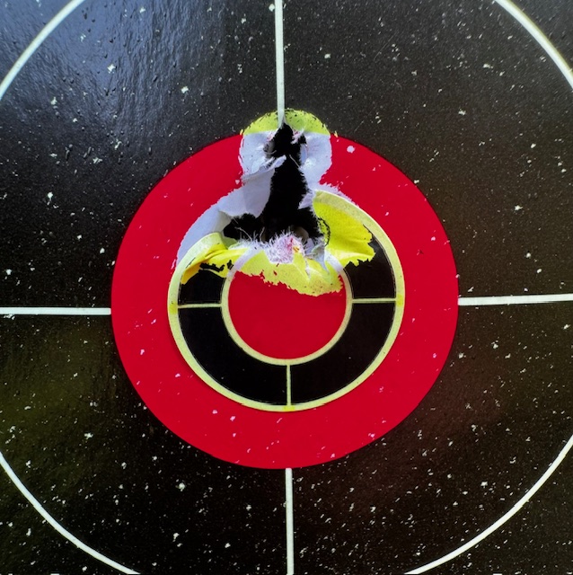

My low velocity first shot seems to be gone! The target below is the 3 shots at 35 yards. The first shot was actually the high POI, the other 2 are shots 2 and 3. I still have reg creep, but this heavier hammer seems to have overcome the problem.
Let us know tomorrow after the gun sits for 24 hours. It sounds to me like your stock hammer wasn’t enough for 130b. Or you never found your plateau speed to begin with and were dilly dallying around too far below it. If you can shave a little weight off that hammer it might give you a nicer operating range with the stock HS screw.
