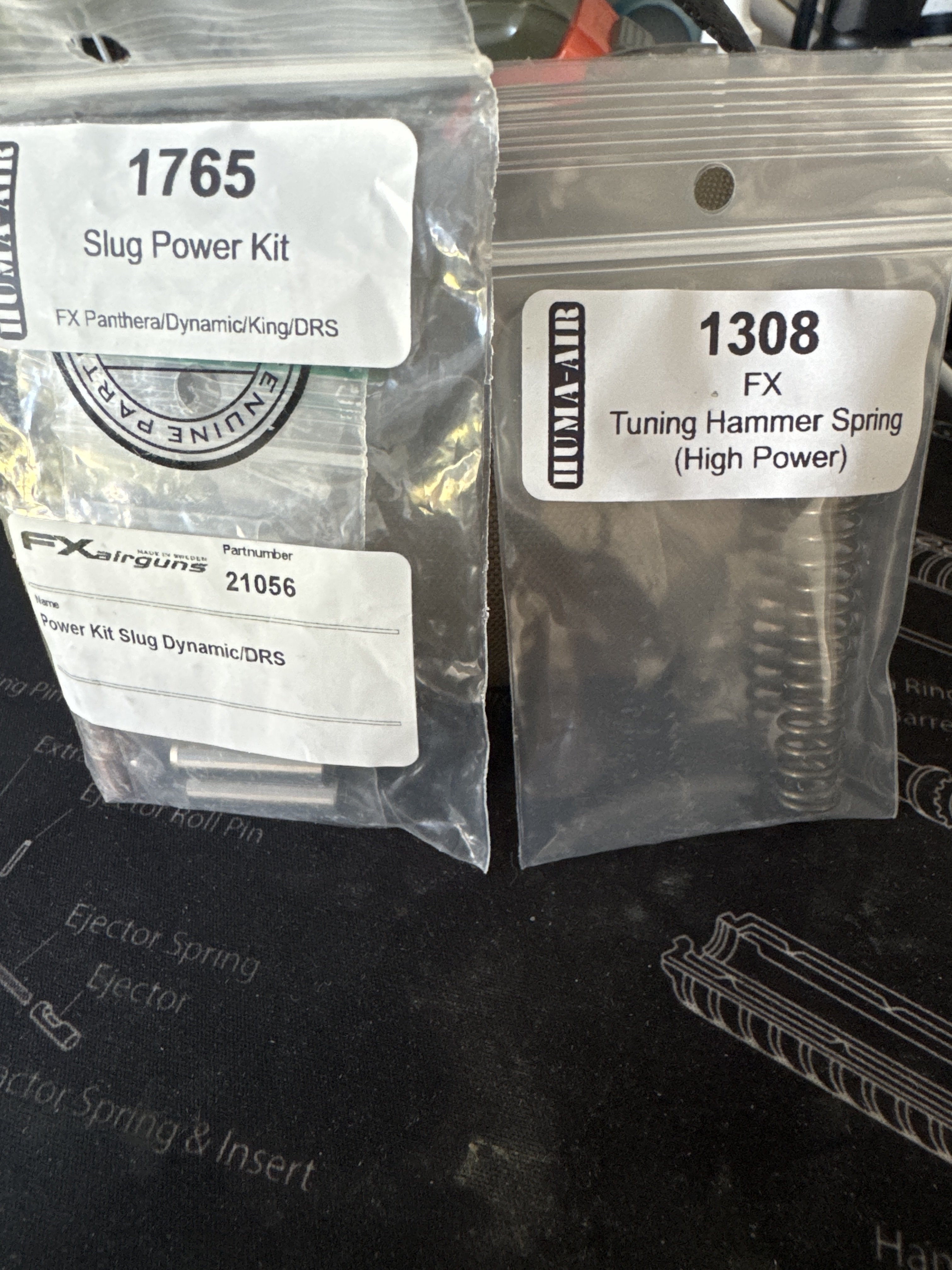

I might install human slug power kit tonight and try free flighting the hammer at the moment I'm running a 14 gram impact hammer and a double spring to help with the preload I'd like to get rid of my double spring one inside the other I'm I. The 160ish area with my reg and my smaller valve stem so I should be able to get what I want for power pretty easily
Hammers are to light for the gun anything 130 bar plus you need a heavier hammer
