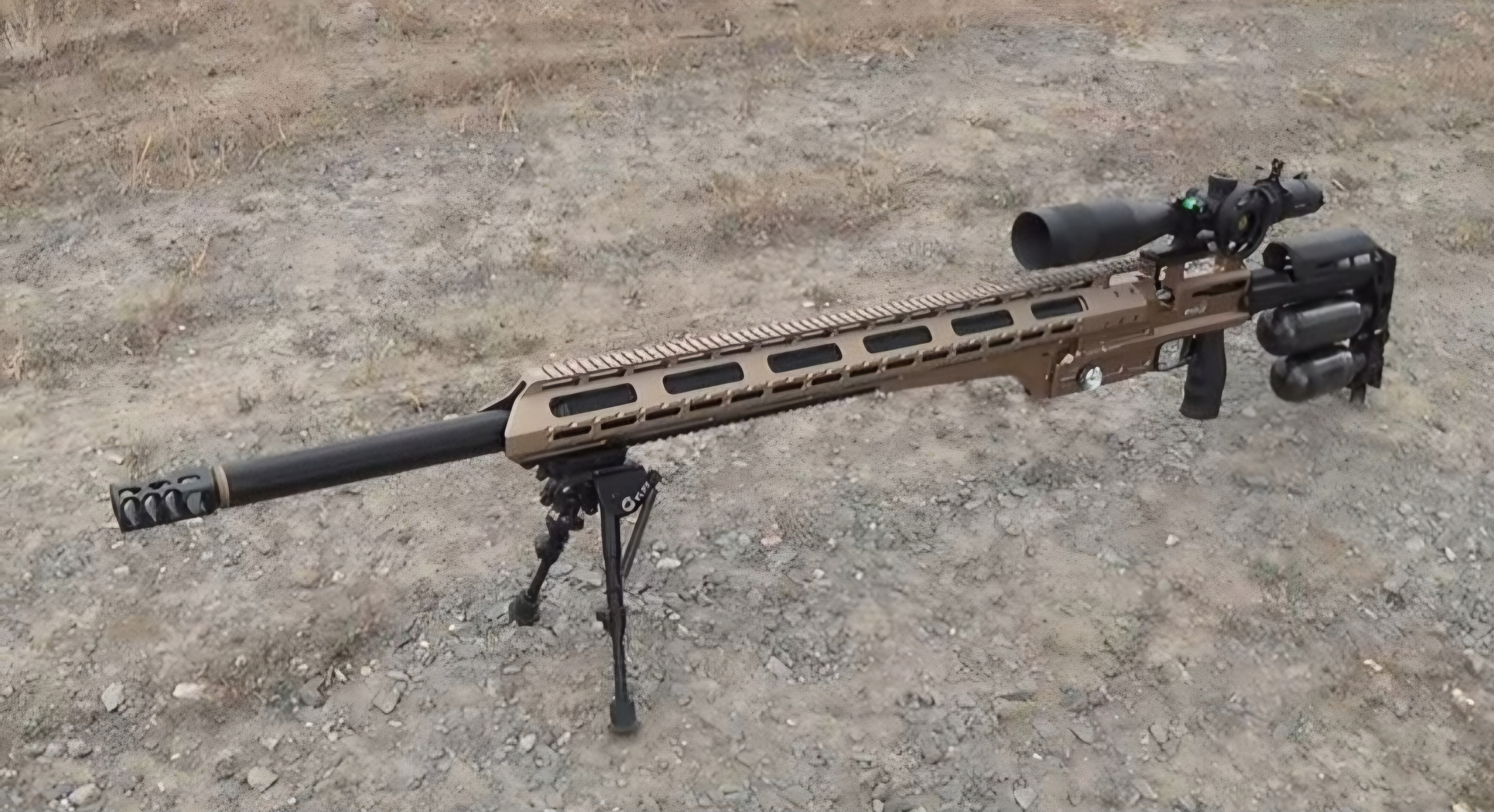

This ir the new AEA long range pcp .. it will come in .357 .. barrel length is 38" so it should do all the power need it .. and is regulated to .. I really hope they started to use the direccións that Donny give them in the red Panda . And this gun get to be flawless . Or as trouble free as possible.
