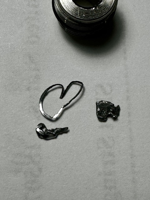

I ordered aa .30 Cal 600mm barrel kit for my new M4. It arrived on Friday and I tested it out yesterday. I was shocked when I couldn't even hit a 12 x 18 target at 35 yards! When I went to clean the barrel, thinking maybe that was the issue, I had a hard time getting the patch worm to feed through the barrel when inserted from the breach end. I removed the moderator adapter and this is what fell out of the end of the barrel.

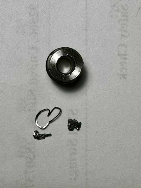

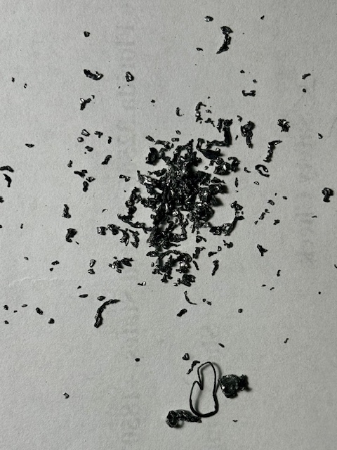

I was shooting the 44 grain JSB Hades pellets and noticed what appeared to be fragments of pellets hitting the target. I then removed the adapter again and this is what fell out of the end of the barrel.
I called the Vendor I purchased it from and after discussing various possibilities, he had me remove the adapter and shoot it again, it stacked pellets at 10 yards. So we measured the ID of the adapter and it was only 6.2mm! Seems FX made a major Faux Pas during assembly and put the wrong adapter on this barrel and it was literally shredding the pellets! A .25 cal pellet is 6.35 in diameter and a .30 cal pellet is 7.35mm, so I can only assume this adapter was probably meant to go on a .22 caliber barrel. In any event, the Vendor is contacting FX and sending me the correct adapter. The Vendor said they don't typically open and inspect barrel kits before shipping them to customers. He said this was the first time he had ever encountered this and was really surprised. So, just an FYI, if you get an FX Barrel that's shooting a shotgun pattern at 10 yards, check to ensure the correct adapter was installed at the factory!
