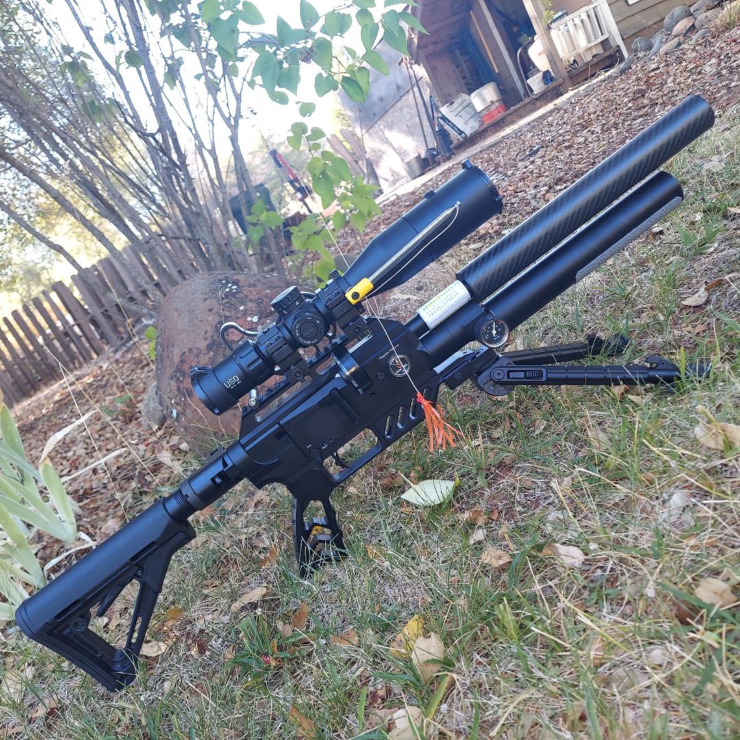

FX Dreamline with Maverick dual reg system and plenum. Shooting 20gr ZAN slugs @~960fps. First reg at 170bar, 2nd reg at 130bar. 600mm STX Superior Heavy liner.

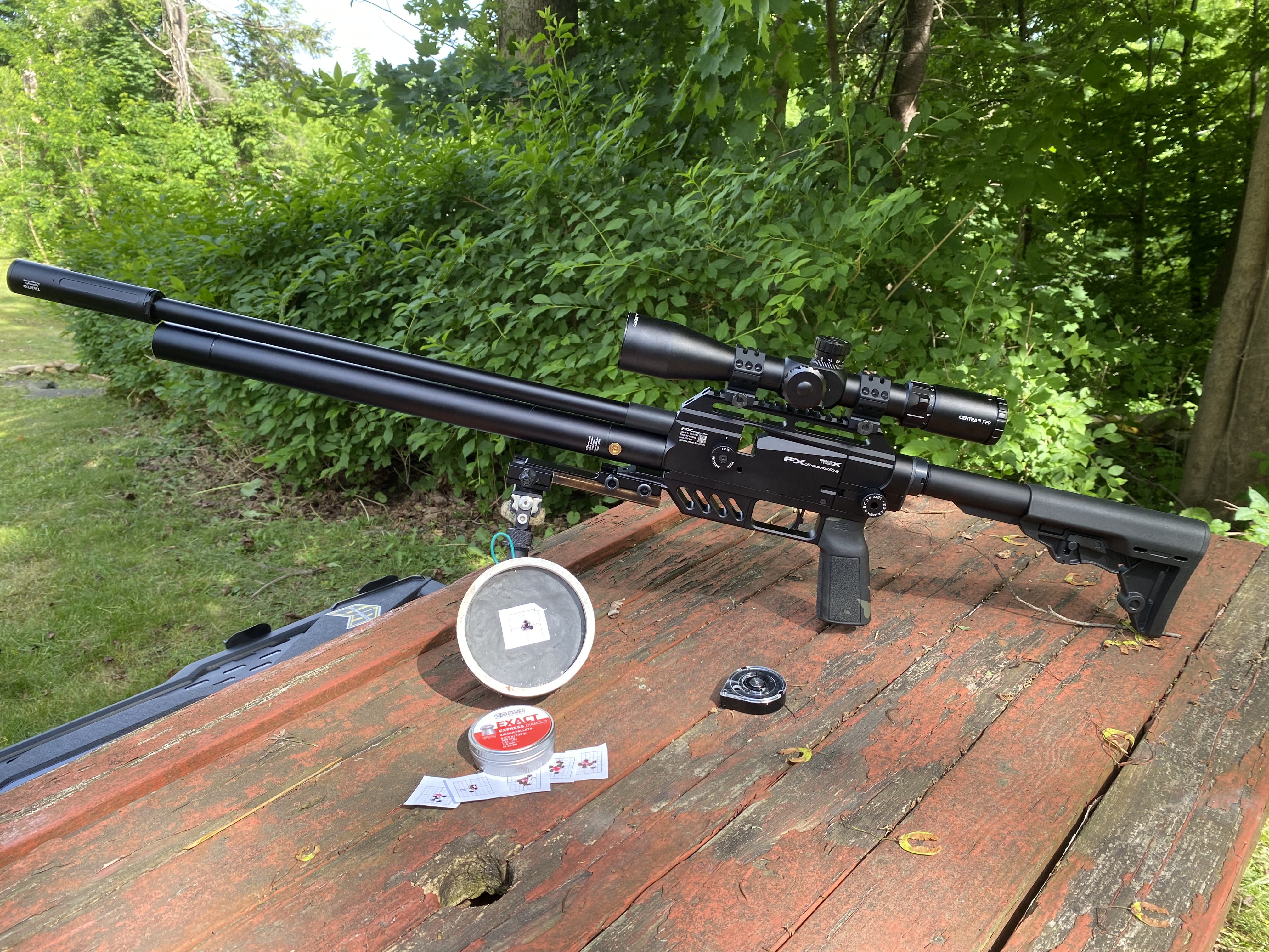

I've got a .177 Dreamtac (standard, full tube, not bottle or compact) with a 500mm Superior liner. I run 7.3, 7.8, 8.4 and 10.34 JSBs on a 100 bar reg. By varying the TP and hammer wheel, I can use the light stuff in the basement for offhand trigger time during the winter. Turn it up with Heavies for pesting or hunting. I've been pleasantly surprised with more than acceptable accuracy from each of the above pellets at appropriate power levels.
The Dreamtac is a very light gun and I found that it started to feel very harsh trying to get 16gr Beasts or even 10gr K.O. slugs to run fast enough to be useful, so I can't comment on those. I leave the heavy stuff (13gr and up) for the unregulated Mrod and limit the Dreamtac to lighter pellets. I've written off slugs in my rifles, as I really don't have the range available to justify the effort or the expense.

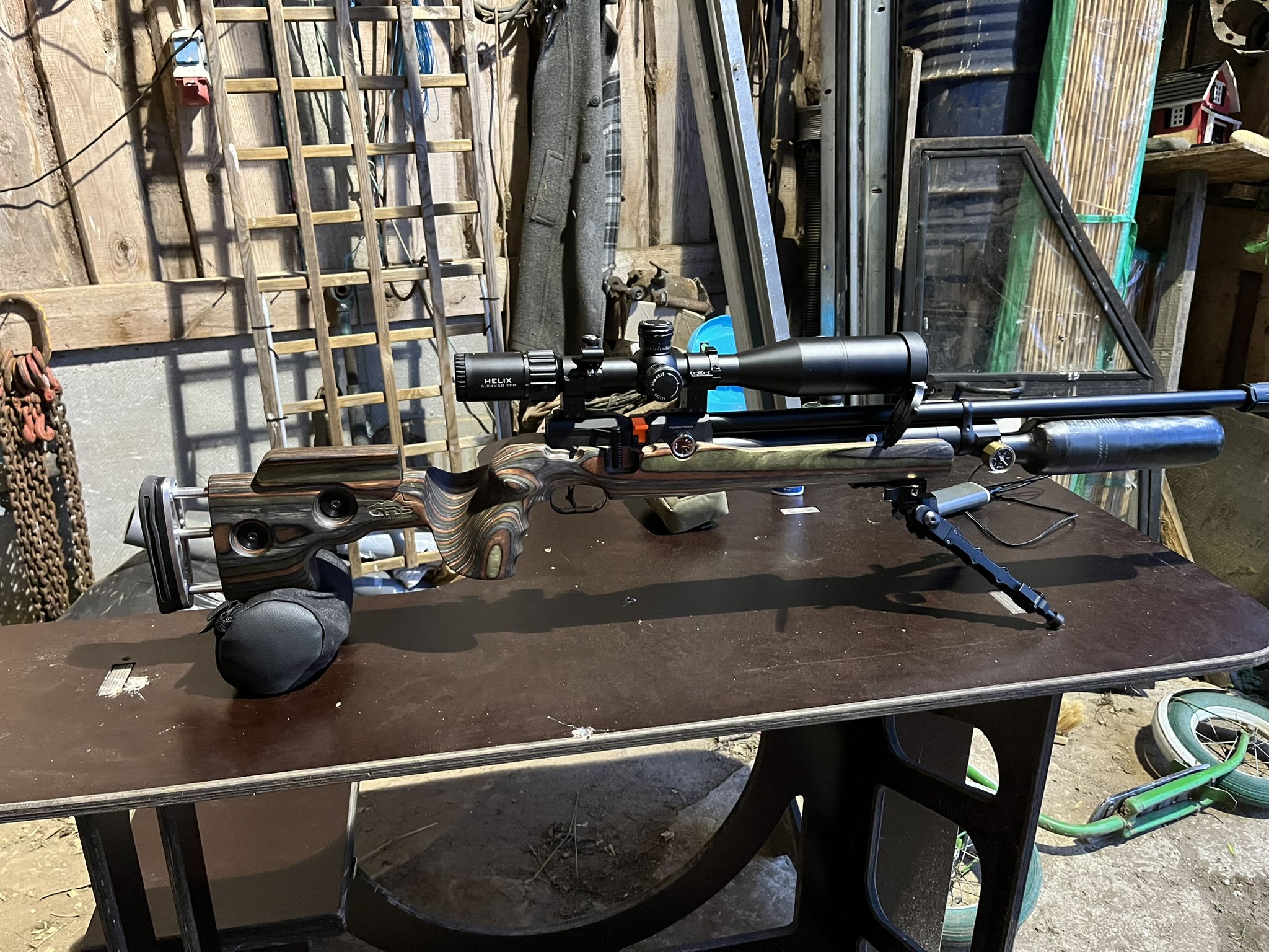

Not for me, i recently put a standard 600 mm barrel on my Maverick, assuming it would then be my pesting rifle shooting those Mk3 slugs, but at least in a cold Danish winter day i was not able to get them to fly right, and in the end i had to abort and dial for pellets to be ready for when the sun fell below the horizon.
Sadly i can not put my 700 mm barrels back CUZ i cut 100 mm of both of those, and i have not bothered working on the crown of those.
In my CZ barrel epic Two they are like lasers. so ATM i just swap scopes when it get dark.
This also fine for sitting in the shed at a bench shooting rats, but otherwise a 700 mm barrel Two is not a rifle i would like to carry around, for damn sure would need to be mounted on a tripod.
