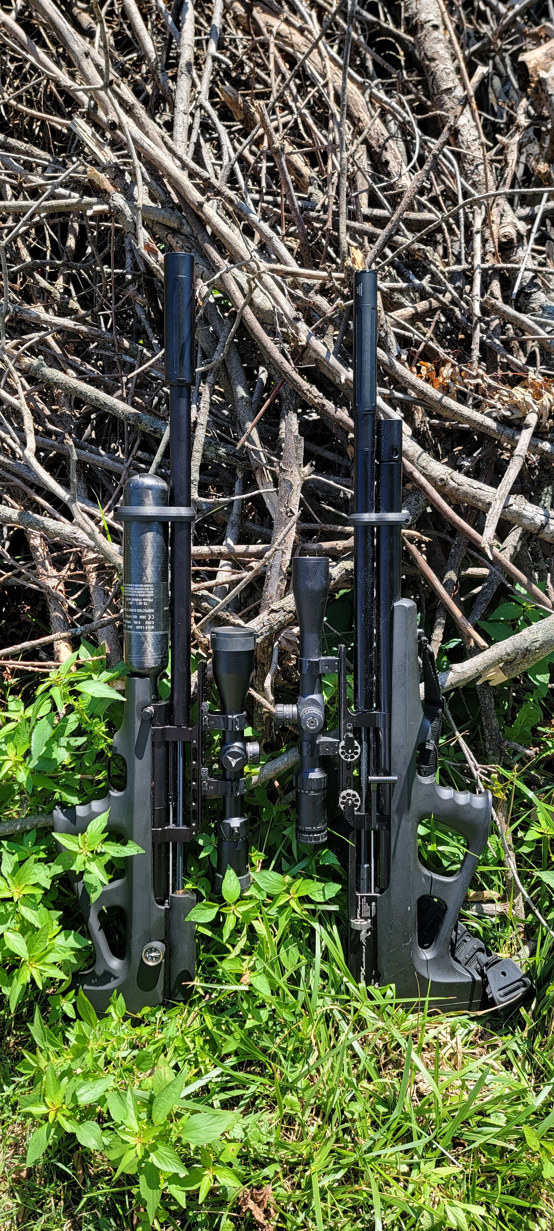

Impacts 500mm/700mm needed CF Sleeves and Tensioners, one of them still needs to be re-zeroed occasionally.
Wildcat 500mm needed a Barrel Band, but was the best out of our bunch to begin with.
Maverick 700mm, I need to do more testing but it will likely need all three upgrades.

Barrel bands on both no more problem with poi
Well, that is not always true. I am a great believer in barrel bands, at least the good ones. They absolutely help. No question, but they do shift a bit when bumped. Barrel bands are a Band-Aid, not a fix.
