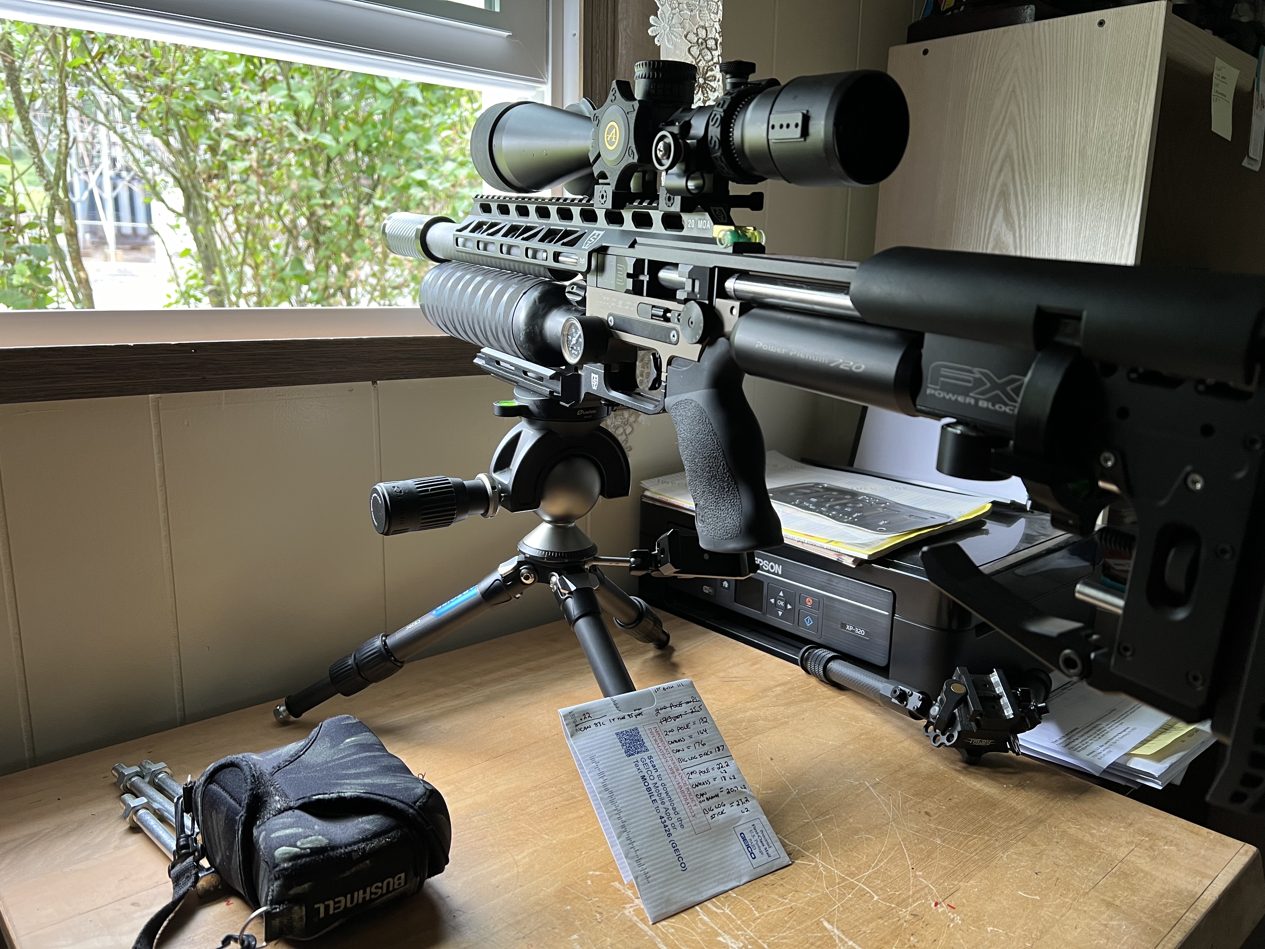

While I may come across in some topics as being harsh on FX, I still own them. But I know what they are. Or in the case of my DRS, learned what it most likely is. The guts of an Impact offer me what I need for certain things. And this is one of the few bullpup platforms that totally agrees with me for long range shooting in a hunting platform, not a goose gun. I choose to put in the work machining and blueprinting to make the gun consistent. But I also sympathize with guys who drop big coin and think the gun should be more firearm like. The whole time I’ve been participating in this topic, I’ve been stuck in the house on a rainy day picking off sparrows and starlings. My closest shot today was 111 yards, farthest was 174. Haven’t checked the zero on this gun in over a month. And this gun is the dreaded .25. It can be done. But it’s a hobby within a hobby.

No neighbors in that direction for about mile or so. What’s out that window is a substation and 300 yards of power line. But I can’t shoot to the last pole because the power line runs up a hill. My trajectory has my slugs smack a cross beam in the substation. So from this window I’m limited to right around 200 yards. When I want to shoot further, I have to do it from the bench beside my house. I can do 220 yards out of my dining room window and that’s where I normally shoot and test. But today the power line was active with starlings. Which I haven’t seen in a while.
