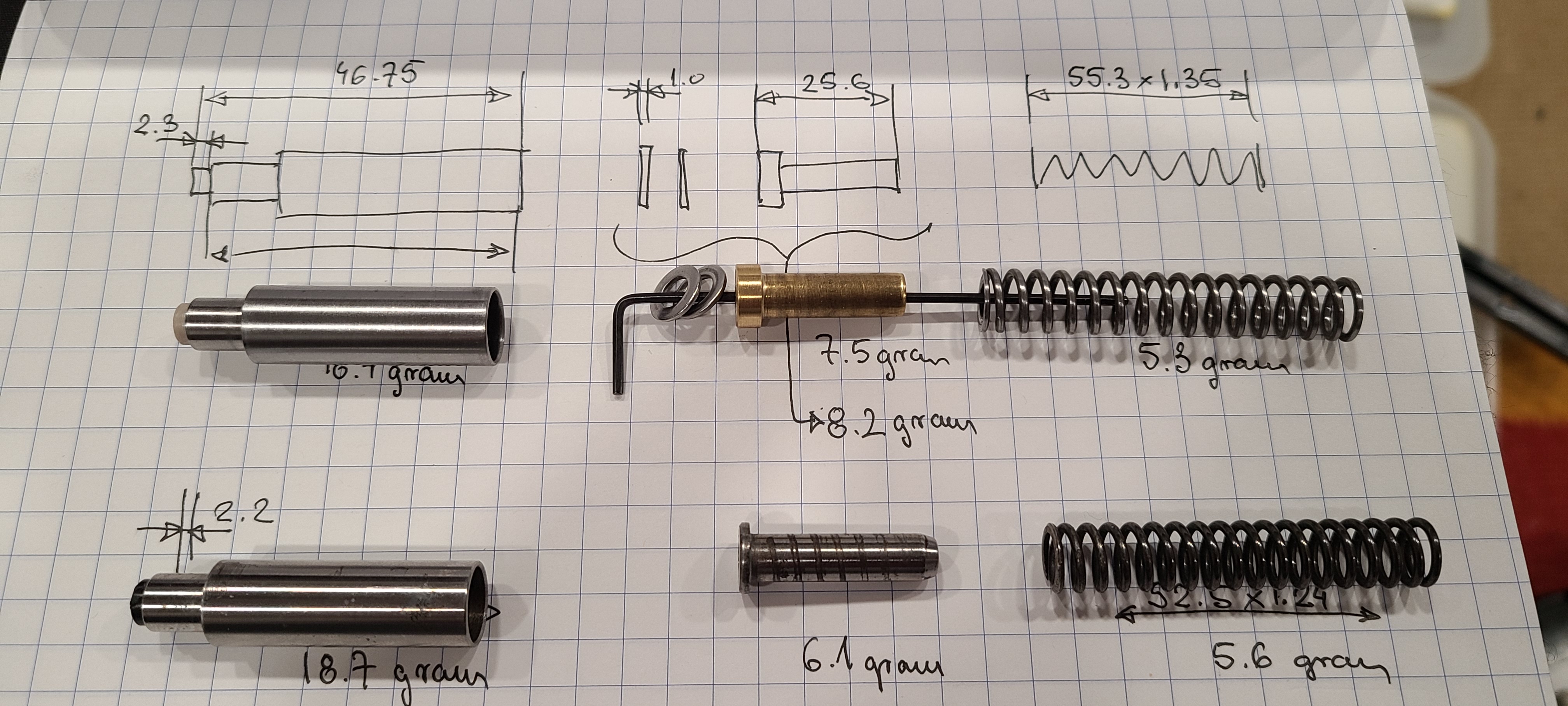

I was unable to find a posting on actual weight in grams for various FX hammer weights so I thought I'd post the findings of the weights that I have accumulated over the last few years to help with anyone working on their gun so they don't waste money buying multiples of the same weights while tuning. The factory weights are from a Crown and Dreamline but are also used in the Wildcat and Maverick.

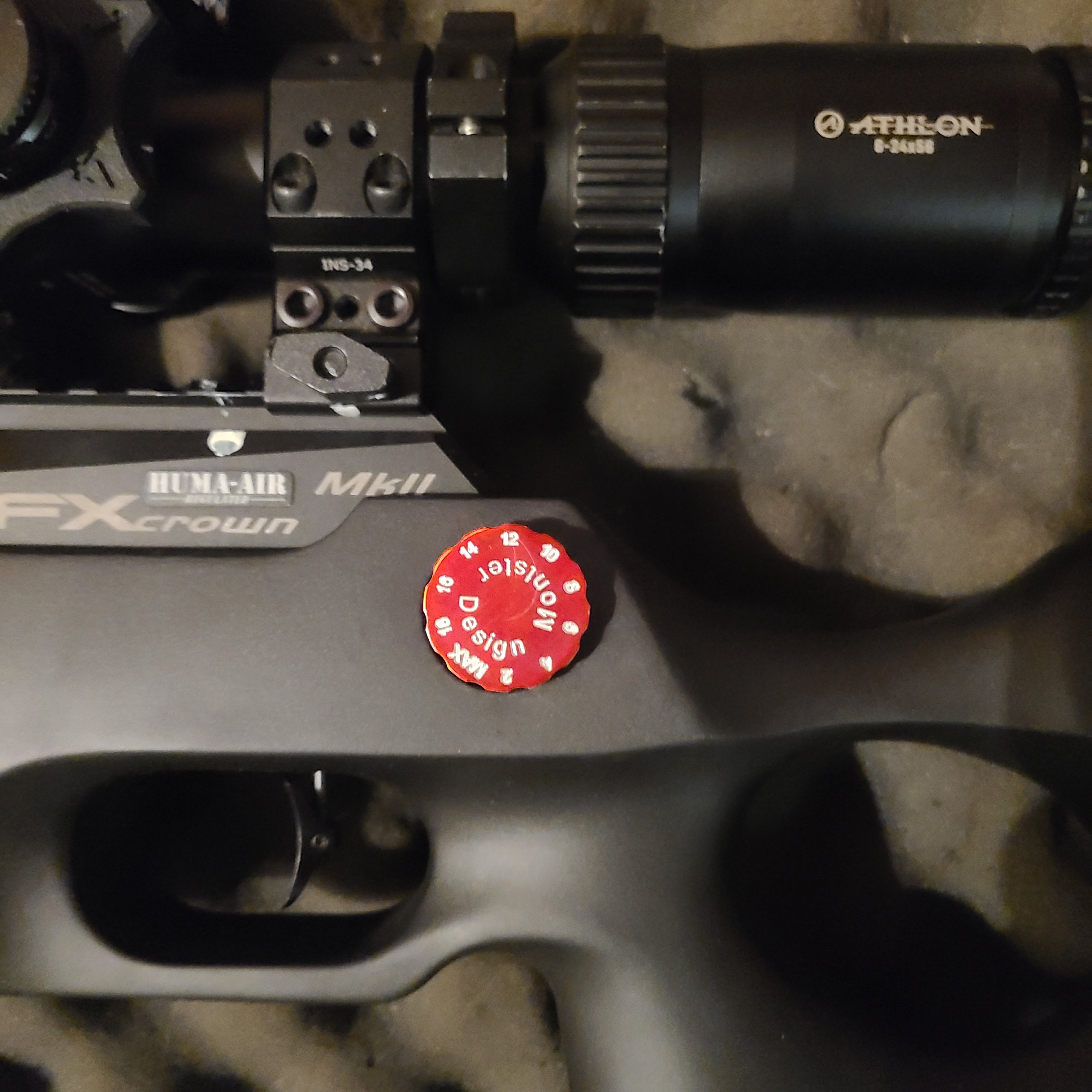

Here's one of Mont's power wheels. 20 points of adjustment. The hammer spring adjuster is stainless which is beneath the red over wheel. Right now it's sitting on 12 . Shooting 33 gr Zan at 960, loads of room to go up or down if necessary.
