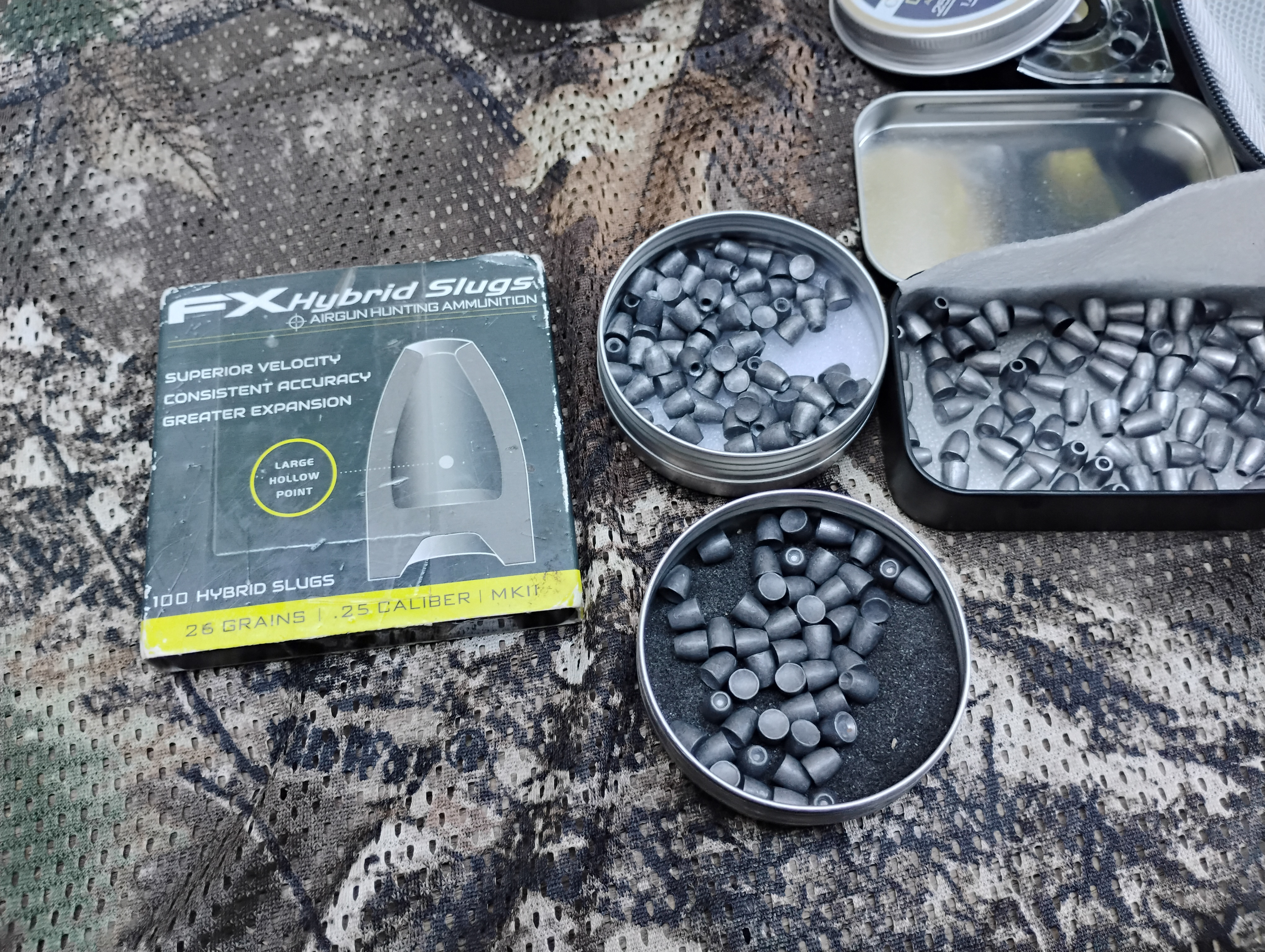

The FX hybrids are actually from Rocky Mountain Reloading, you can buy in bulk from them. I've had batches that were pretty clean and others that were disgusting. That said, they are pretty much the only ones that I can get to work. I just have a little ultrasonic cleaner, I use denatured alcohol to shake most of the garbage off, then bees wax them. I'll have to give the owner a call and ask what's happening, he does shoot airguns, a nice guy.

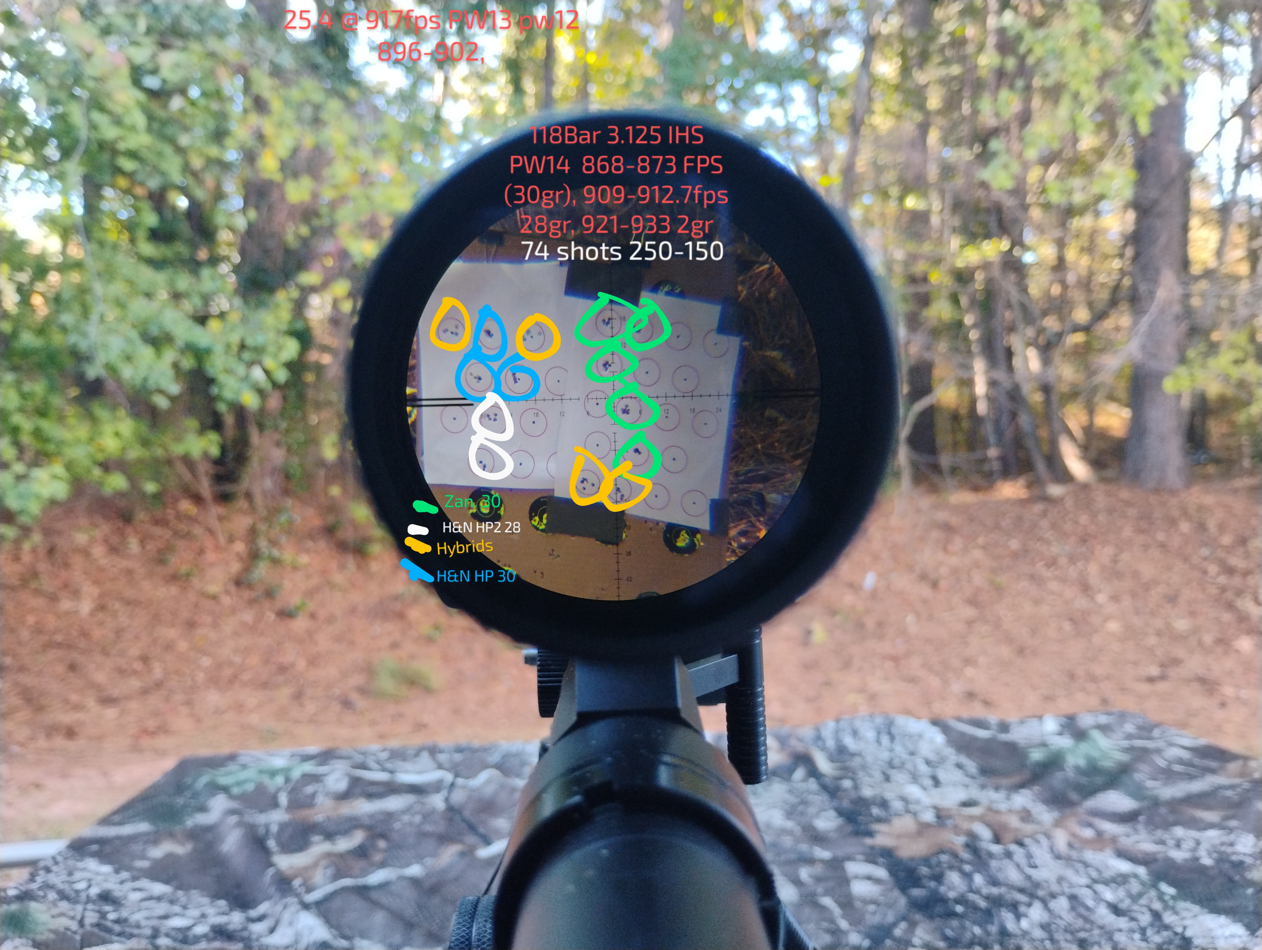

I don't know what Im doing wrong with hybrids. Fast or slow they just don't hold tight like the Zan's or H&N for me. I'm doing 35y tune tests for 30gr right now. I just put 3 groups on paper of zan and hp that rival the best performance I get with FX King 25.4/aea 25.39 my hybrid groups look like I'm pattering buckshot.

My hybrids didn't have any flaking, however... I made the mistake of keeping them in my garage for over a year. They oxidized pretty quickly. I assume that's why ZAN changed from a moisture collecting cardboard sleeve to foil sealed packaging.
I was shocked and sad to see all the oxidation. I didn't want them to go to waste so I cleaned them in a sonic cleaner with 50% water / 50% vinegar. It removed the oxidation real quick, but then I had to re-lube them with a shot of Gunzilla, and store them in an air tight metal tin. Not an ideal situation, but at least they didn't go to waste!
FWIW - I cleaned 2000 rounds in a matter of minutes and had very little metal flakes in the bottom of the sonic cleaner. When did you purchase these?
Would you recommend using sonic cleaners as a good way to safely clean the slugs? By safe I mean in a way that won't damage the slugs or the machine.
